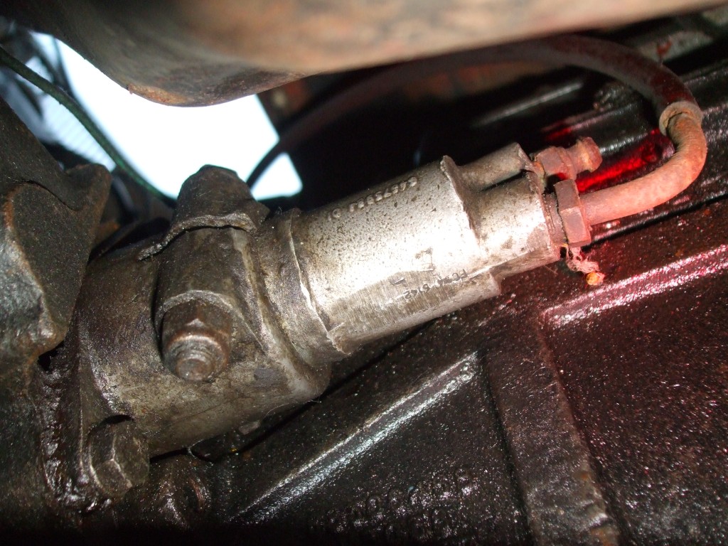

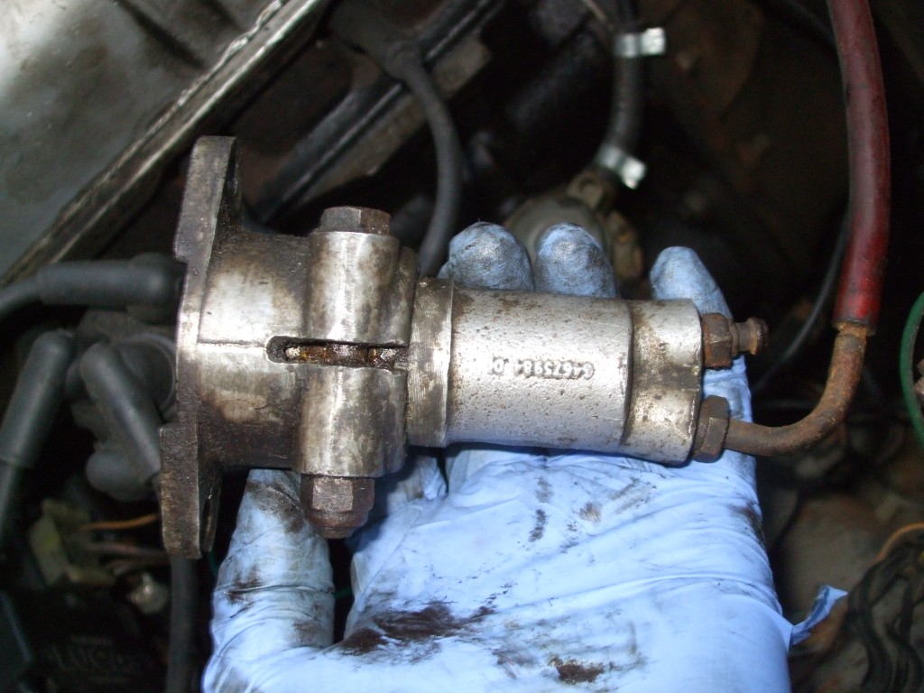

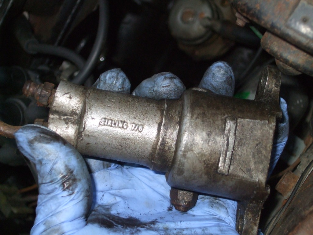

My Toledo has an aluminium Girling clutch slave cylinder fitted which I believe is original. Spitfire's as far as I know use 3/8 UNF hydraulic unions and mine has the standard Toledo / Dolomite clutch hose (part no. 155956) with the 7/16 UNF unions. When I overhauled it I also used a standard rebuild kit sold for use on Dolomites etc. I note in the Triumph parts books that the Toledo clutch slave cylinder has part no. 155954 and the equivalent part for the Dolomite 1300 / 1500 is RTC7215. As Triumph in my experience appeared to change part numbers only when a part was revised I wonder if the cylinders changed from earlier aluminium bodied units to later steel ones and this is reflected in the part number change?
I have attached a few photos of my Toledo's clutch slave cylinder below:
Edited to include hydraulic union thread sizes.
Last edited by DOLOMITE 135 on Tue Jul 14, 2020 10:33 pm, edited 2 times in total.

Does your Toledo have a three rail box?
If it does, that is the Girling Cylinder fitted to Heralds/Spitfires.
DOLOMITE 135
Posts: 122
Joined: Sun Oct 22, 2006 10:31 am
Re: CLUTCH SLAVE CYLINDER 1500
#25 Post by DOLOMITE 135 »
It does indeed have a three rail gearbox.
As I covered above, Dolomite / Toledo clutch pipe unions are different sizes to Spitfire units, Dolomites / Toledo's using 7/16 UNF and Spitfires 3/8 UNF threads. If you look at my photos you can see that the bleed nipple is smaller than the pipe union, Spitfire's share the same size thread for their clutch pipe and bleed nipple. Therefore I do not believe it to be a Spitfire or Herald unit.
