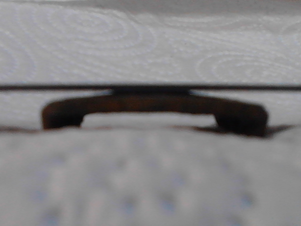

- GrahamFountain
- Posts: 1735
Re: I've broken another front anti roll bar mounting. Any idea why?
This shows the bow across the channel. It's taken from the unbroken end, which would be looking straight down if it were on the car.
Graham

- Posts: 7247
Youd get this effect if the wheel end links are stuck on the bars. Under load when cornering the bar will try to move forward against the bolts instead of sliding back through the link as it's meant to.GrahamFountain wrote: ↑Tue Jul 21, 2020 10:17 am This shows the bow across the channel. It's taken from the unbroken end, which would be looking straight down if it were on the car.

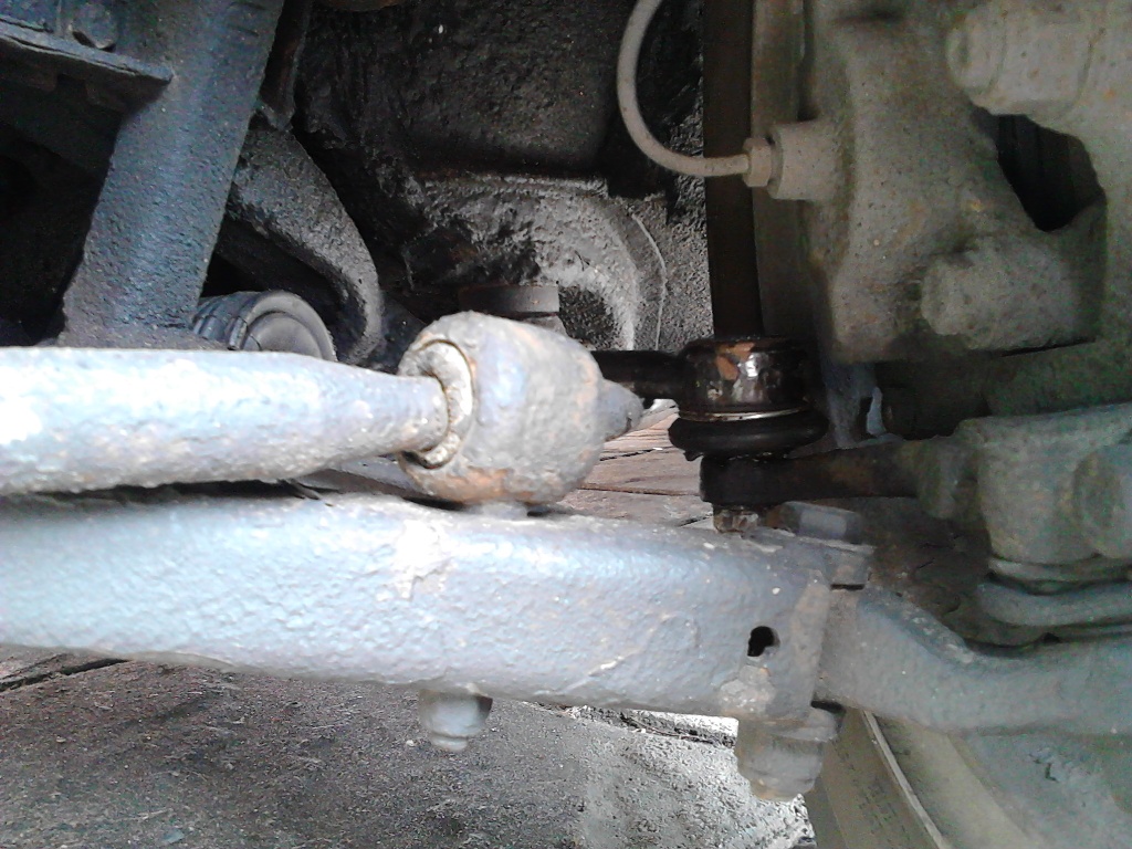

- GrahamFountain
- Posts: 1735
Not sure how I check for that.
Also, are the scrub marks on the bar normal?
Graham

- Posts: 7247
Look at the bar where it passes through the bush in the drop link, if there ISN'T a wear mark from the bush moving on the bar, (won't be huge maybe 1/4" or so) chances are, the bush has welded itself to the bar! Can't really tell from the pic.GrahamFountain wrote: ↑Tue Jul 21, 2020 11:14 amNot sure how I check for that.
Graham
The rub mark on the bar from tyre or wheel contact, I normally associate with an uncentred rack, which will allow more lock on one side than the other (assuming the rub is only on one side) There's very little margin of error built into Dolomites in this respect, a 1/2" can be critical as there are no built in lock stops. If the rub is on both sides it points to a geometry error or possibly bad bushes. Or non standard wheels and tyres with incorrect offset, but I assume you are using original Sprint alloys so that's not a factor. Your use of 60 rather than the stock 70 profle tyres won't make it happen.
- GrahamFountain
- Posts: 1735
You mean where the end of the anti roll bar goes through this rubber bush?
I can't see any wear mark, but it don't look like it's supposed to slide, just move on the compliance of the rubber in the eye bolt.
Not sure why this isn't poly like all the rest. Presumably, it's not in the kit of bushes.
