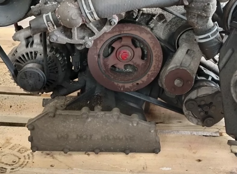

What’s behind the plate that’s says do not remove.
Is it just a for the extra oil capacity.
Do you still have the original sump.
Is there something diverting some of the oil like a bypass?

SprintV8 wrote: Mon Oct 28, 2024 9:52 am What’s behind the plate that’s says do not remove.
Yes I’m fully aware of the difference in sump types.
It was mostly about the oil starvation and baffles.
I’ve no clue what’s behind there. Seeing as it says do not remove, I imagine it’s there purely for manufacturing reasons. And yeah, that did pique my interest, something I’ll definitely think about adding is a horizontal baffle as well.
