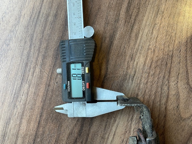

Hi Sean,
Could I just ask a small additional favour?
Could you please measure one length side and one width side of the bracket?
Many thanks again
David

David Embery wrote: Thu Jan 09, 2025 2:42 pm Hi Sean,
Many thanks again
David
Sure, I will do it tomorrow.
Sean

I suspect a bit of bent drilled steel will get the job done for you
I suspect that is actually what Sean has! The OE seems to have a tang on it that located in the side of the clamp; possibly to stop rotation as the nut is tightened...

I very much feel you’re spot on there Alun.
However, I think we have some very valuable pieces of information that I and my friend Kevin can now use to make something that is a perhaps ok to be considered a close approximation of what the original bracket looks like, including the tang, as that clearly performed a function. 🤔🤞

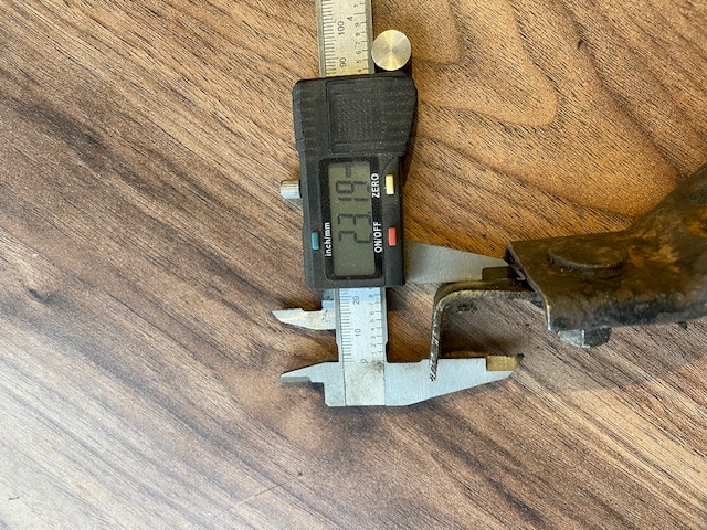

Macleesh
Posts: 316
Joined: Sat Jan 05, 2008 3:52 pm
Location: North Yorkshire
Re: Exhaust Support Bracket For 1850
#22 Post by Macleesh »
Hopefully these give you what you need
Shout if you need anything more.
Sean

David Embery
Posts: 62
Joined: Thu Nov 16, 2023 10:32 am
#23 Post by David Embery »
Many thanks Sean. Terrific photos.
I’ll keep you posted on my progress. :D

#24 Post by Carledo »
I'd be inclinedto make the face that fits over the stud a little narrower, or taper it towards the gearbox (and stud hole) end. Just to give an element of adjustability. As Shaun's is made, there's so little leeway it might as well be all one piece! The stud MUST be designed as a pivot of sorts, or there's no point in it being there!
Just a thought, Steve

Many thanks Steve. I’ll pass your comments on to Kevin and see what he can come up with.
