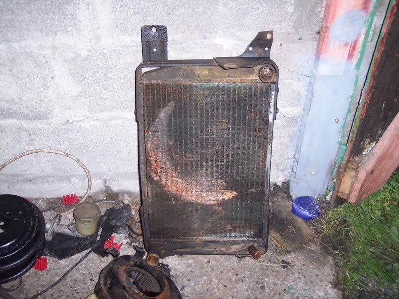

The engine didn't actually stop. the car did, the engine kept running but wanted to stall. The radiator has hit the fan, the fan has made a mess of the rad, water has leaked out, the car was driven with no water in it I guess, for about 5 minutes. hence warped head.
Atleast this head has plenty of metal left on it to be skimmed.
If it hasnt been skimmed a couple of times or more! You could still claim
Possibly...but not necessarily.
Does really depend on whether you were moving along or not. Also the car wouldn't have been completely dry for the whole 5 minutes. But it will need checking...
why did you decide the h/gasket had gone anyway ??
any way you'll soon be able to do them in your sleep (thats if you get any what with pulling engines out)
and what comp did you have ??
I've just had a though. this is odd. My 1850 had 160psi all round when that was checked over a year ago. This one with low compression pistons in it had 175-150psi before the head was retorqued, and there was a bit of tightening in 3 or 4 of the studs/bolts.
No bubbling in to the expansion tank or pressurised coolant pipes though.
Oh and decided it had gone as it had run with no water in it. When the bonnet was lifted it was steaming and crackling... The reason I didn't check it out was the battery was so flat it wouldn't turn the engine over when I went to comp test it last time I was home.
