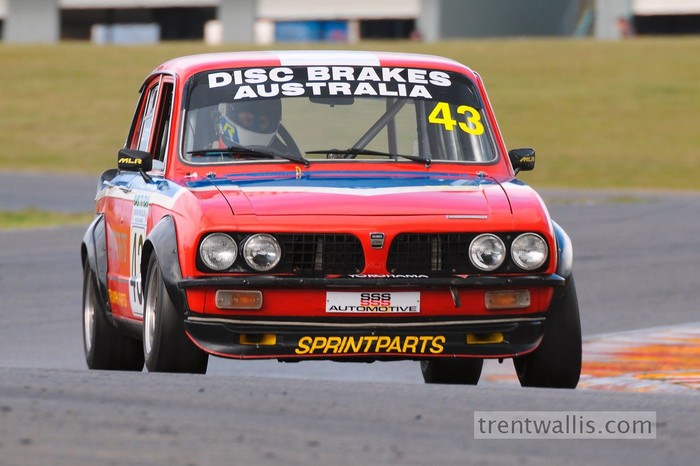

I thought that I might give an update on how the "new" car is performing.
Although it has a very heavy DNA from the damaged car, it still feels different to drive but it is getting faster. It is now fitted with the Group 2 flares and a much wider track front and rear. I have finally had it weighed and it is approx 70kg lighter than the white car.
This photo was taken last weekend at Oran Park (NSW) which is where the car had it first racing meeting back in November 2008. This time the best lap time was 2.3 seconds a faster, which is nearly .5 seconds faster than the "old" car, so i am going in the right direction, just now need to find another 5 seconds a lap to match the front running cars.
Unfortunately on the last lap of the last race for the weekend the motor developed a bit of a "knock", but I did complete the lap but loosing 6 places in the process.

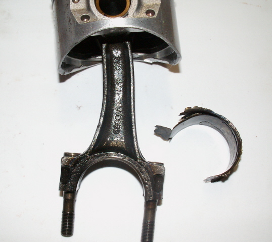

I think that this is the first time that I have ever run a bearing in a Dolomite Sprint motor, it bent the rod and the crank is a throw away, having been worn down more the .015" from its original size.
Now have 4 weeks to sort out the motor. New crank is with the machine shop for grinding, then it will be heat treated, rod to be replaced and hopefully everything will go back together in time.

That's an impressive bit of damage; perhaps we should start a 'black museum' of spectacularly damaged components!
Re: Sprintparts #43 Version 2
Ouch !... just trying to 'get my head around' the amount of force required to bend a rod, like that
My old '2000' broke a valve spring, once - snapped the head off a valve; then, burried it (about 3-quarters of its diameter) in the top of the piston ! Likewise; couldn't really appreciate the forces that are at work inside an internal combustion engine.

Unfortunately I could fill my museum of broken parts.perhaps we should start a 'black museum' of spectacularly damaged components!
Pistons, conrods, crankshaft, clutch covers, clutch plates, engine blocks, bent valves, stripped gearbox gears, stripped crown wheel and pinion, bent panels, cracked wheels, etc, etc, etc.
Work out how many dollars has been spent building up this "museum".

70kgs lighter? that's an awful lot isn't it? where do you think the weight saving is?SPRINTPARTS wrote:I thought that I might give an update on how the "new" car is performing.
Mark's wallet- lol
Philip
Mark's wallet- lol
Philip
Attention to detail.where do you think the weight saving is?
The rules that we run to are very specific, not light weight body work, all original panels etc and glass. Any mods or changes to the original white car was always very conservative, in consideration of its historical value (Australian Group C Touring Car, which competed in the Bathurst 1000 in the late 1970's early '80's.)
This car has been built using some of the freedom in ours rules which I didn't want to inflict on the white car. All trim removed except door trims, all dash timber (now carbon fibre panels)and gauges removed and only what necessary installed. The wiring harness was stripped and all unnecessary wiring removed, but all light indicators etc still work. No vinyl roof, alloy body shock absorbers with small diameter springs, less complicated fuel system, ie so surge tank or low pressure pump for EFi, just HP pump and small filter. All sound deadening (including all the tar like substance on the joints in the cabin) removed, all unnecessary brackets or bits removed, etc etc.
The new rear axle assembly that this car runs would be at least 10kg heavy than a Sprint diff, but in a wish for ease of parts etc it was one thing that I was prepared to accept.
I think that this car probably also has less body filler.

Hey Mark,
Car's looking very nice with those arches! Sorry to hear about the rod and bearing - how many rpm did that happen at?
Cheers,
Garth
