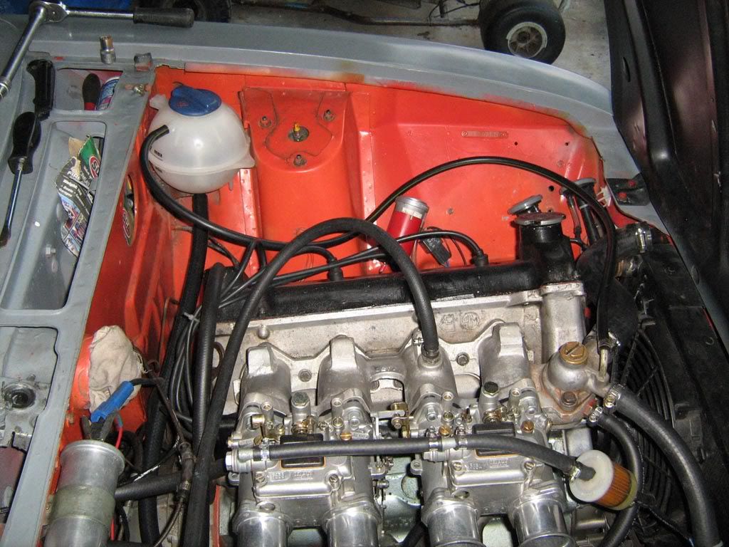

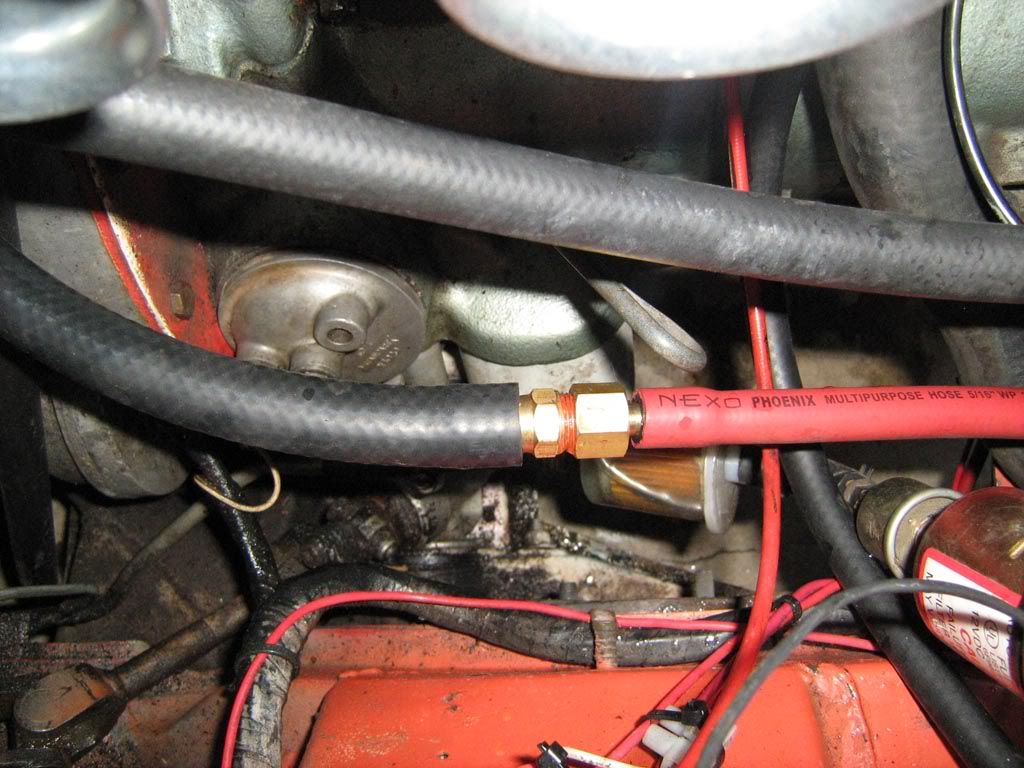

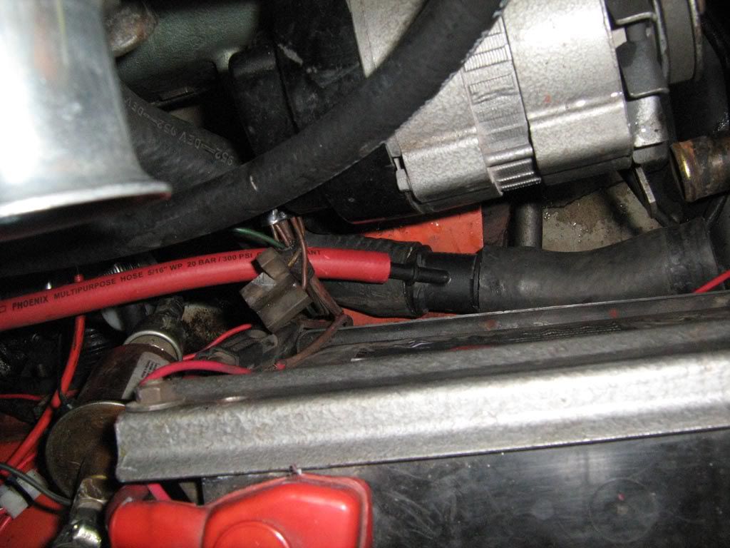

While i was waiting for the old fulla to get home to use the ute i mocked up and cut all the hosing for the header tank and cut the bottom radiator hose and fitted the T Junction.
And removed the Old Expansion tank.
Going to get some Good coolant today and empty and flush the system out with Soapy water, then fresh water to make sure everything is nice and clean.
Anyways some pics
The T Link in the Bottom hose
The Brass converter, all Lock tite Sealed
And the cooling tank and other hoses

Well before i fitted the system i was getting a slight increase in temprature with the motor.
Now after i have fitted it i am having more of a increase in temprature.
I can't put my finger on what is wrong.
I thought that the abient temprature which has been arond 27 odd degrees over the last few days might have made it worse.
So then when i was driving i switched the electric fan off and the temp started to rise, i then switched it back on and the temp dropped again.
Soo then i thought the fan which is a 12inch might have been restricting the airflow through the radiator.
So i took it off and put the mechanical fan back on.
Which helped a little bit while cruising but not very good when stationary.
Then my car was sitting at idle and the fan stopped spinning.
I shut the car off and moved the fan, and to my suprise the Bolt that holds the crank pully in place feel out.
After 6000miles seemed a bit odd and after lewis thread.
So now i have to pull the fan and radiator back out to tightned the nut back up.
Now what is wrong with my car?
I have had the 48s on for a while now and have done alot of good running and then i left it idling in the garage and it got a bit hot and the old header tank seal was pretty crappy which let it push out liquid i wouldn't say i was boiling over.
Was just getting near the 3/4 mark.
I have since put the VW Header tank on, new plumbing it should be better not worse.
I had what i thought was a leak out the top of the head gasket which turned out to be the usual manifold leak wwith coolant boiling on the head.
I have normal pressure in the radiator hoses,
For some reason a cold radiator when i stop from crusing speed and feel the radiator its cool, but after 2 minutes or so of sitting still the radiator gets hot to the touch.
Can the water pump impellor slip in the shaft? Or anyway it carn'tpump water?
No oil in water or water in oil
Pulls fine and does not ping.
Something seems odd to me.
