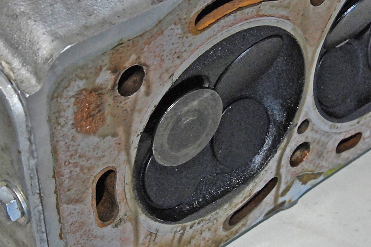

Jeroen has asked a very valid question, a question which upon reflection had me puzzled too, puzzled for I should have asked the very same question myself before I prepared my earlier posting.
However I now know what it was that was embedded in the top of the #3 piston.
Jeroen is absolutely right of course for it would be well nigh impossible for a piece of broken valve spring to get out from under the cam follower/bucket and somehow find its way into the cylinder/s.
The photograph here shows the bent valve.
20130511-4102Pttw Sprint bent valve in the cylinder head.jpg (149.47 KiB) Viewed 5096 times
It is likely that this is the sequence of events; the valve spring breaks, the valve “drops” and is hit by the piston. Hit several times, so it would seem as it is steadily bent into the position seen here for there are several very light moon shaped marks in the top of the piston itself. In bending the valve, several small pieces are broken off the end of the valve guide and it was these small pieces which were “pumped” out of the #4 cylinder, passed back up the inlet manifold and, perhaps “sucked”, back into the #3 cylinder.
What looked like pieces of a valve collet are in fact pieces of valve guide, similar in shape.
I consider myself lucky that all the damage has been confined to one inlet valve and guide and one exhaust valve, one spring, the top and bottom collars that sit on that spring, the split collets, and the cam follower which is fairly badly marked in the area where the pallet shim sits.
Had the valve broken then I expect the damage would have been much worse.

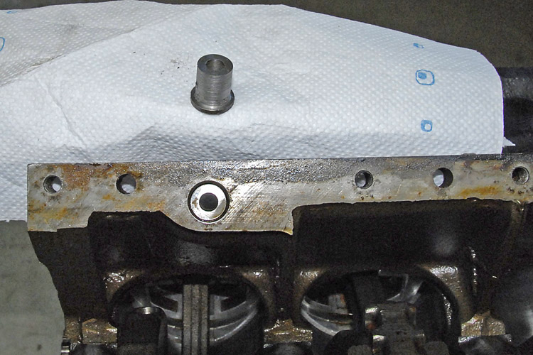

While I have had the sump off to remove and check the pistons/piston rings for possible damage I have photographed the two bushes which I roughly machined to go into the two oversize holes in the base of the block through which two 5/16 bolts are passed.
20130524-4124Ptw Crankcase sump bushing.jpg (149.75 KiB) Viewed 4986 times
The workshop manual suggested that the nuts on these two bolts be tightened to 20 ft/lbs. If you do that then you will distort the sump itself for it will crush the sump gasket and cause a leak. I have overcome this problem by fitting these bushes – one you can see in place, and the other sitting above it (which goes in the second hole). There is quite a substantial chamfer on the hole in the block but both bushes have been turned down to approximately .005 less diameter than the hole which measures .625 of an inch. All the sump bolts have been torqued down to 10 ft/lbs and will be checked again before the engine has run. I expect no further oil leaks from this area!!

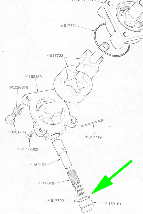

Meantime I am waiting for some oil pump seals to arrive from the UK. The oil seal, (see the green arrow) - the o-ring that sits on the end plug which holds the relief valve spring in place had gone quite hard.

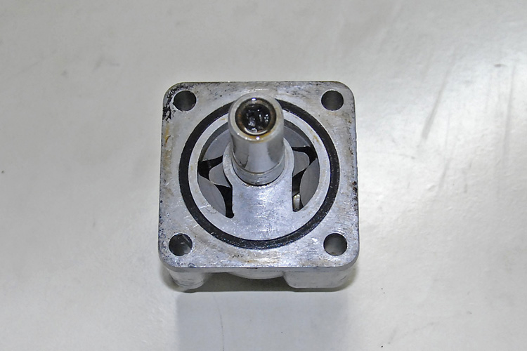

While the engine was out of the car I renewed all the three o-ring seals in the oil pump. I remain puzzled as to why these o-rings were not included in the bottom overhaul gasket set which came from Rimmers. Perhaps it is thought that the pump should not normally be disturbed. The new seals arrived during the week past and were promptly fitted. However I was a bit puzzled by the o-ring seal which I received which goes between the oil pump and the block which when I removed the oil pump looked like this.
20130619-4153Ptw O-ring oil seal Dolomite oil pump.jpg (117.43 KiB) Viewed 4862 times
It looked more like the seal which sits under the oil filter – a square section rubber ring. I removed this seal to find that the original o-ring was encapsulated in what looks like some hard gasket cement. There was no evidence of gasket cement on the flat faces between the pump and the block for had there been it would have suggested that some might have found its way into the pump itself. The o-ring groove was carefully cleaned and the o-ring supplied, installed, along with a new o-ring under the oil pump cover and one on the relief spring end plug/cover. This o-ring on the relief spring cover had gone quite hard suggesting that it was possibly the original fitting.
