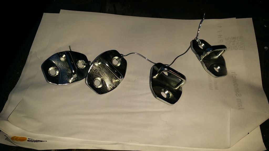

Bit of a step forward today...just had the chaps round to give me a quotation for paint in 2 pack and it looks like being around the £3.5k mark, to be undertaken in May.
I have had another quote of a grand less, but I know that chap, whilst very good, is very unreliable and these guys (http://www.motorsportpaint.co.uk) have a great reputation.
I would have liked to have brought the price down a bit by doing a lot of prep myself, but since having spent 4 days in Hospital in Portsmouth after being taken ill at Goodwood, have been advised to take it easy for a bit. Consequently, it's going to cost me a bit more to get done, what I can't really tackle for a while.

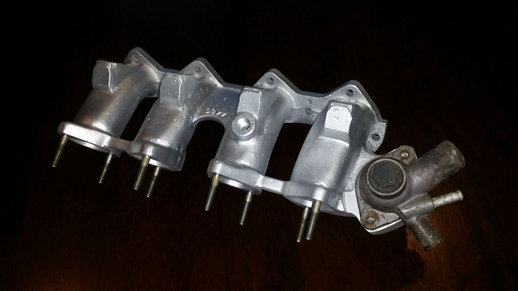

Additionally, I pick up my shot blasted exhaust manifold and powder coated rocker cover tomorrow night, and my replated door latches and shot peened inlet manifold from Niphos in Crewe tomorrow.
So, progress, progress!
Pictures to follow obviously :)

In the mean time, I've been to pick up some stuff from the platers....
I left the thermostat housing in the picture to show a before and after...
I have an inlet manifold gasket, but do I need to use any hylomar?

I'll be picking u the exhaust manifold up soon and will then be bolting it to the engine.

I don't use anything on new gaskets. Maybe a spot in the corners of the sump.
