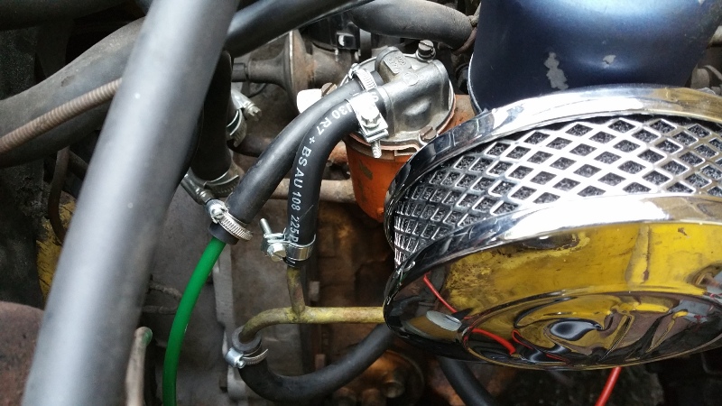

Took the hose off this morning, ST had changed it so that seems fine, however I have ordered a new one with petrol clamps, as the jubilee clips they fitted look nice, but not very wide.

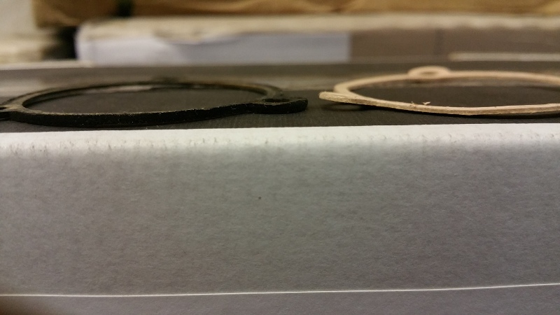

#153 Post by Mahesh »
Spares still have not arrived, but I do have a new float and gasket.
Changed the float this morning before work, still leaking.
Changed the gasket, stopped leaking.
It seems that there is a thickness difference, which was raising the float height so as not to cut out supply.
I think ST put one of their own gaskets in, I'll only know when I empty the boot, as I did supply new ones.
Hard to see from the picture, but in hand its about double the height, will wait for the spares and change
the whole kits on both floats.

I have a feeling that my floats and valves have worn/aged, and the gasket thickness made a difference.
ST have used their own gaskets, the ones I supplied (rimmers) are in the boot, and are very thin, maybe
someone might test this to be 100%.

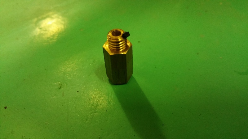

Thought I'd change the float, gasket and valve kit on the rear carb this morning.
Glad I did, after cleaning up and removing the brass valve, there was a big lump of rubber
inside over the opening. How the carb even functioned is beyond belief, its bigger than the opening.
The fuel pipe (float to metal link) from Burlens felt superior and so were the proper petrol clips,
so they got changed, I used the old pipe to replace the one on the overflow which was begining to
deteriorate.
Now have to do the pipe and clip for the front float, have to change it, quality difference and tight
fit is too much to ignore, 10 mins tomorrow.

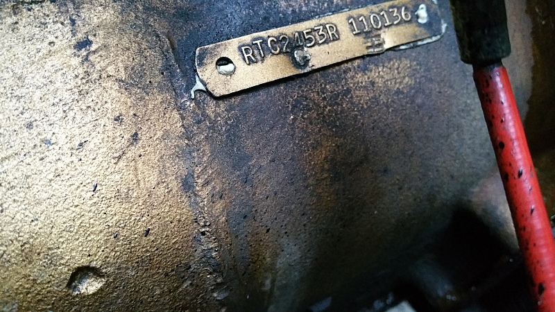

While I was doing the rear float, I took a picture of the engine number, I think its probably going to fall
off, sooner or later. Any suggestions for what type of glue ?
Posts: 7253
#163 Post by Carledo »
Mahesh wrote:While I was doing the rear float, I took a picture of the engine number, I think its probably going to fall
Araldite FTW!
