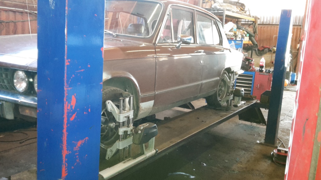

Setting the tracking

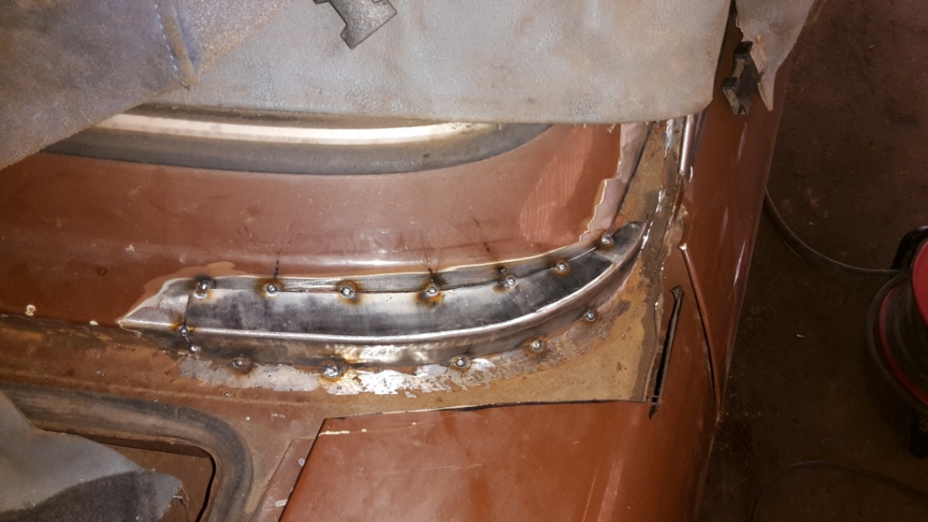

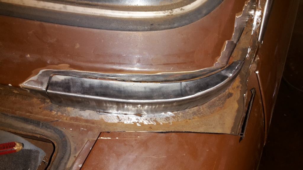

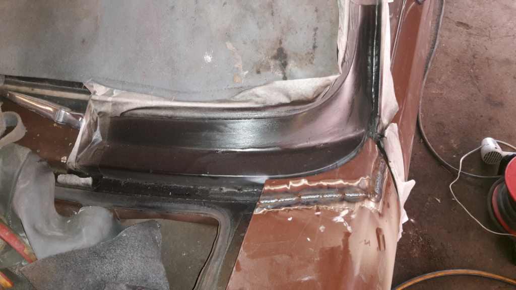

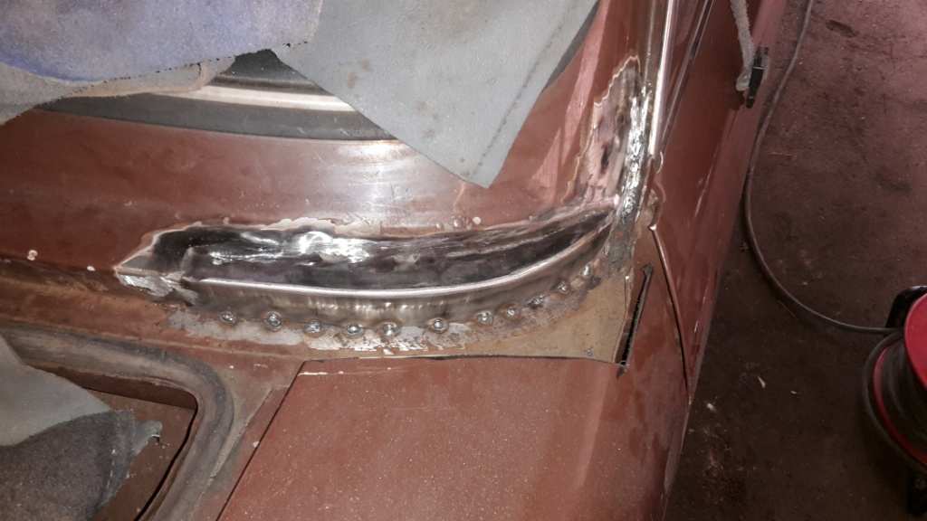

Today I repaired the rust hole on the passenger side a piller. First I cut the top rear section of the wing off to gain access to all of the rust. I then removed the paint and found more holes. I then cut out the rotten metal and cleaned up around the hole. Fabricated new over size section then spent ages cutting and grinding to make it fit and welded in. Applied some filler and sanded down then painted with primer then black as that's all I had. I then welded the part of the wing back on and ground the welds down then filled and painted.

New panel fabricated
After a lot of cutting and grinding panel fits
Tacked in place
Tacked in place
Welded and ground smooth

Last couple of pics. Still needs finishing but it will keep the rain out now.

It's 2 pieces welded from the inside so there was enough thickness to round the edge over to match the existing panel shape. The whole job took 6 hours and it still needs more blending in. The next repair I'm thinking about doing is the rear arches. Might buy the panels for that. Bit more of a tricky shape to make! Cutting big holes in your own car always takes courage. Just want to say sorry for causing it pain.lol. the good thing is it doesn't whistle whilst going along now.

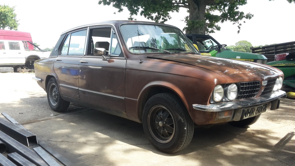

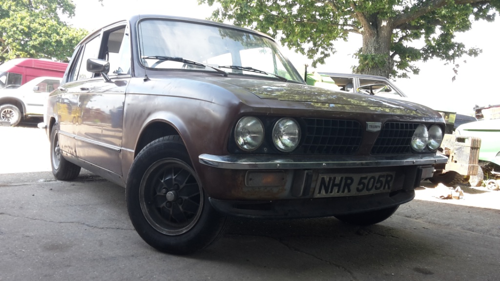

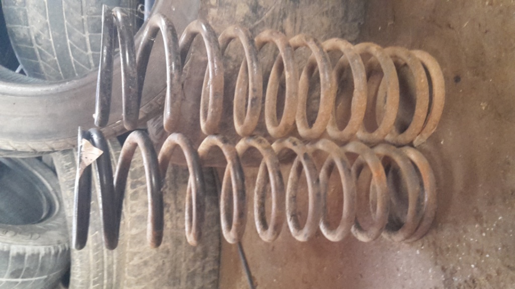

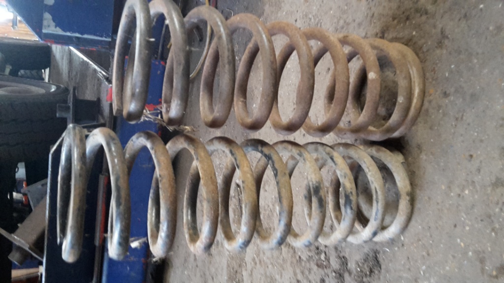

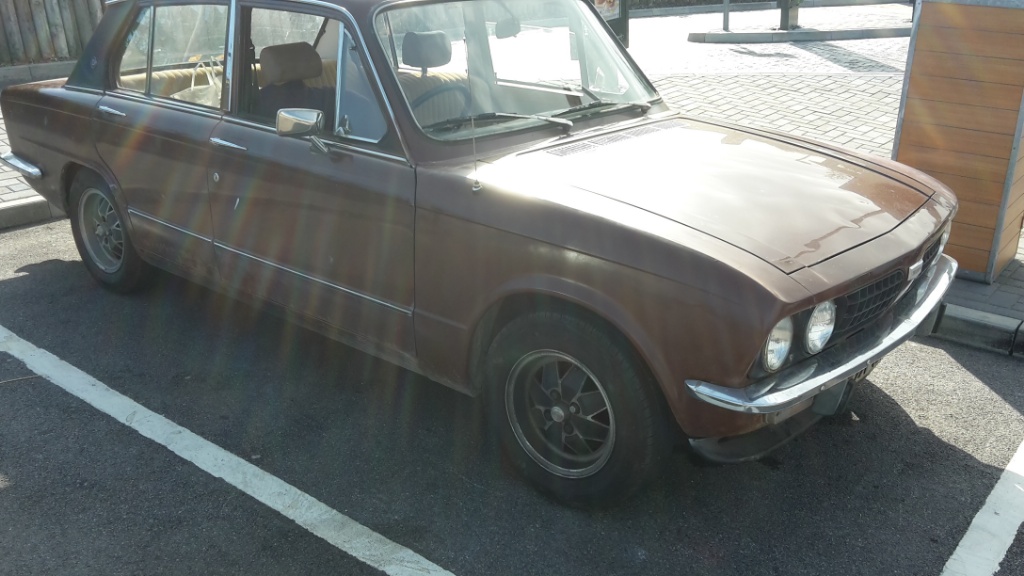

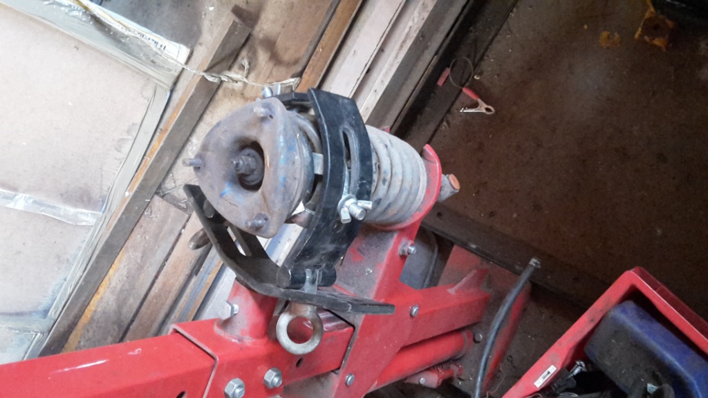

Today I decided to re fit the lowered springs to try and improve the handling. When I did the fronts I found that passenger side standard spring was shorter than the driver side. Thought it was handling a bit odd. I also found that 3 out of 4 shocks are on the way out. To do the rear shocks I had to remove the battery tray so while it was off I decided to put the boot lining under it to tidy it up a bit. Then I dug out the front spoiler and fitted that. Suspension properly seteled after a little drive to a well known fast food restaurant. It handles so much better now and doesn't wobble around corners, can go into them with a bit more confidence now.

Removing first spring. Didn't see the point in taking pics of every one.
Standard and lowered front spring
Hight difference between removed front springs
Standard and lowered rear springs

After fitting springs. Fronts havnt settled properly yet

Suspension settled in restaurant car park

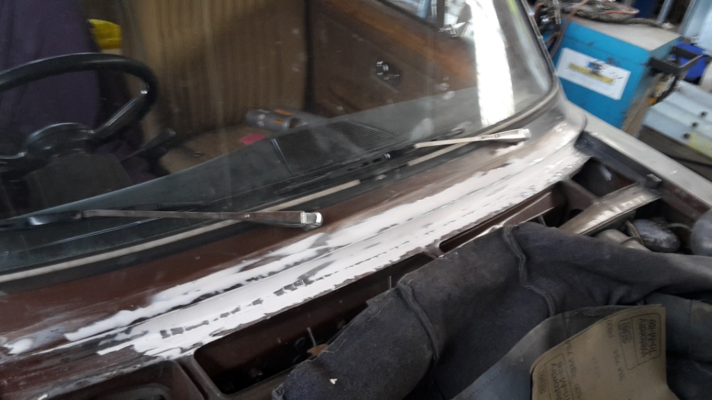

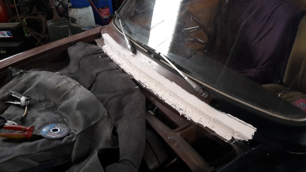

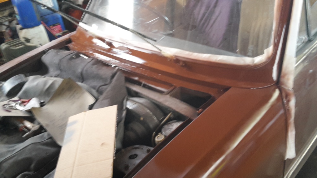

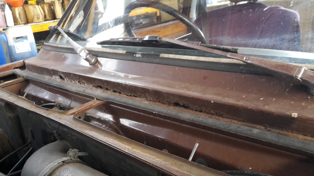

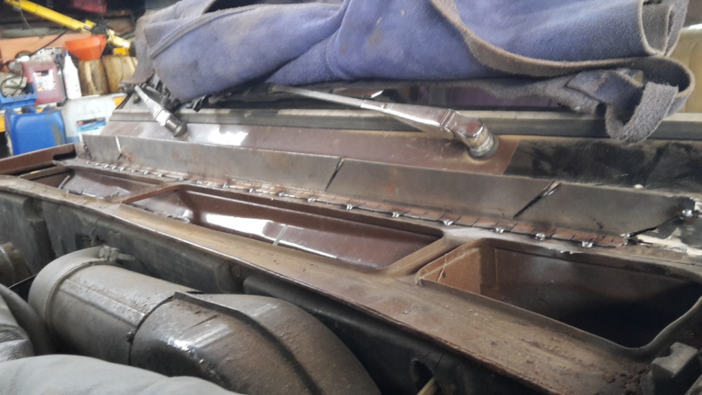

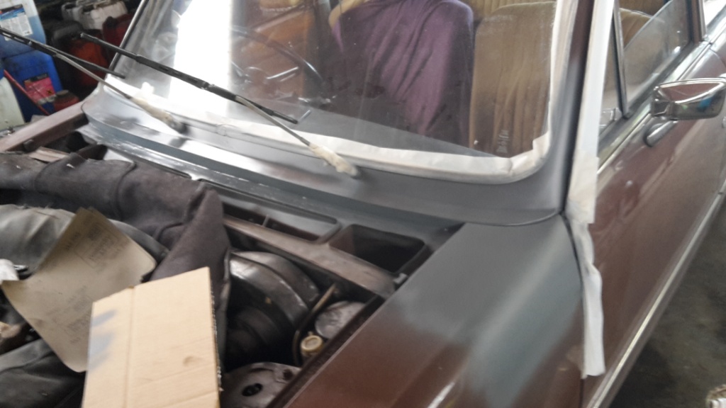

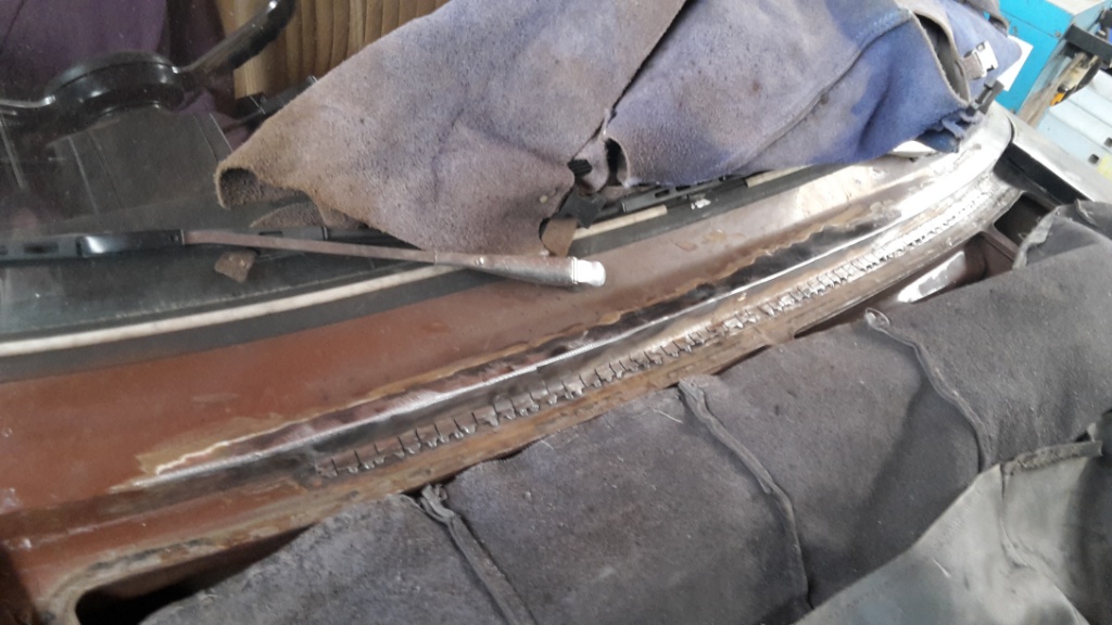

Today I cut out a little more rust on the scuttle. 4 hours later and it's all solid metal again and I treated myself to some russet brown paint. It will need more flatting off when whole car gets resprayed but I'm impressed with how it's turned out.
Rusted all the way along
Rust cut out. Lots of flakes off outer skin but the inner pannel are still solid
Over size section made. Cut slot so it will follow the curve
Tacked along bottom edge. Had to cut vertical slots to allow pannel to follow firewall shape
Closed the bonnet to check the gap
Held panel in right place whilst tacking from the back

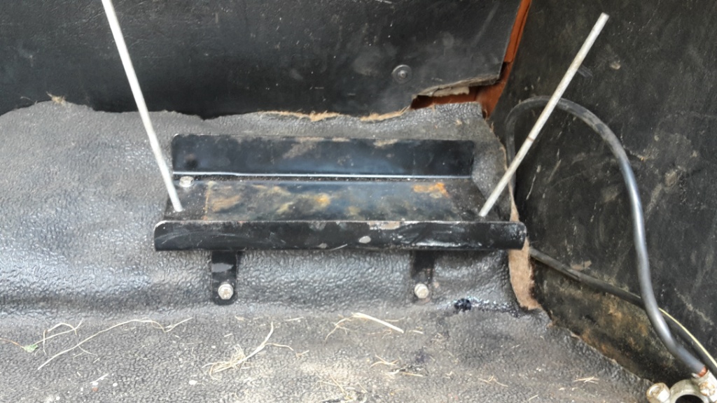

Too ground down flush. I used an arc welding rod to fill the gap and give the edge some strength. Short lengths of rod layer in the gap then MIG welded in
Panel welded in
Panel welded in
Welds ground down
Welds ground down
Filler applied
Filler applied
philgroom
#161 Post by philgroom »
More pics from today
Filler sanded down
Filler sanded down

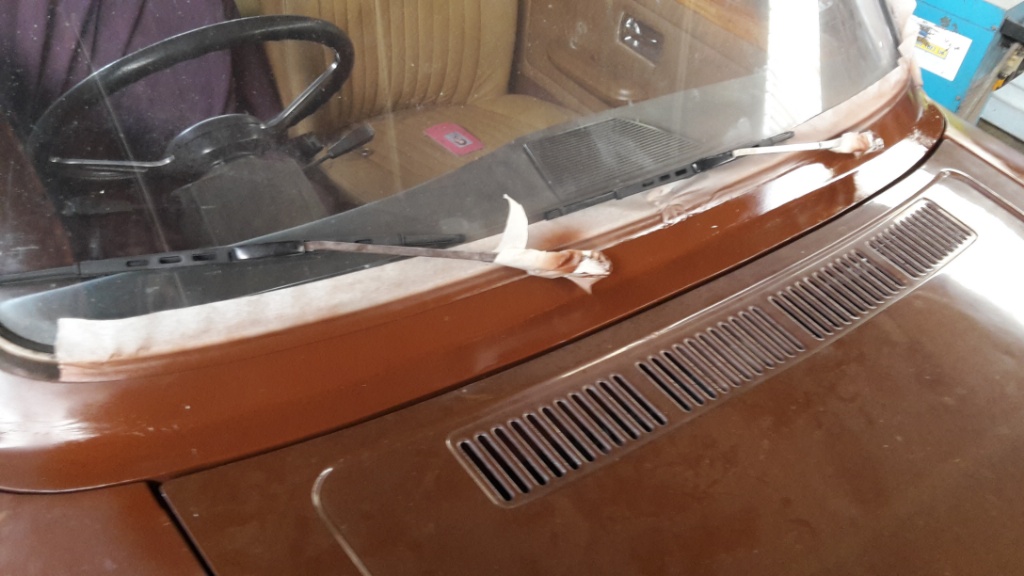

Zinc primer applied
Zinc primer applied
Painted russet brown. When it gets dirty and fades it will match the rest of the car
Impressed myself with the pannel gaps
Finished
Finished

I see you have managed to buy yet another shade of Russet brown! Nice work though mate, takes courage to take on that panel with nothing more than a sheet of steel and a pair of tinsnips!
Don't be upset about the colour match though, I'm convinced that every Russet car is a slightly different shade (sometimes several slightly different shades) there are at least 6 factory shades, then there is fading, cos Russet has a lot of red in it! When I used to paint, back in the day, I only ever ordered 1/2 a litre of Russet, cos I knew that by the time the paintshop had finished tinting it to match, i'd have enough to paint the whole car!

Carledo wrote:I see you have managed to buy yet another shade of Russet brown! Nice work though mate, takes courage to take on that panel with nothing more than a sheet of steel and a pair of tinsnips!
I've found telling myself it's a customers car helps when cutting big holes in the body work otherwise I would never have the courage to do it! Just got to work my way round the rest of the car now. I'm not fussed about what shade of russet brown at the moment coz it will have a complete respray at some point.
