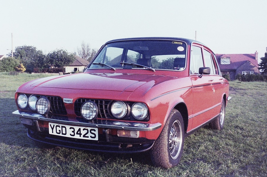

Mike, I know this is a very old post, but I was the owner of YGD 342S before Davy67.
I believe he has emigrated to Aus.
Here's a photo of when I owned it in the late 80's.
I'd love to see what it looks like now.
