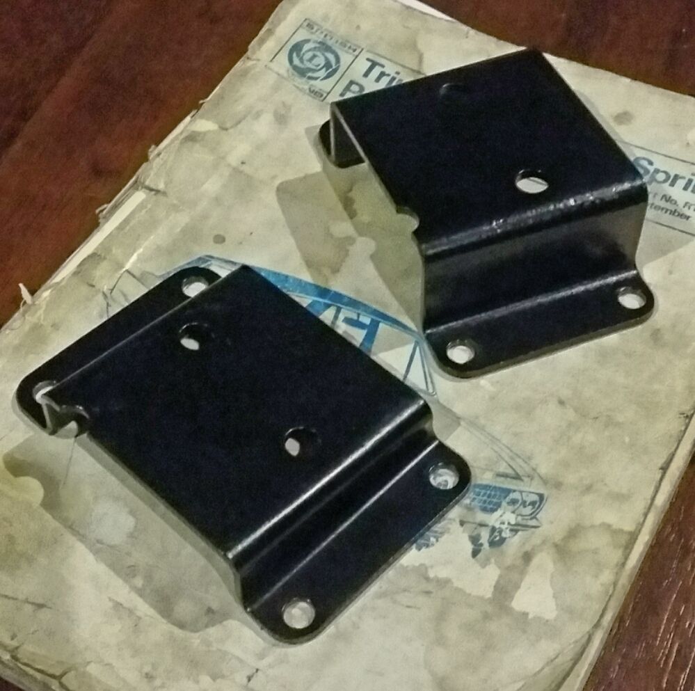

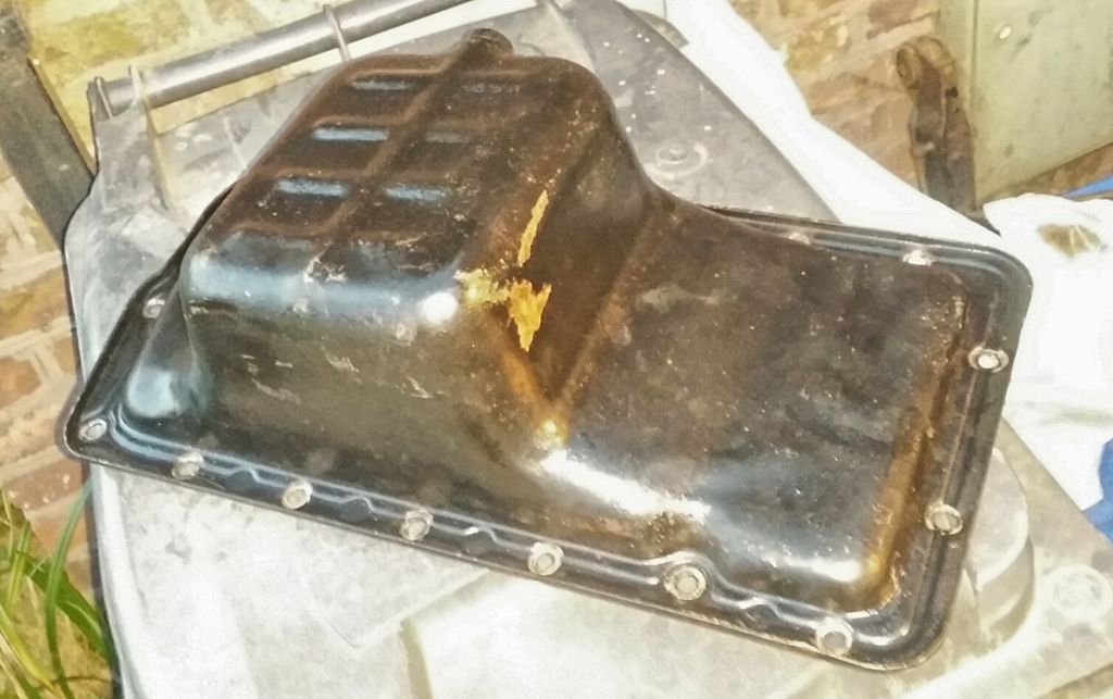

Been to pick up a bit more powdercoating up to day and did a bit of rubbing off!
Looks alright I think...

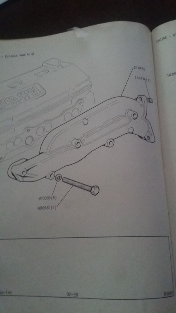

Re: How bad is my Sprint?
But not in Cheshire it would seem!
Can get 4" 3/8 UNC but not 3.75" even from those places in Weston Mart....what length do you use?
Additionally, the parts catalogue shows full thread....
Ideas chaps?
Ideas chaps?
Well.......
You could follow Jeroen's example and convert to M10 bolts using Helicoils?
Lovely job that, must have taken a steady hand.
Tony - masked all the outer surface with tape and used a flat rubber block with wet and dry.....my arm nearly fell of afterwards! Tried to use a dremmel but the grades of abrasive wheels I had were either too coarse or did nothing!

Re: Well.......
Hoho, can see me making a right balls of that!!sprint95m wrote:You could follow Jeroen's example and convert to M10 bolts using Helicoils?
So, bolts or screws?...I know which the manual shows!!
Shaunshaunroche wrote:But not in Cheshire it would seem!
Ideas chaps?
Buy some 4" ones and cut them down - try these people https://www.namrick.co.uk/acatalog/Home ... ts_18.html
I have purchased new bolts / set screws from them Inc. manifold bolts - mine just need cutting to the correct length.
Ordered some 4" ones from Spalding Fasteners Paul...glad I'm not the only one to think about this approach!Flyfisherman wrote:Shaunshaunroche wrote:But not in Cheshire it would seem!

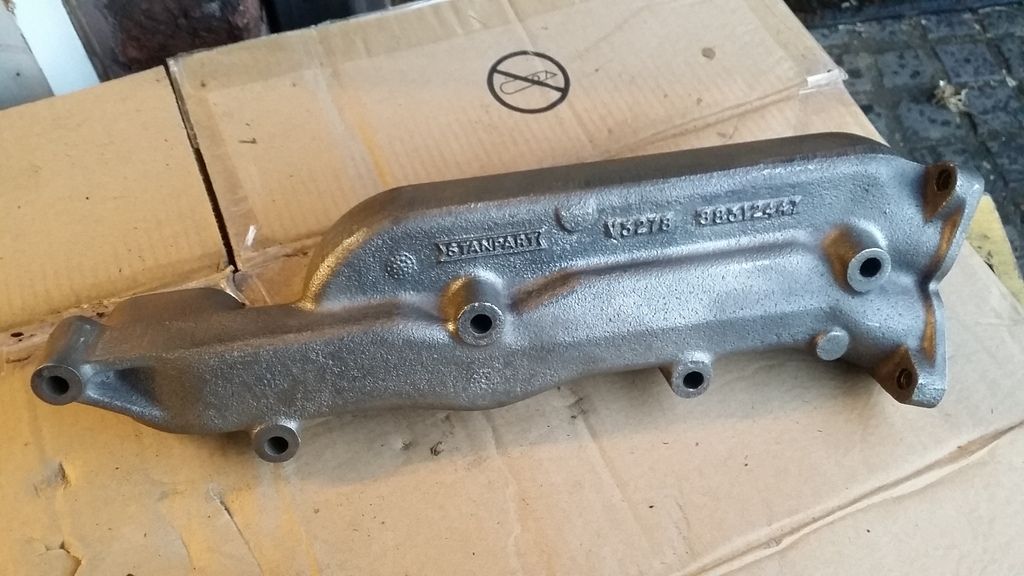

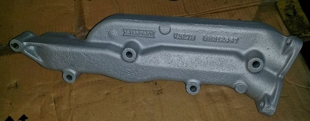

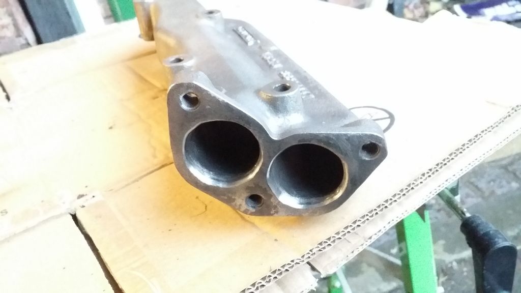

Due to the light you can't see much difference, but this picture is the exhaust manifold after being shot blasted and after having a broken stud removed and a tap run down all three threads...
I then opened up the exit ports to suit the gasket as I don't have the Jigsaw down pipe yet, hoping that they're something like...
....and then sprayed it silver using Halford's manifold paint..
Picking up yet more powder coated stuff tonight and will report back...it'll be all about reassembling soon!

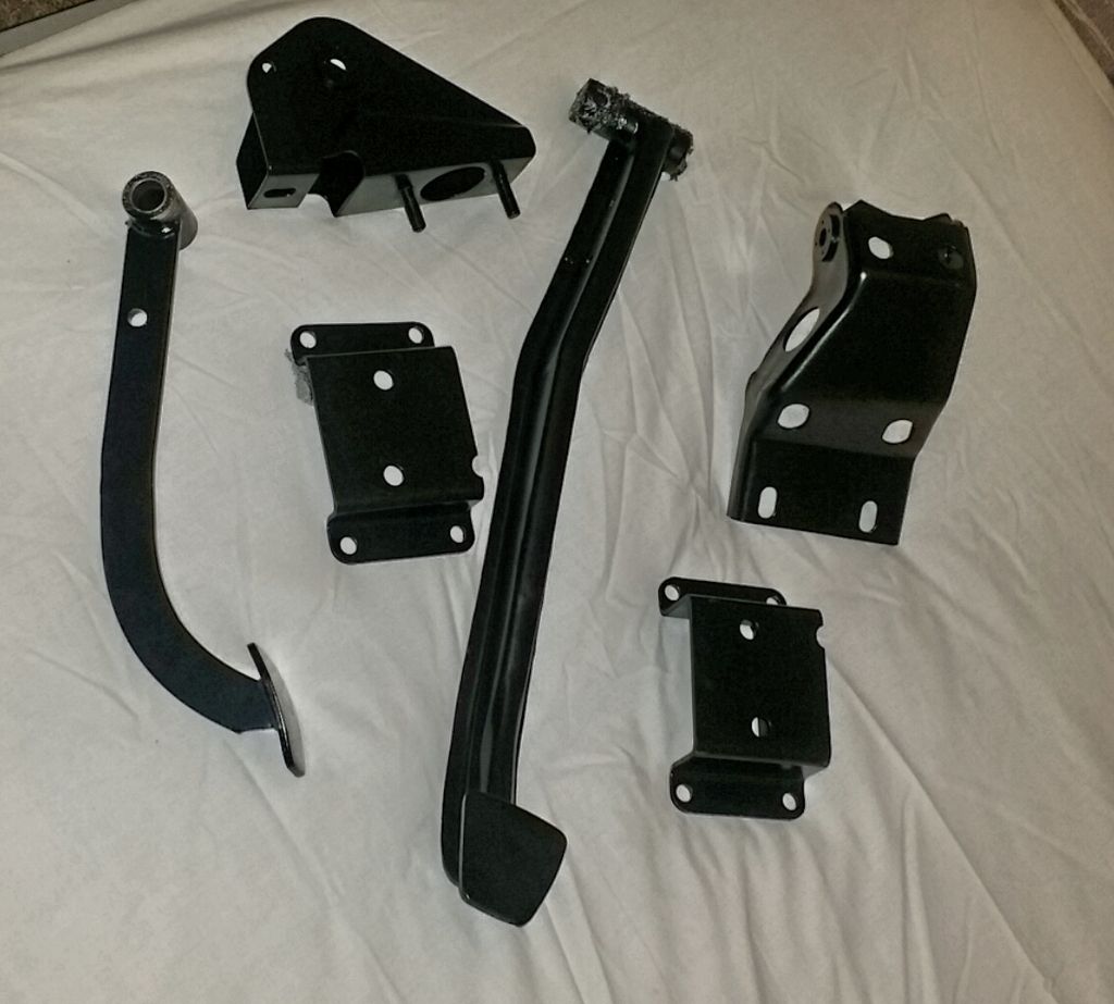

Nice job, Shaun. And there is more pretty stuff coming your way soon
Hurrah - Big Smiles!!DutchSprint wrote:Nice job, Shaun. And there is more pretty stuff coming your way soon![]()
