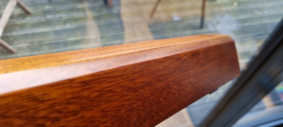

Got my door cappings back from my local french polisher, sanded & 8 coats of satin PU lacquer. Very nice.

Tony Burd wrote: Fri Dec 02, 2022 3:03 pm Got my door cappings back from my local french polisher, sanded & 8 coats of satin PU lacquer. Very nice.
Beautiful!
I had a french polisher I use through work do a couple of sets for me last year, but I think these are better!

Posted: Sat Dec 31, 2022 12:51 pm
by Tony Burd
That's where I got the idea from after speaking to you at TDCIR.
