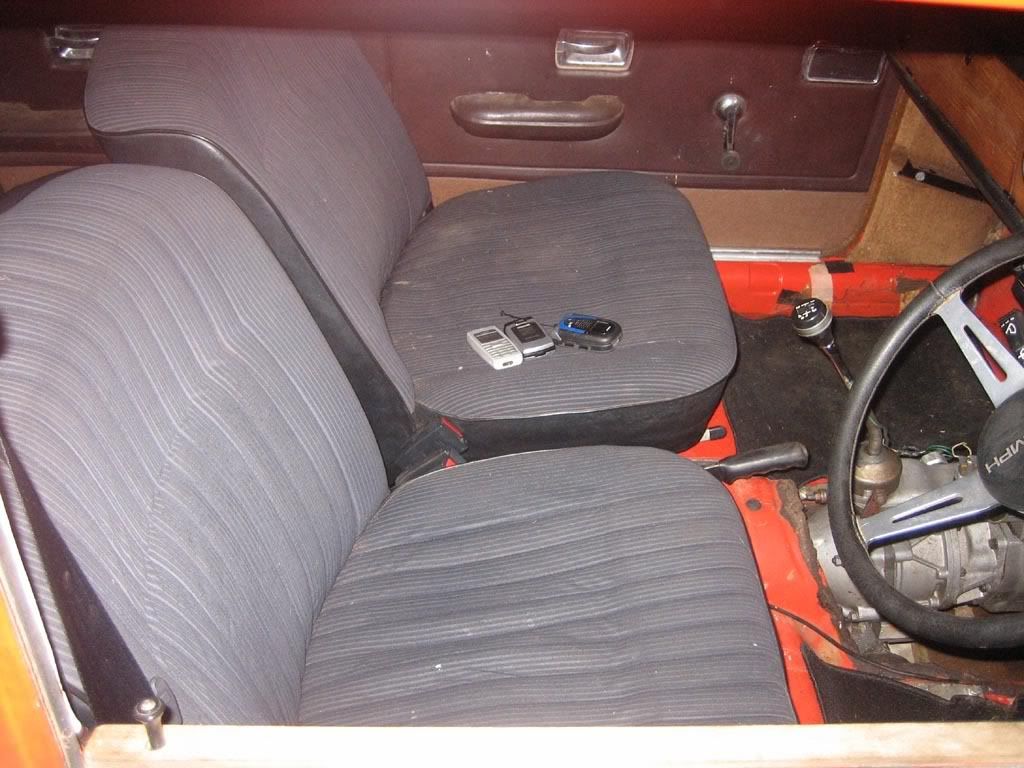

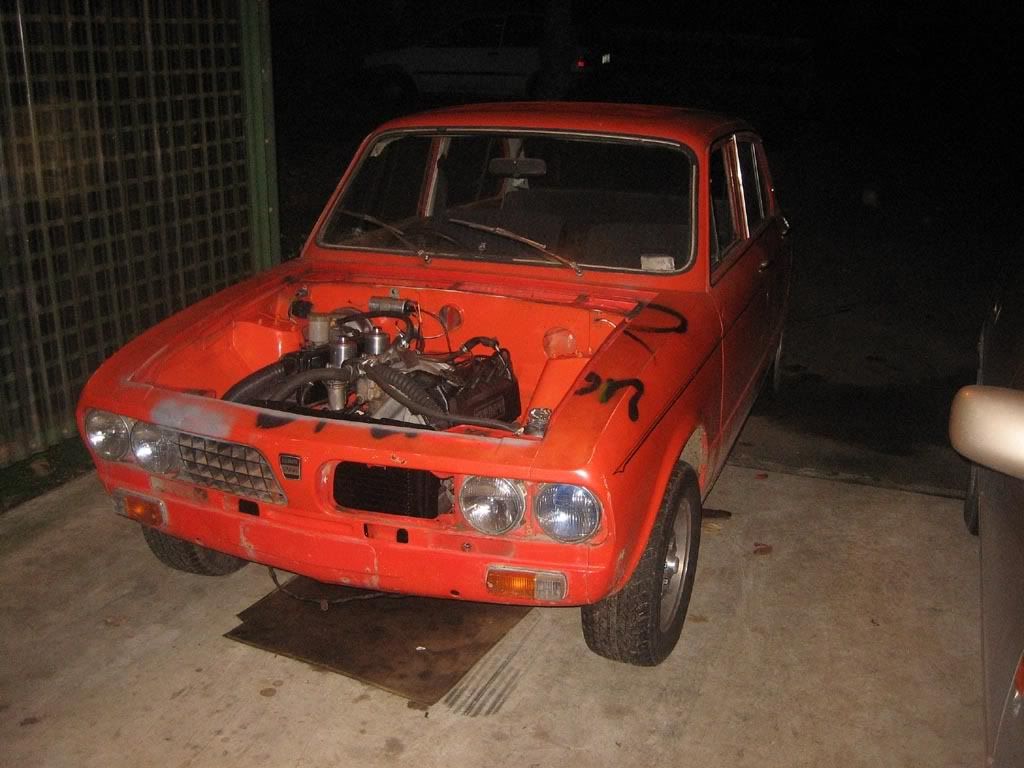

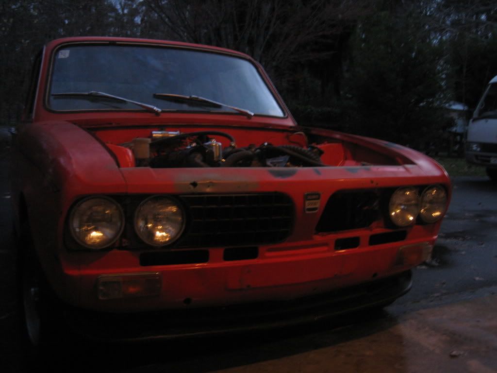

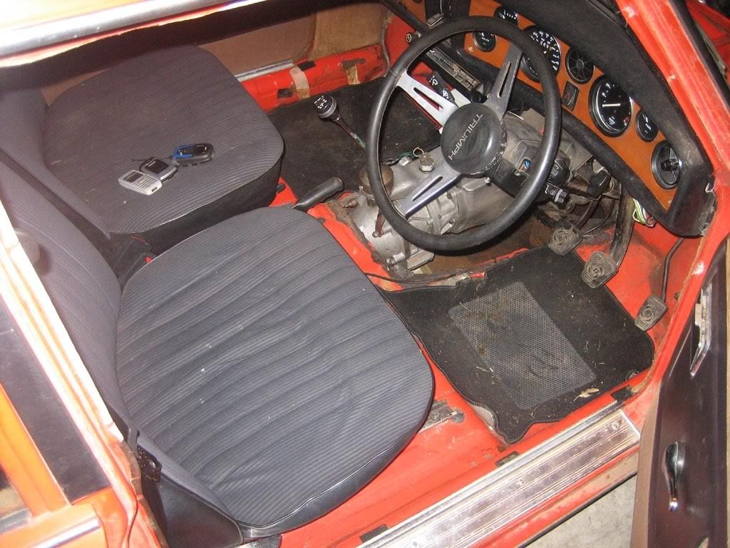

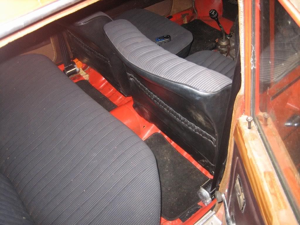

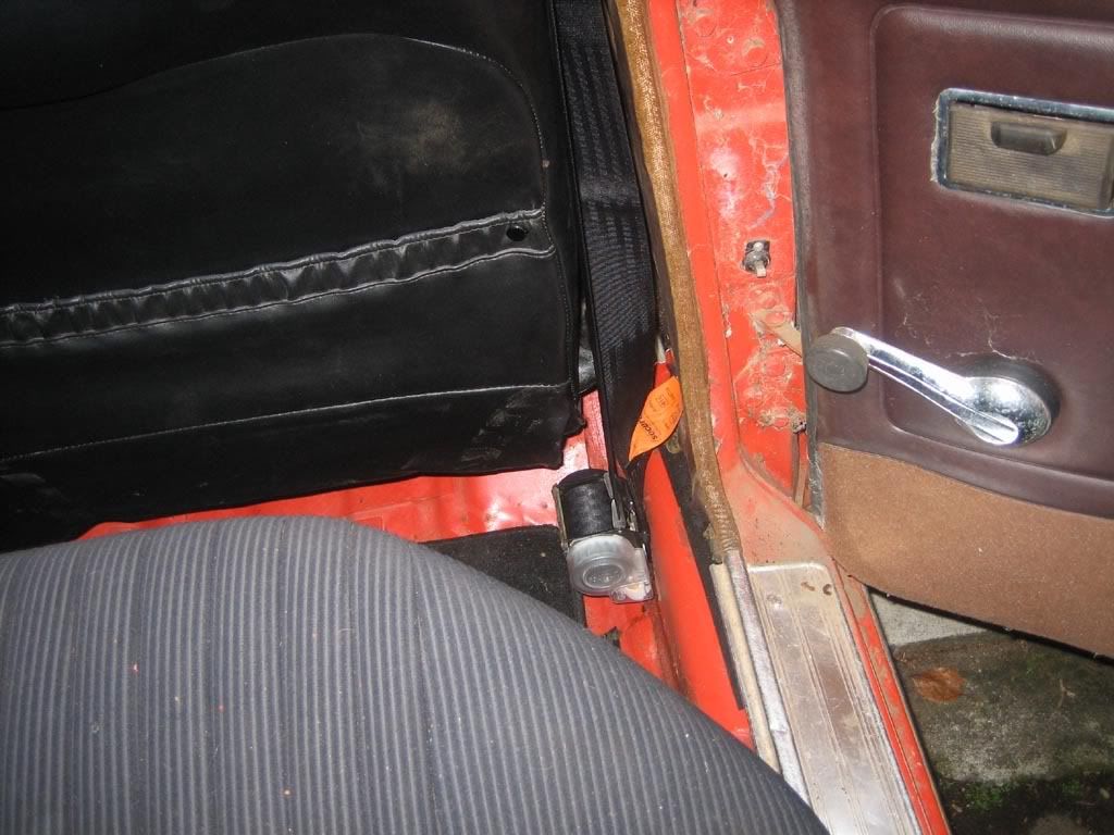

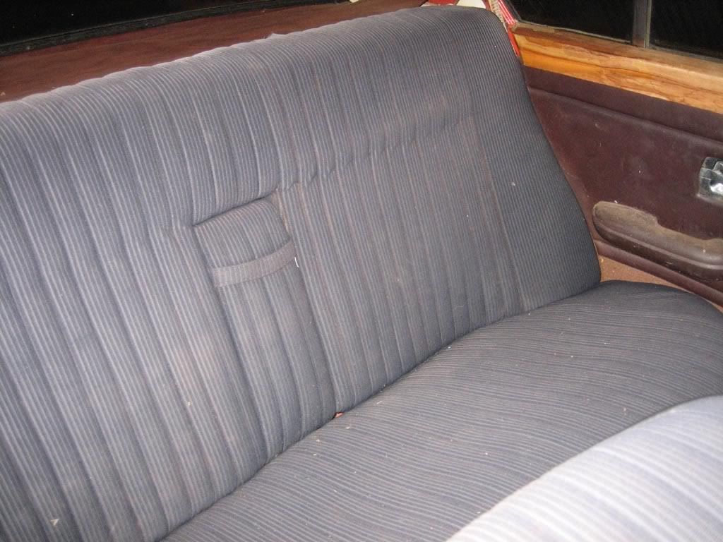

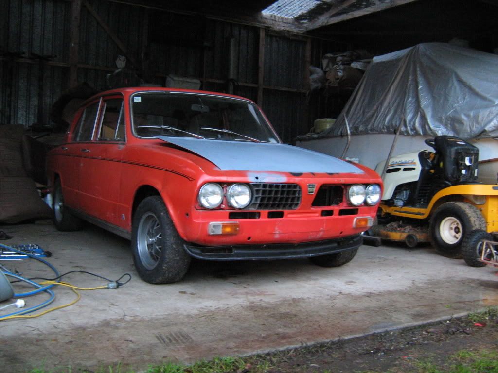

So here is what i did las night, with the seats, belts etc.
Bit ruff but much more usable for now.

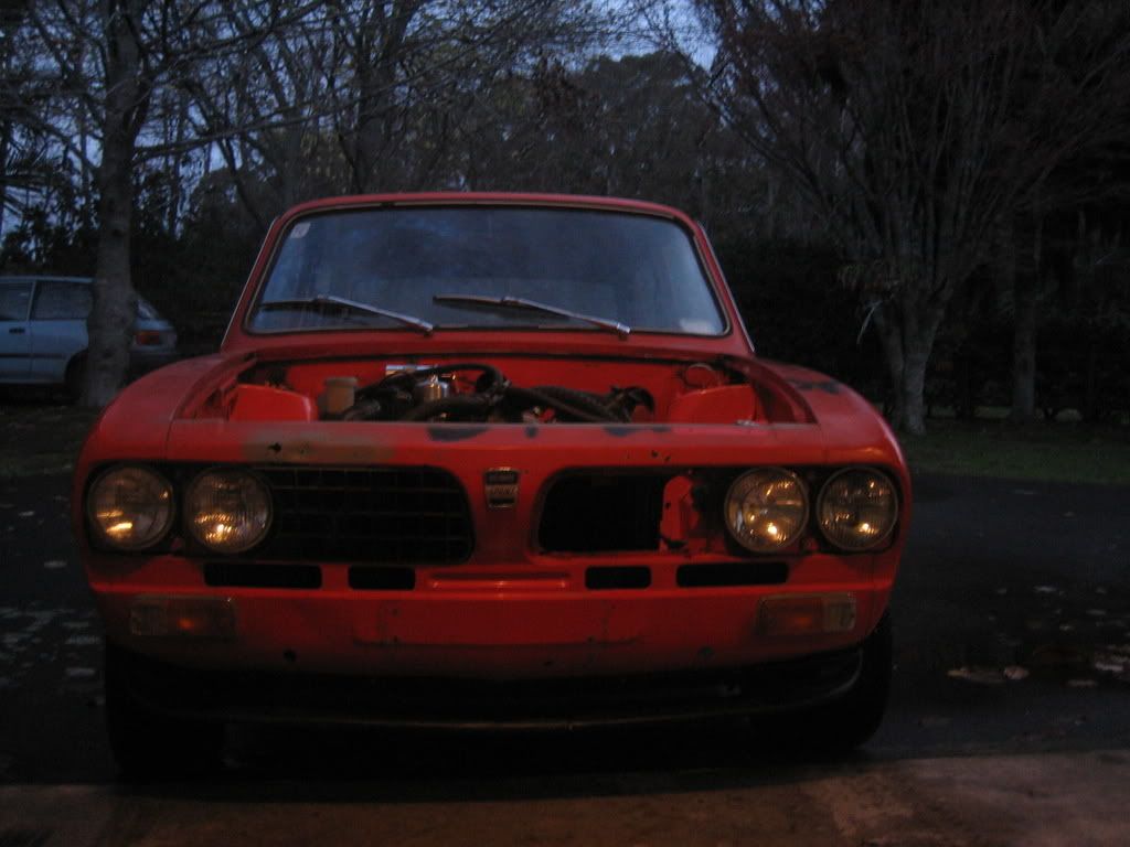

Think im almost ready to put the bonnet on.

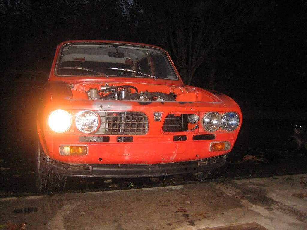

I bloody knocked my bonnet off the top of my car tonight and bent the thing, so ill have to try and get another dang it.

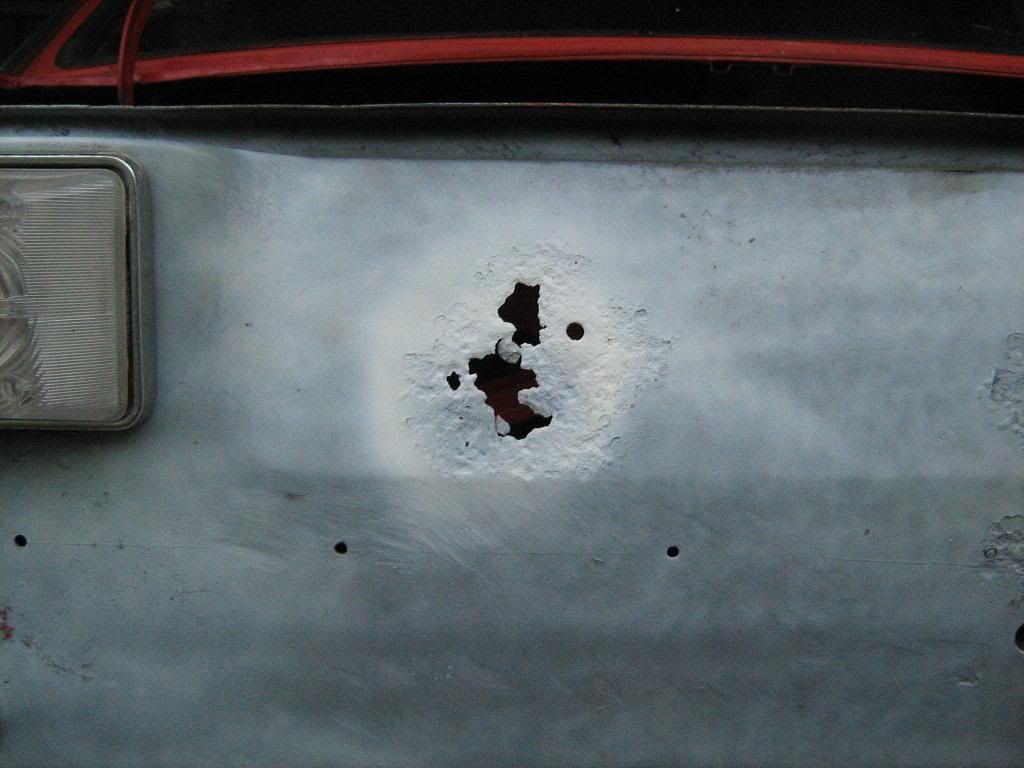

Some lights, and the one of the places that needs to be patched.
The angry front

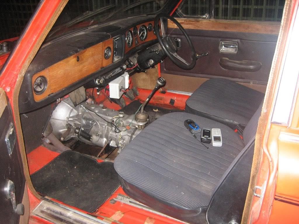

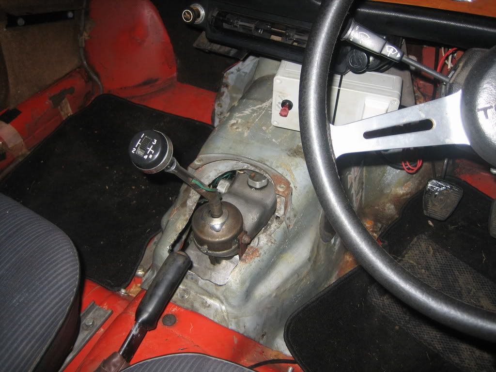

After that i decided i would see how the trans tunnel would fit up.
Wouldn't clearthe gearshifter, so i got out the grinder and cut a good inch or so out of it to make it fit.
Will have to weld some back in on the other side.
Also when i took the tunnel off i had to grind some of the bolts out.
So ill most likly have to rivet it to the firewall side which is a bit of a bugger.

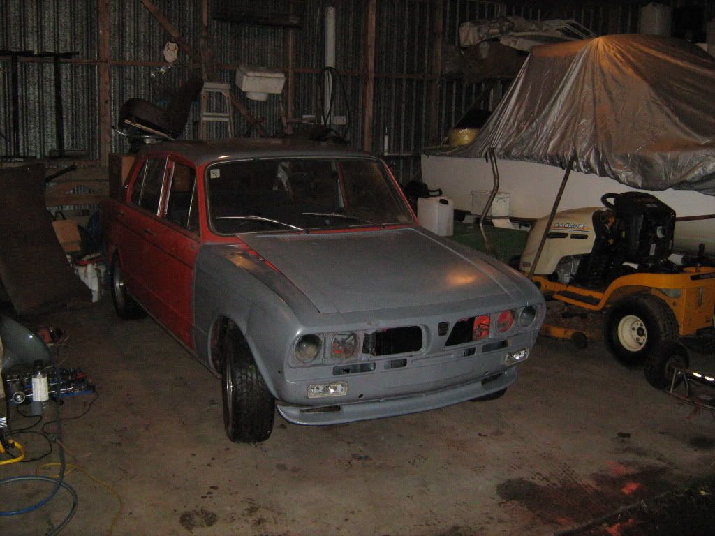

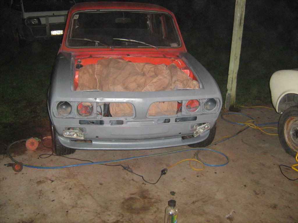

OK well
AS the body on the car has been changed i will need to change th Vin numbers over.
Save me from re vinning etc etc.

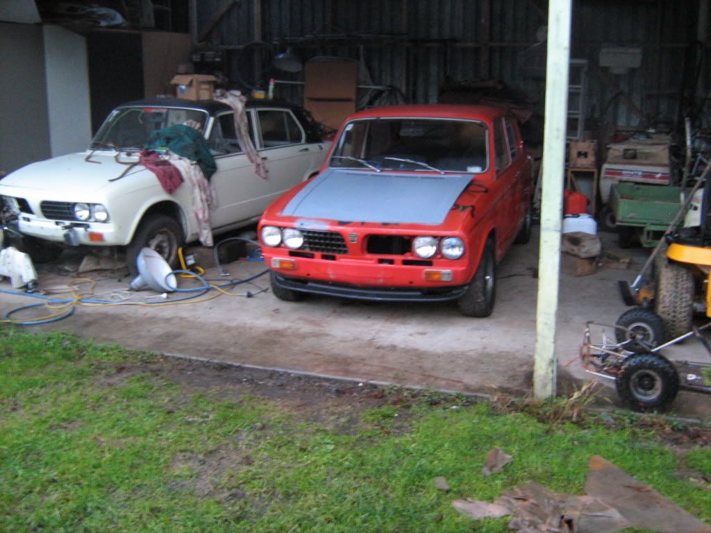

To make it less dodge i am going to just cheap spray the whole car in Primer, all one colour etc.

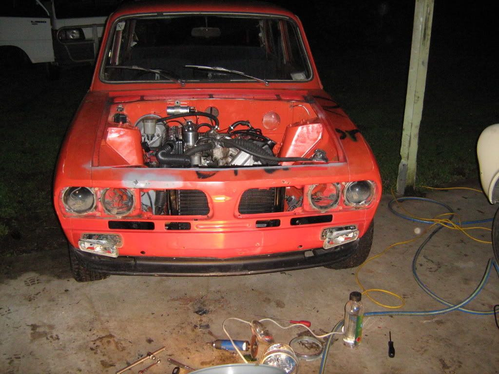

So after a boost round tonight in the wind were having at the moment I did all this
Pulled the lights off the front
Got the bolts out of the plastic grill that had rusted them selves in
rubbed the front panels down
rubbed the roof a bit
de waxed and greased
Ruff spray with primer
Some s##t weather otw to a job down whakatane
Later that arvo
Later that evening
Even Later
Sick
newguy

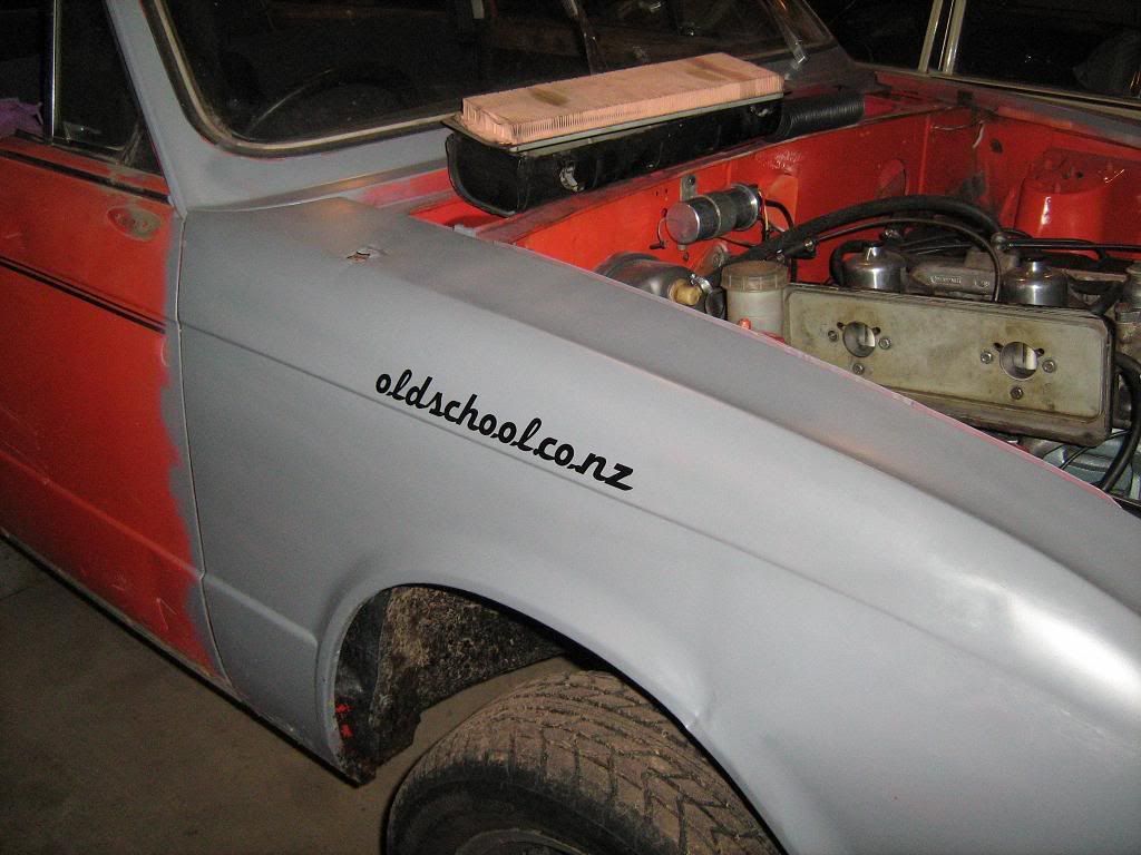

Re: Newguys Sprint Conversion
#177 Post by newguy »
Alrity
Spent the day on the car today well half of it after getting some more fire wood, cleaning around the car burning s##t.
Replaced all the fuel hoses that go between all the steel hoses etc
Replaced the fuel filter after getting ride of the small amount of s##t laxing out in the old tank.
Shortened the fuel hose in the engine bay, added a fuel filter on the carb side that should hopefully never get dirty
Retourqued the head
Went for a few strops up and down the road, Overdrive not working again, Bloody switch is being a real pain.
Then parked the car up in the clean shed with clean floors etc.
Jacked in up nice and high for my Bro in law to work his magic (hopefully coming Tues or Wed)
Removed the fuel tanks to check for rust under it, none to be found though which is mint!
Plus saftey while he is welding in there etc etc.
When i emptied the tank got to see if the fuel light works.
Which it does!
Man its great to have the original Dash Gauges etc all in there again.

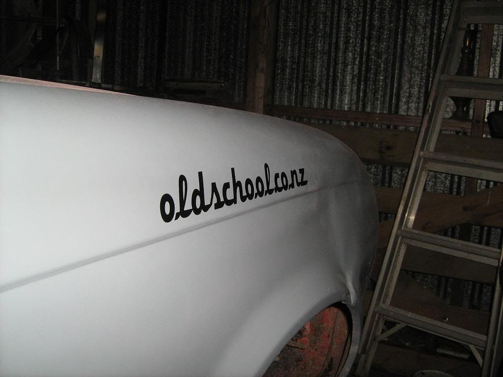

All so Put a Oldschool.co.nz Repn Sticker on just cause i can.

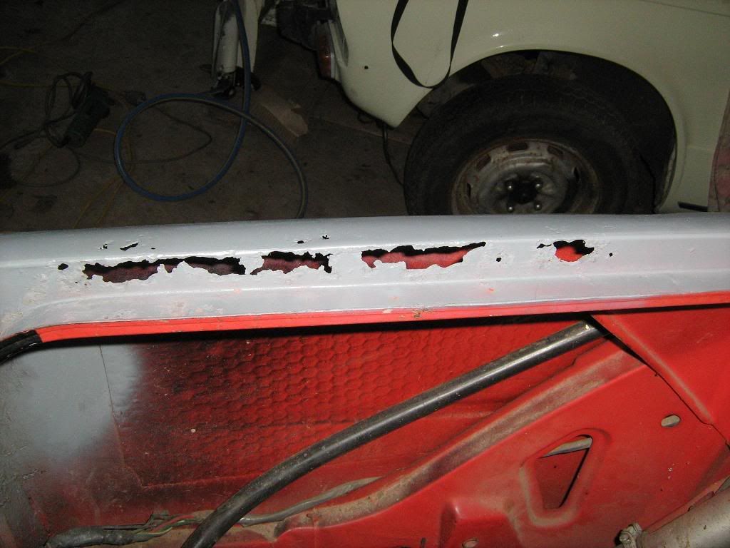

Great Guys
Sanded the rear end down, Till i found some bog on the left hand side on the bumper, just looks to be a bump etc.
Patched up s##t as, though the rear has a coupl of dings in it.
For now i think it will just get re bogged.

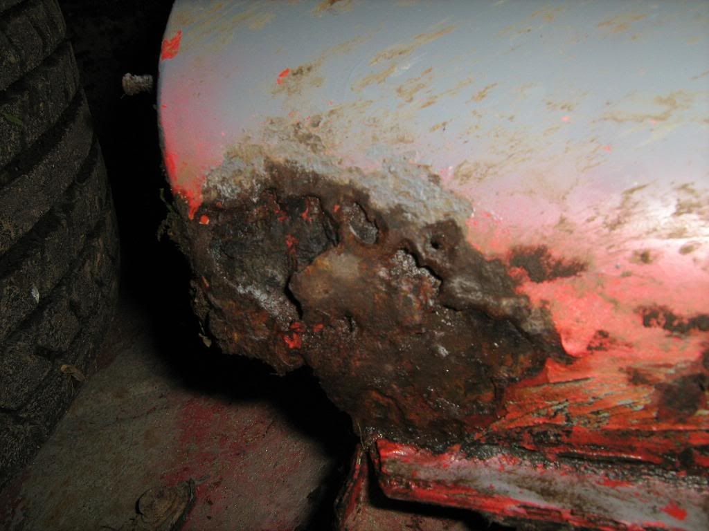

Worst of the rust after the Battery,Chassis Holes (That are already patched etc)
Rear Left TOp Wing
Rear Left Bottom Wing Just behind the tyre Looks Double Skind the metal on the other side still looks tuff and intact

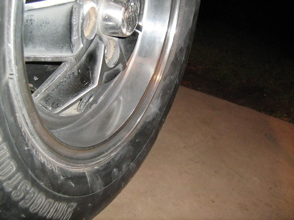

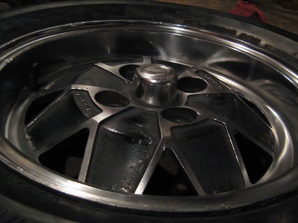

Well as i started to feel like i was getting a cold
I decided id try connect thespeedo up, but my cables to short.
Hopefully my overseas friends can help me out, or someone locally. (Hint Hint)

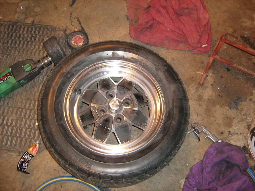

So i boored of that pretty quick, so i pulled a wheel off and had a go at plishing it up.
What i cam up with
Need to get a wider thinner disk and ill be sorted.
Plus some more AutoSol

#180 Post by Mad Mart »
Ah!, nice shiney wheels. :thumbsup: you just need to paint the black bits now. :D Reminds me, I have to polish a set for BFR.
