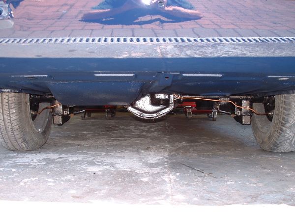

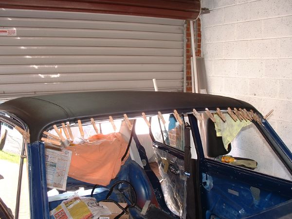

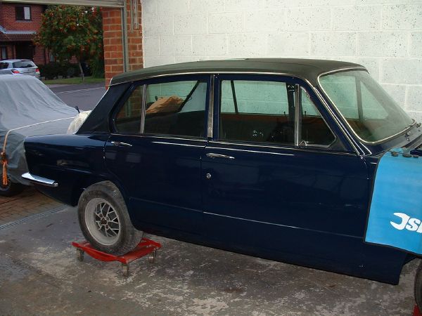

So first thing this morning I finished off installing the axle, which took twice as long as expected (it helps if you put the shocks on the right way round :roll: ).

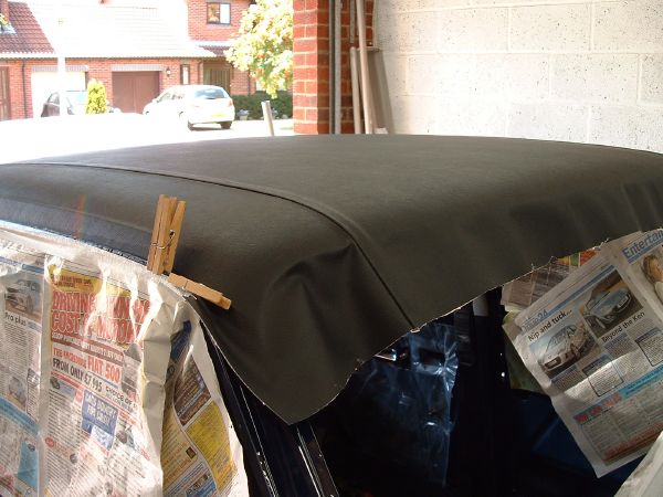

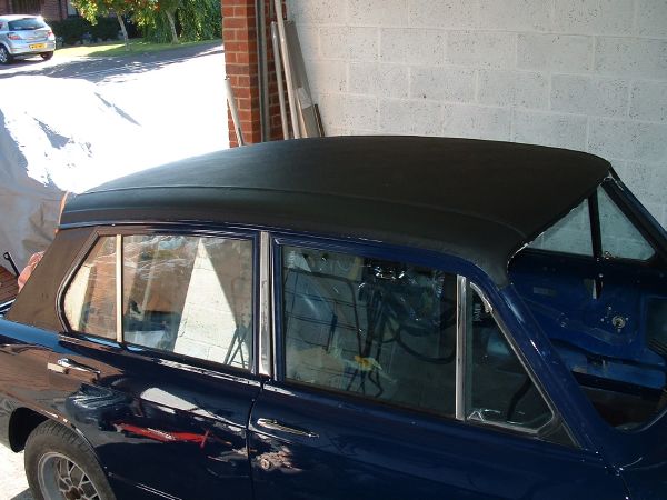

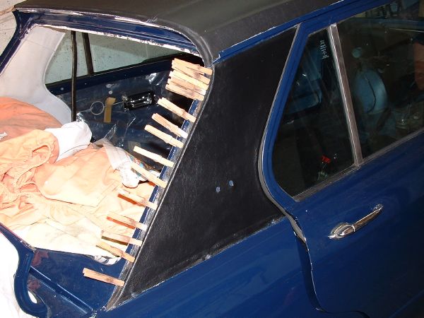

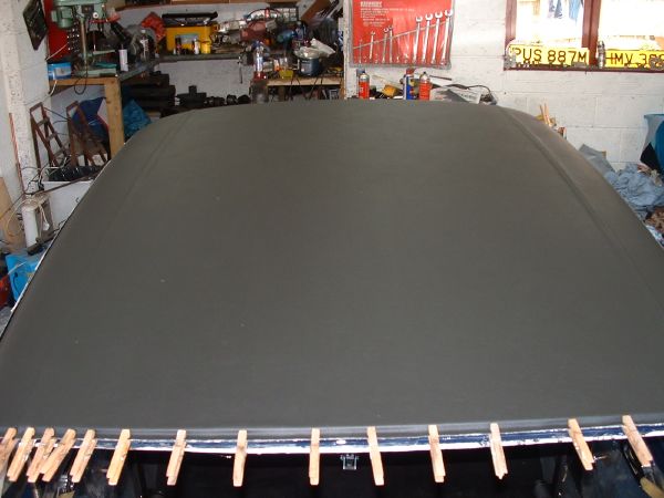

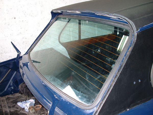

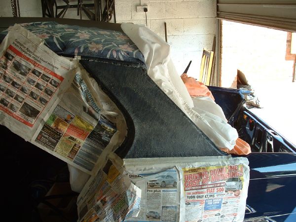

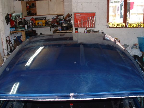

So then Mary & I started on the vinyl roof...
...and the 'D' post vinyls (many thanks to Grewham for those)...
I'm pleased with the progress we've made this weekend as all the major jobs have now been done. :D

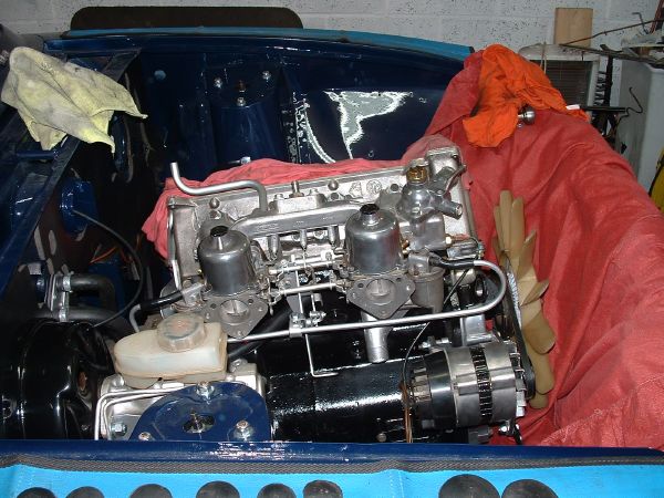

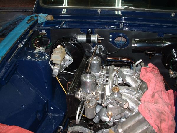

Fitted the carbs, alternator, fan. Doors are coming along nicely too.

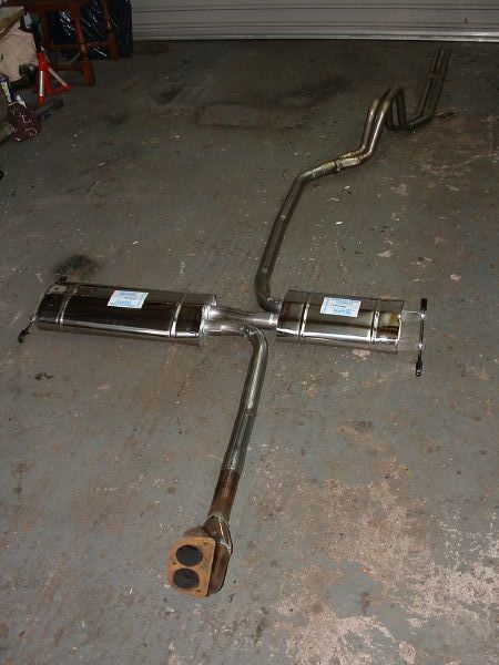

Ian wrote:(On the floor under the offside back door) you're not going to fit that Falcon exhaust to this car, Martin?

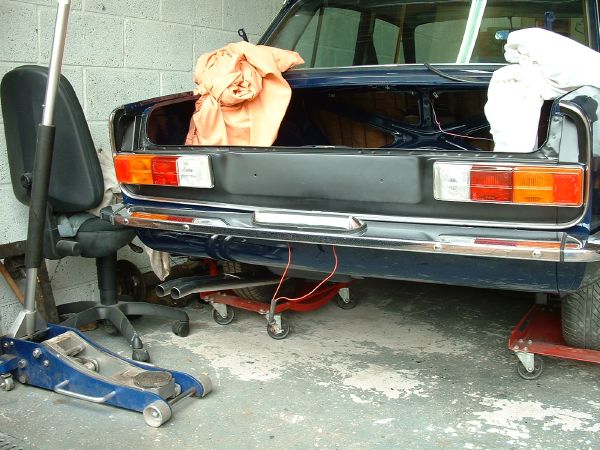

That was going to be the case until MikeyB dropped off a nice S/S standard exhaust earlier this evening. :wink:

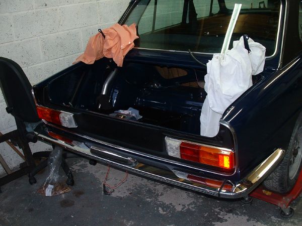

We've done quite a bit over the weekend although looking at it not a lot seems to have changed. I started to fit the fuel & brake lines under the car but found I didn't have enough clips, they should be here tomorrow. Fitted the handbrake mechanism and cables so it now has a working handbrake. Fitted the dash, rear windscreen, blower, fuse box, choke cable & other bits & bobs.

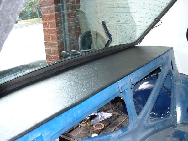

Mary made up the new rear parcel shelf...
straylight

nice parcel shelf Mary, well done :) That has to be one of my favourite jobs.

Mary thanks you Stu. :D

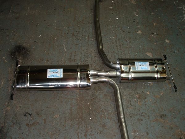

Here is the exhaust I got from MikeyB yesterday. I think it needs a bit of a polish but I'll leave that 'til the weekend. :woohoo:
I also fitted the engine stabiliser bracket this evening (the one that is held on by the exhaust manifold bolts). Some bright spark forgot to put it on before putting the engine back in so I had to remove the engine mounts & jack the engine up so that the front two bolts would clear the inner wing. :roll:

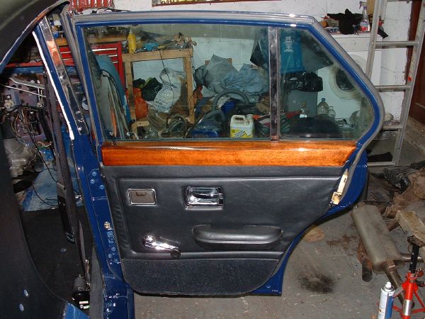

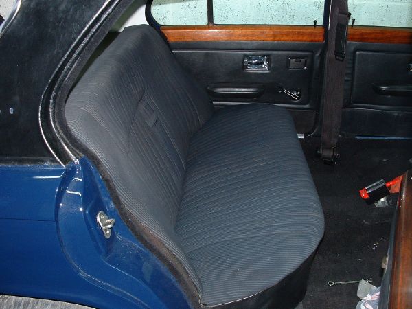

A few photos of progress to date. Finishing strip from Wins arrived Saturday so put that in (must update other thread). Rear seats in. Trim added. Rear bumper attached but I'd like to find a better one. A few more bits in the engine bay...

Is that a Stag seatbelt buckle? It looks like red release buttons to the back?
If so, it is the wrong way round.

sprint95m wrote:Is that a Stag seatbelt buckle? It looks like red release buttons to the back?
So if I turn it round the red buttons will be nearest the floor but the word 'PRESS' will be upside down, is that correct Ian?

I quite like the ones with the red buttons Mike. :wink: (which are now up the right way ie. upside down)

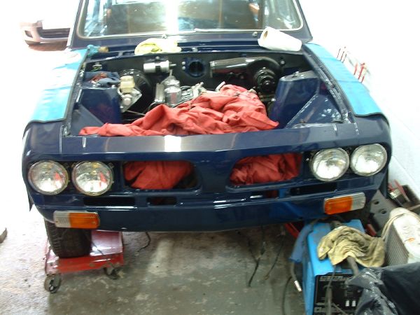

Started off fitting new pipe clips for the fuel & brake lines running to the rear of the car. Had to make up a couple of brake pipes as well. Then I fitted the brackets for the exhaust hangers. (remember this was a 1500 shell) Luckily I have my track Sprint to get the correct dimensions. Went to fit the prop shaft but can't find the special bolts for the flanges (well I found four). Fitted the remaining door trim. The first fluid to be added was the clutch fluid. I held the slave arm in with the bleed nipple undone whilst Mary filled the reservoir. I let the fluid flow through for a while until no air bubbles were visible, locked the nipple & pumped the peddle, jobs a good'un. :D Fitted the gearbox wiring loom, headlights & front indicators (even got them the right way round :lol: )

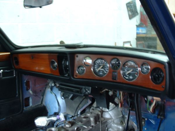

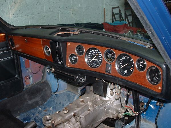

Gave the dash a good waxing, Took all the dial fronts off so I could clean the inside of the glass etc....

Lovely. Nice attention to detail there Mart re: dial glass.
