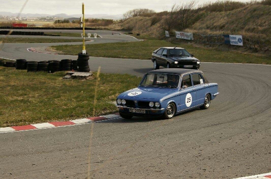

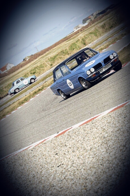

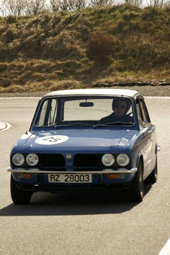

More in action pics.
It is way to soft with 170lbs front springs for trackdays, but don't going to do anything about it this summer.
When the winter comes, lot's of mods waiting.
Going for 350lbs front and 200lbs rear. Front is also going to be lifted about 1".
Antirollbar rear is going off. For the front im going to fabricate a heavy duty one.
This summer.......rock and roll driving sprint.
