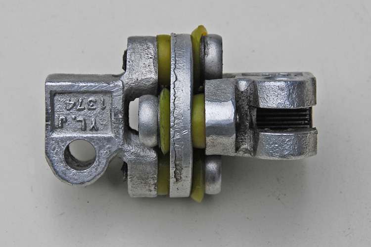

One of the problems with undertaking a restoration over such a long period as I have done is that you “forget” what the original set up was for items like the camber settings on the front suspension. Last week I discovered the camber on the right front wheel was out of specification.
The steering on this car has always felt slightly vague from the moment that I first drove it after putting it back on the road. I put it down to the fact that I had reused the original rack mount bushes. So when I removed the subframe and engine assembly back in May to investigate what turned out to be a broken valve spring I replaced the rack mount bushes with poly bushes.
There was no improvement. It took my mechanic son this week to spot the problem with me wiggling the steering wheel and him looking and feeling for the problem. It was the lower steering column joint. The new rubbers which I fitted some years ago to the joint, and which sat unused on the shelf before I refitted it are clearly not up to the task. A quick search on the various threads on this forum showed that the alternative is to fit poly bushes or to replace the coupling with a proper “Hookes” type universal joint.
I have managed to locate some poly bushes here in New Zealand.
210131214-4555Ptw Dolomite lower steering coupling.jpg (133.14 KiB) Viewed 4274 times
The Auckland Lotus service agent carries them for they are also used on some Lotuses. They are a little thicker than those which I replaced and a couple have distorted when I tightened the screws which hold them.
I noticed a very slight feathering of the outer edge of the front left tyre so I had the car front suspension checked by an alignment specialist. It took some time for Stuart at Mag and Tyre Direct here in Christchurch to locate the set up information for the Dolomite range – it was not on his computer database. He went to the website http://www.vitessesteve.co.uk/PDF/Dolomite_Sprint.pdf where he found a copy of the factory workshop manual and the information he required. It was interesting to note that the information he downloaded was more comprehensive than the issue (1) I have of the brown covered factory Dolomite Sprint workshop manual.
He carried out a detailed examination of the car and we finished up fitting one extra shim pack to the right front wheel. This has brought the wheel camber measurement back within the nominated tolerance.
I was impressed by his thorough and patient manner and I can report that the outcome is very satisfactory. His measurements showed that when Brian had joined the two halves of the car together he had done an excellent job.
The car tracks straight and true and the fitting of the poly bushes to the lower coupling has transformed the steering. It feels as good as any modern/new car now.

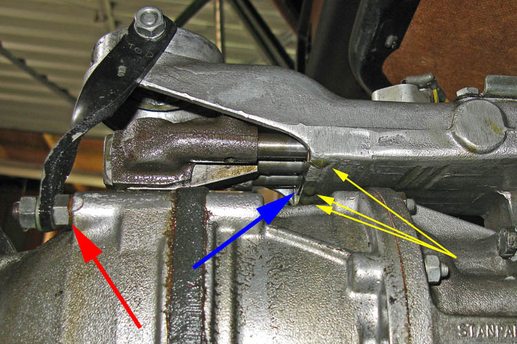

The world is full of wits who will tell you that all British cars leak oil. Perhaps they are right but the oil leaks which have plagued me since I restored this car were more than oil leaks. At times I thought they were gushing oil – for they seem to be all but filling the drip trays in the garage.
Right from the outset of the completion of this restoration there has been a substantial oil leak in the vicinity of the gearbox. I now have my fingers crossed that I have eliminated it. In fixing the major leak I unmasked two more. All of which have now been fixed. And for the first time ever I have been able to go out to the garage, roll the car back and see a clean floor.
In this first photograph I have highlighted two of the three oil leaks. It was taken in the car.
20140112-0506Ptw Oil leaks on the gearbox.jpg (134.96 KiB) Viewed 4191 times
The yellow arrows show the drops of oil forming below where the gearbox selector rods come out through the back of the gearbox top cover. In desperation, after taking this photograph I fitted a spare four speed cover to the gearbox (no overdrive switch to allow overdrive on 3rd and 4th gears). Earlier I had tried changing the o-ring oil seals which sit behind the seal cover plate and which is highlighted by the blue arrow. Changing those o-rings was not successful. The fitting of the four speed cover eliminated those oil leaks but it did not stop the flow of oil onto my garage floor.

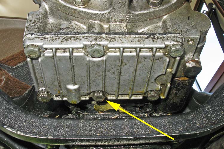

I discovered two more leaks. One was coming from behind the copper washer which is visible behind the red arrow (marked in the photo above) and the other leaks – there were six of them, were coming from the bolts holding the inspection plate on the bottom of the overdrive unit, one of which is marked in this second photograph.

I had taken the gearbox top cover off the gearbox a number of times as I have changed the selector rod seals and I have obviously disturbed the seal formed behind that red arrow. That has now been sealed with ThreeBond gasket sealer as have the six bolts on the overdrive inspection plate.
I should have realized that these six bolts on the inspection plate were a likely source of an oil leak for although I fitted a new gasket to that plate after I had cleaned the filters in the overdrive, those six bolts pass through into the filter chamber and are held captive by little star washers – which provide no sealing whatsoever. The bolts of course sit at the very bottom of the gearbox.
I have cleaned the bottom (and the top and sides) of the gearbox since that second photo was taken and have been checking regularly to ensure that I have eliminated all the oil leaks.
I have now replaced the four speed cover I fitted as a temporary measure with yet another four speed cover with the necessary overdrive switch fitted and it seems to be oil tight.
I had assumed all along that all the oil was coming from those leaking selector rod seals. This exercise has reminded me, once again, that it is often a process of elimination and that some patience is required to fix these various problems. Patience which has been amply demonstrated by the trials and tribulations that Howard81 and MikeyB have exhibited elsewhere in their restoration threads.
