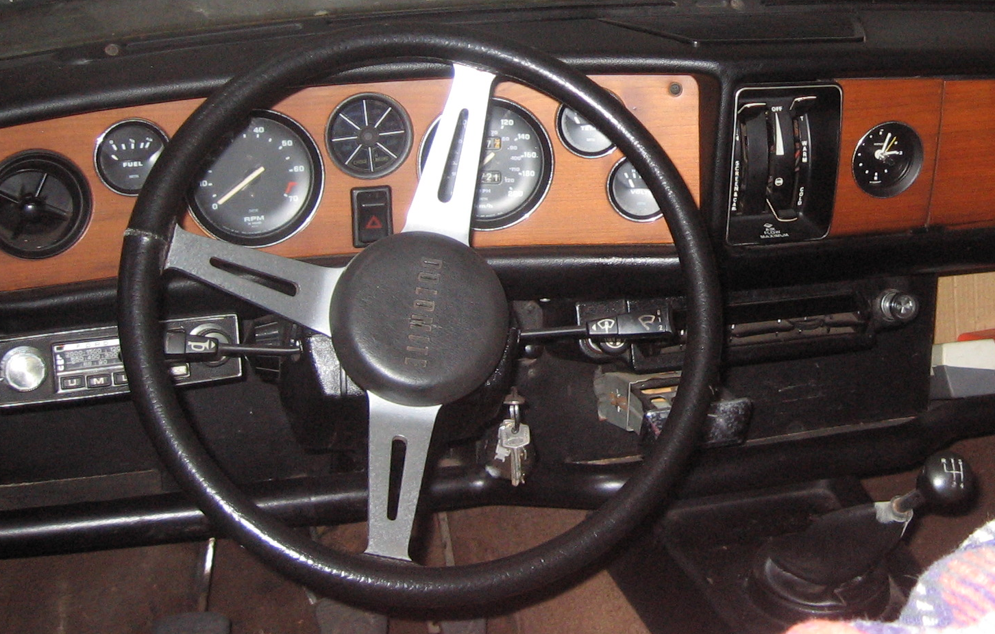

The indicator stalk looks like it is for an LHD car. That would explain the "upside down" positioning.

That's what I thought but they are simply moved to the other side, (Morgans use the same indicator stalk!)The indicator stalk looks like it is for an LHD car. That would explain the "upside down" positioning.

Nope.... LHD dolomites have the stalks reversed, indicators/horn left, wipers on the right. The bend goes the other way, and, the way these are mounted around the steering column also means they cannot be swapped to be used "upside down" on a RHD car.
- LHD_steeringcolumn.png (1.95 MiB) Viewed 1893 times

Thanks Tjakko, I stand corrected!
On the rhd Morgans you have to bend them out a bit more because they hit the dash, that's what they did in the factory amazingly!!
The bend wasn't the opposite way so I just thing that there's a whole batch of incorrectly manufactured ones lurking around, I wasn't happy with taking it apart and messing with it so I have just ordered the correct one.
