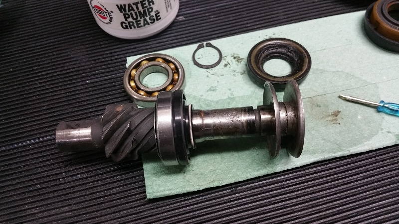

The pump oil seal is free to ride up and down the spindle...and the flinger disc MAY do but usually grips on the small diameter change/
The fact its free is a good sign.
The underside of your impellor is the crucial thing if you have a graphite type seal. The impellor MUST be a tight fit on the shaft and be gripped by the splines. They do go loose and can spin...in which case a roll pin CAN be used if you are careful and good with with a pillar drill.

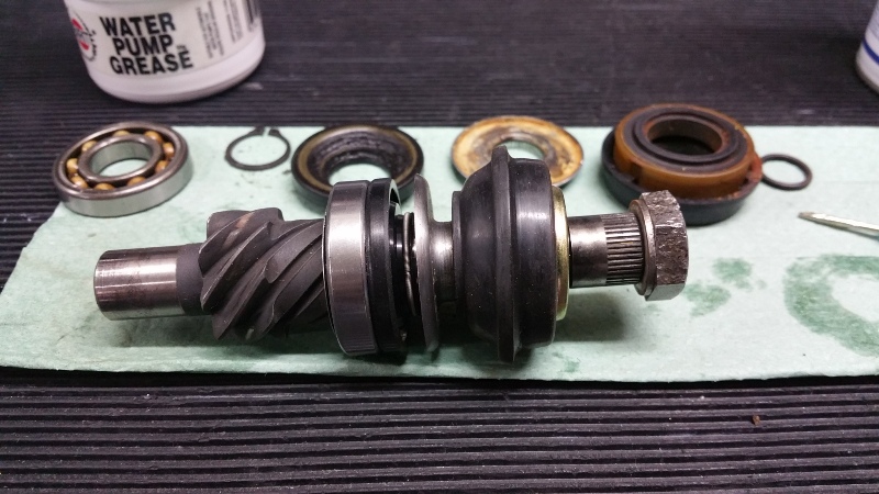

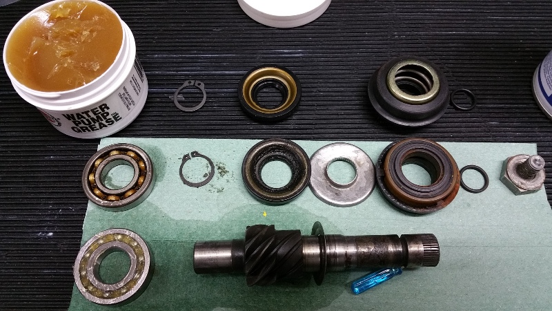

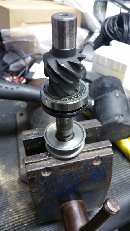

Dismantled the water pump shaft this morning,
and put some grease into the bearing.
Also put some grease onto the shaft where the bearing sits, may be wrong, and I dont think
after pushing the bearing on there's much left under there.

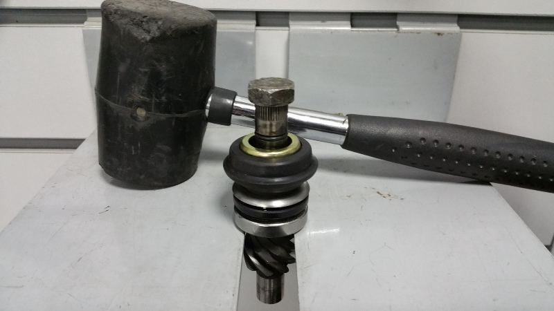

The new water flinger was tight and I didn't want to warp it, after looking around for items
which would fit over the shaft and be tight on the new flinger collar, I realised the best way
was to use the old flinger, which I inverted and put over. This allowed enough hand pressure
to insert the new flinger up to the O ring shaft.
I used the vice only as a means of support on the old flinger, and rubber malleted the shaft.
Easier than I expected, and no shaft damage or new flinger damage, only had to make sure
the shaft stayed vertical and soft taps.
Put it all together for now.
I more worried in case anything is in the wrong way round and if I have put the bearing and
flinger in far down enough, the score marks do seem to line up.
Impeller is to go on later.
Also I forgot to take pictures of how I removed the bearing, so I took a shot afterwards.

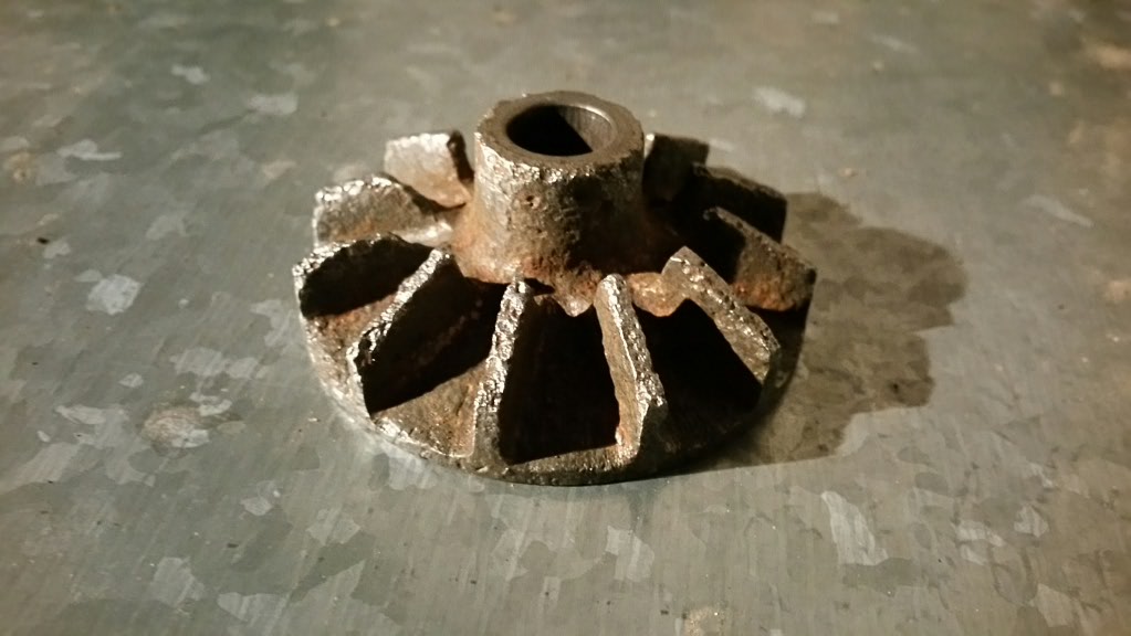

Still not convinced on the condition of the impellor,
I think 2 decades of long term storage without draining
has taken its toll.
More worrying is, a bit more wear in the right place, and it will be in pieces.
has taken its toll.

Also I have found a cavitation reducing coating, I'm sure none existed 10 years ago, it's called Belzona 2141 (ACR-Fluid Elastomer) takes 48 hours to dry at 25°c.
Apparently it reduced a boat propellor monthly change to over 13 months service, in our cars probably a lifetime.
Now need to find a source and price, I'm not in the boat world, so an Internet trawl it is.

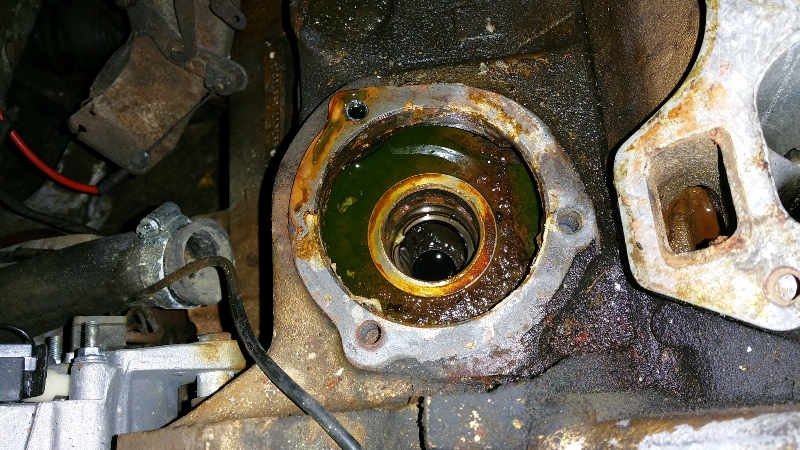

Brass cage removal.
First attempt, FAIL, tried to freezer spray the brass cage, but it was pretty cold this morning, and the freezer spray only goes down to -55c.
Second attempt, FAIL, tried to lever the cage out without damaging.
Third attempt, I know it will not come out easily, and that I am going to get hurt using conventional methods, as I dont have a slide hammer
or specialist tools.

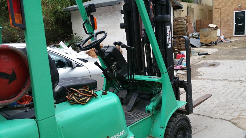

Used a 1 3/4 bolt, wrapped some webbing around it, and inserted into and across the underside of the cage, making sure the webbing covered the whole bolt.
The rest is better explained in the picture.
Slowly lifted, wheels nearly off the ground, as I was taking a look, a ping sound, the cage flipped and fell to the ground under the car, as opposed to flying off
for a half mile.
Tools used, bolt, webbing, forklift.
for a half mile.
