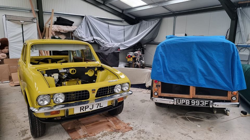

Anyway here's a few photos for you:
Period numberplate, needs a gentle bend added to fit the front panel, I used spacers & double side adhesive to fit it.
Headlights fitted up, with 75W inner sealed beams
Bought a lovely set of early carbs & manifold off ebay
Front Bumper Fitted
NOS inner front wing baffles powder coated, new seals & fitted.
Will try to update this a bit more regularly. :thumbsup:

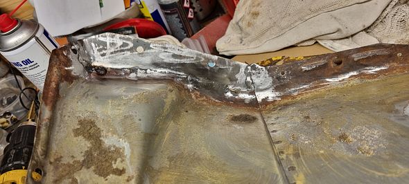

Small repair to the original early type gearbox tunnel. Will send it away for powder coating now.

Tony Burd wrote: Sun Feb 04, 2024 11:50 am Small repair to the original early type gearbox tunnel. Will send it away for powder coating now.
Did gearbox tunnels have any protection on them, paint?
Re: New Project VA485 - RPJ 7L
Posted: Sat Feb 10, 2024 2:05 pm
by Tony Burd
I think they were zinc plated, still rusted unfortunately. I getting it powder coated gloss black for protection after all it's not on show.

Tony Burd wrote: Sat Feb 10, 2024 2:05 pm I think they were zinc plated, still rusted unfortunately. I getting it powder coated gloss black for protection after all it's not on show.
How do you tell an early gearbox tunnel ? I had my gearbox tunnel powder coated red but they did it the wrong red it came out post box red, but I've stuck sound insulation over it now

new to this wrote: Sat Feb 10, 2024 5:35 pm
What seal are you going to use, gearbox tunnel to car body ? i bought a u type seal to fit over the lip and are planning to bolt through it
The early tunnel doesn't have the fixings for the coin tray around the gear lever and I think the heat shieldisa different fixing.
I will probably use a 5mm thick closed cell self adhesive foam.
