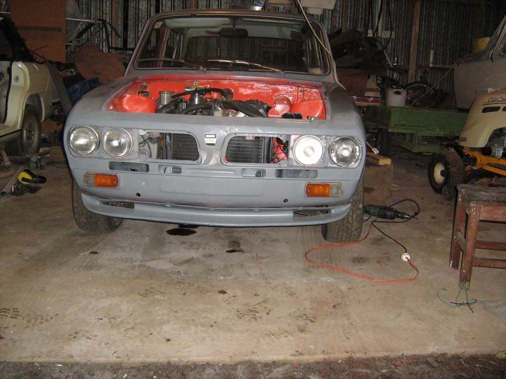

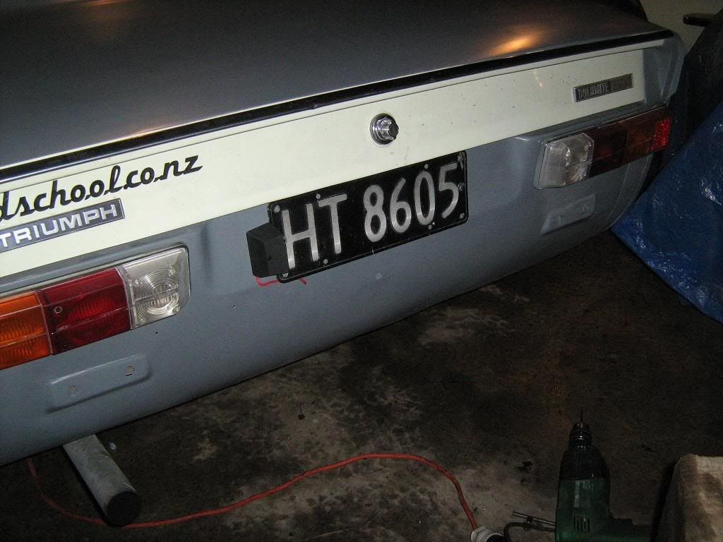

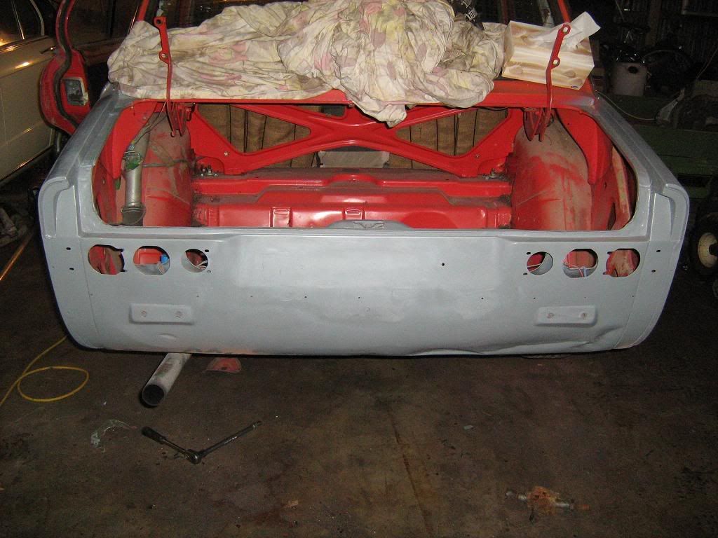

Few Pics

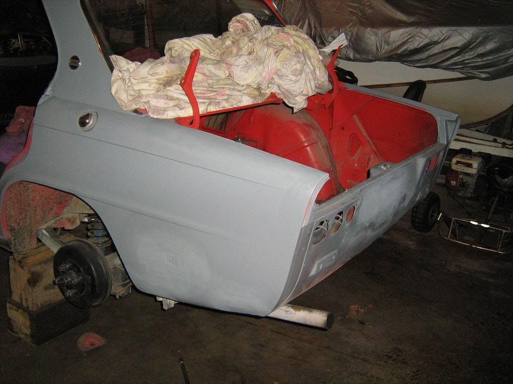

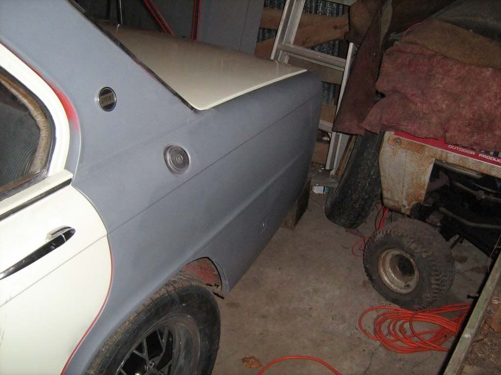

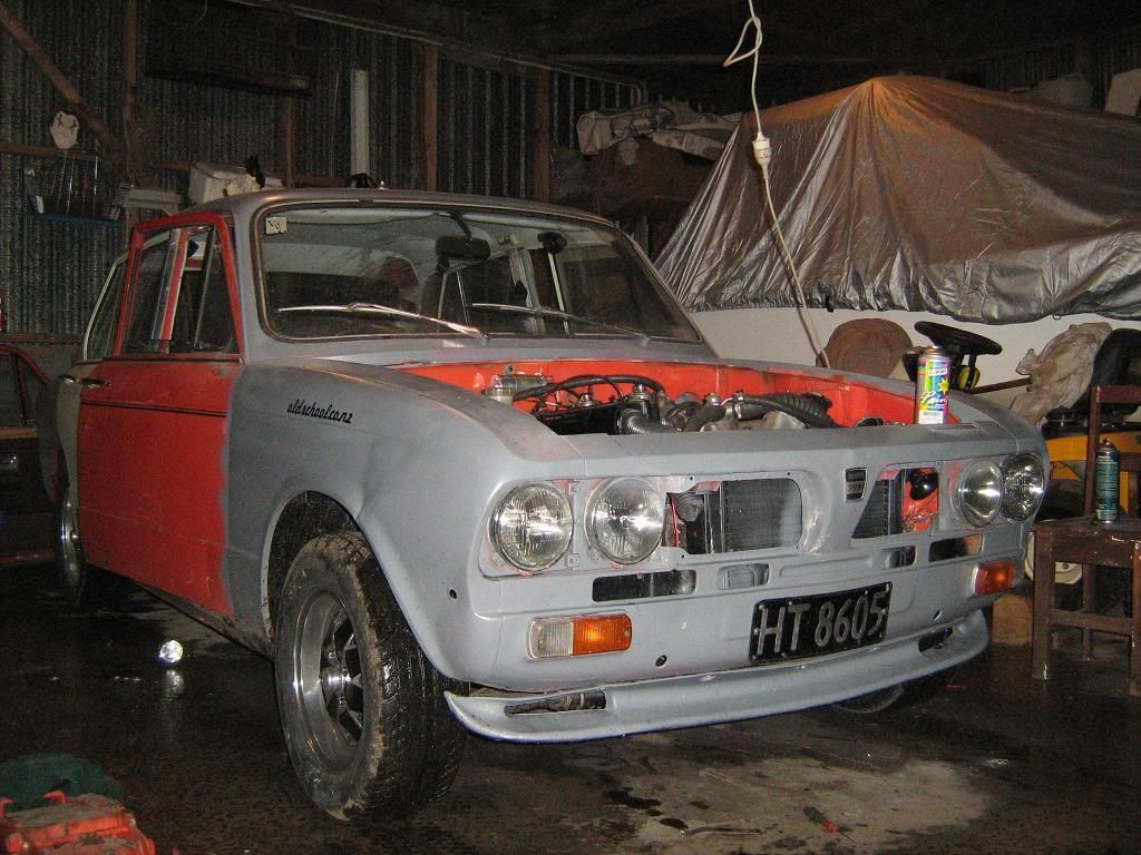

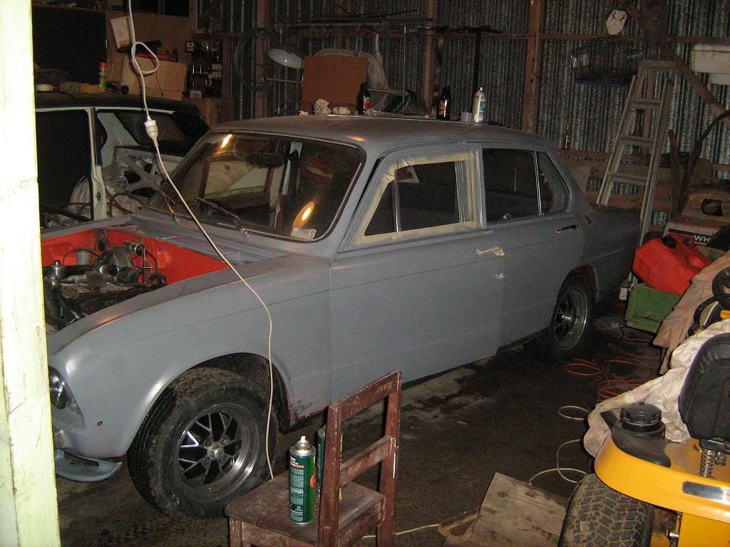

Hauled arse on the car tonight. last night and the wee hours of this morning.
What i got done,
ground down some patches and primered and undersealed
Fixed zaust leak
Attached plates
Attached and wired rear plate light
Attached chassis number
Got petrol gauge working on the new sender unit
Got front left indicator and driving light going

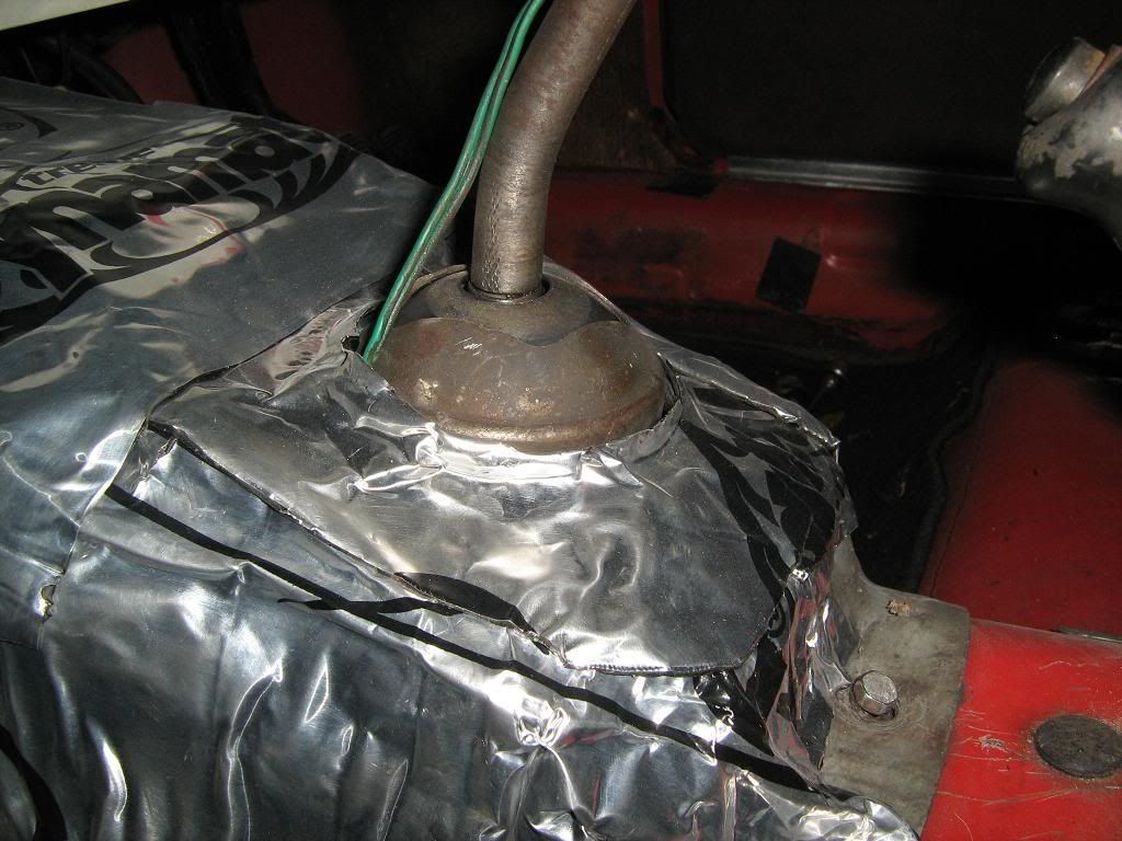

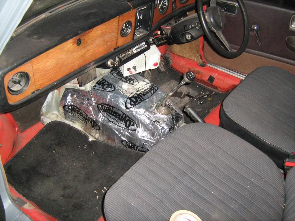

Patched gearbox tunnel hole, and covered in dynamat to make it look tough and tidy, it
Also stopped a hell of alot of noise, Box, engine, road etc and the draft from there is gone
Positioned the passenger and rear doors
Primered Passenger side doors, ran out of primer
Primered inside of all passenger doors
Primered boot
Found Gearbox mount washer thing stopped a hell of alot of gear box movement after fitting that
also.
Gunna get some more primer tomorrow morning first thing and get stuck in yet another weekend.
Bang
