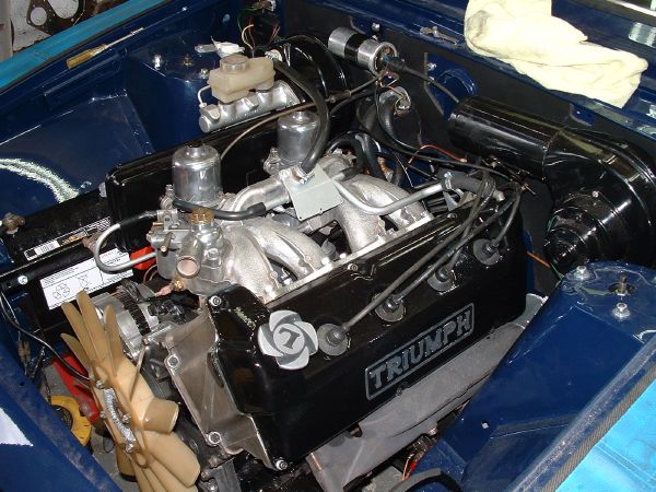

After checking & double checking everything, I filled the engine with oil & used a leccy drill to pump the oil round via the hex oil pump drive. I then refitted the dizzy which was now complete with leccy ignition. I then cranked the engine over to further get the oil distributed & make sure there wasn't any obvious nasty noises. Finally I fitted the plugs, dizzy cap & leads and cranked the engine again. I checked for a spark & that was fine so I then had a look at the ignition timing. With Mary cranking it over I got the strobe on the crankshaft pulley. It was on 12 deg. BTDC which wasn't bad as I'd only set it up by eye. Anyway I set it to 10 BTDC. I then remembered that I hadn't put any fuses in :roll: Cranked it again but still it wouldn't start, so I sprayed some quick start juice in the carbs and it did fire a few times but failed to run. So I thought it must be fuel. Took off the float lids and sure enough no petrol in them. After topping them up I then tried again and bingo, the engine ran for a short while until the fuel had been used from the float chambers. Looks like the fuel pump isn't doing what it's supposed to do so I will be on the phone to Fitchetts in the morning to order a new one.

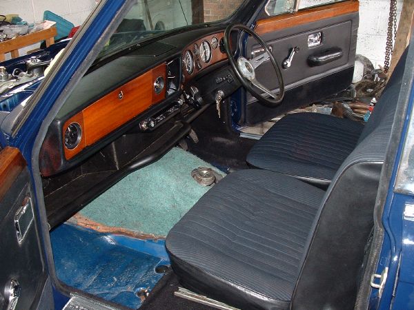

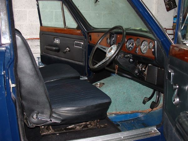

Apart from getting the engine started we have now put the majority of the interior back in, Tunnel, parcel shelf, front seats. The bonnet & boot lid arrived last Wednesday so they are lying patiently on the spare bed ready to be fitted.

#198 Post by Oli_88 »
Is it just the lighting in that picture, or are the dash/glovebox/door cappings a darker shade to normal?
Looks good...
Purplebargeken
Re: Project PUS (Sapphire Sprint)
#199 Post by Purplebargeken »
Oli, to me the glovebox veneer looks lighter. Probably just down to flash, etc. All looks good though.
#200 Post by Oli_88 »
In one the glovebox looks lighter in the other... it looks lighter too... :oops:
Scratch that.
But yes, it does look very good.

Has the pump been off? Its very easy to refit it with the lever missing the cam.
Winns have a good deal pumps last time I bought one.

Door cappings were done by Mary. They were stripped of all the old varnish & then given 3 or 4 coats of clear gloss yacht varnish.
The dash I got from MikeyB and it is a bit darker than normal. The glove box door is however a bit lighter for some reason although it is a match for the surrounding wood.
Jonners, yes the pump has been out and was replaced on the cam. After last years problems with THJ I'm not faffing about with an old pump so have ordered a new one. :D

Fitted the new fuel pump this evening and let it tickover for a couple of minutes. :D
All the lights are now working, slight dodgy connection on the l/h front indicator which I need to sort out (connection just needs cleaning up). I had to dismantle four of the bulb holders in the rear clusters to clean up the earths(returns). What a crap way to connect something. :roll:
