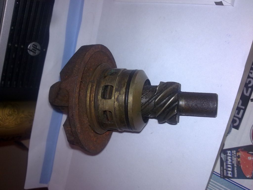

I was going to re-use the brass cage, but after a cleanup, there is chipping evidence internally, most likely bits from the impeller.
Thanks Jon
I'll check the bush with a finger, if it's smooth, it stays.
looks more like damage from removal attempts to me.
The impellor should never come into contact with the cage.
If it has good O ring seal points and the bearing will fit it looks ok to me...
if the pump is apart you can check the bush fit with the pump spindle..if it wiggles a lot change it.

It's a bugger to get out, I tried everything then resorted to using a small drift to bend it enough so I could pull it out. Mine was worn though.
I will check the pump to cage fit Jon, but the damage on the cage uprights were not done by me, I only levered the cage from underneath, the chips are on every upright and all roughly the same.
I summised the same that there should be no contact, and the vane deterioration is on the top, unless ground bits got down, or there are foreign objects coming up?

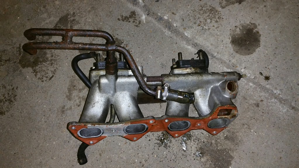

As there is now a wait for some spares, I removed the carbs from the inlet manifold.
Just as well, during a bit of cleaning, I came across this,

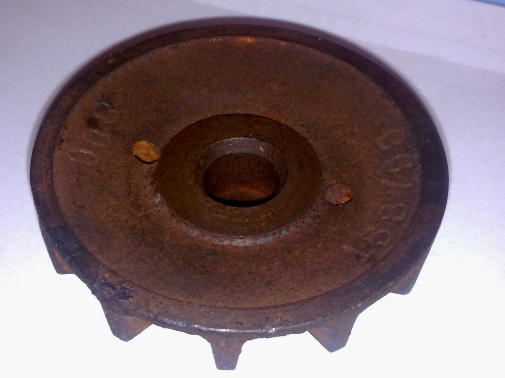

Right, I was right and wrong, the 12v impeller is loose and the pump has the 6v impeller on it!

The pump is obviously used but the brass cage looks OK (what I can see of it)
The 12v impeller is probably used but seems in good nick.
£20 for the 12v impeller (including postage) or £35 for the pair (they are heavy)

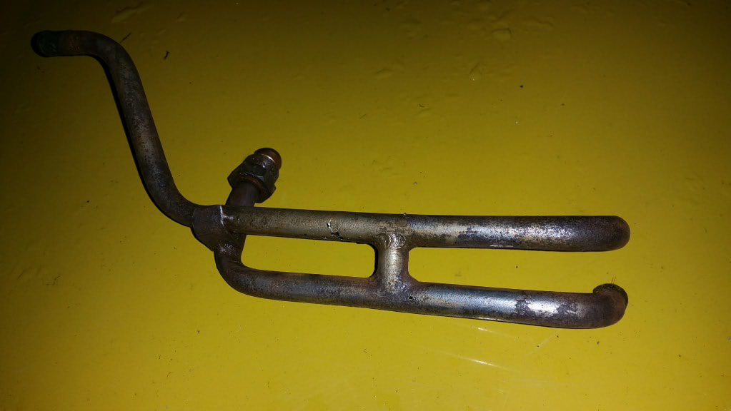

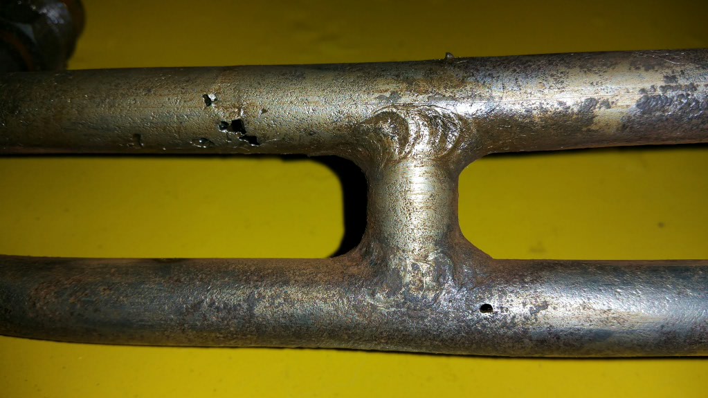

PPS, just seen your latest post, think I have an H pipe too, will have to check. OR Chris Witor does new ones in stainess!

I had already ordered the stainless pipe from Chris Witor before you put up the post, don't spend time looking on my account.

Mahesh,
Your water pump saga is well timed as i'm just doing mine and like Jonners have done a few before.
A couple of things though, check you have the graphite seal on up the right way as from your photo it 'appears' as though you have the steel casing facing upwards towards the underside of the impeller. One you pop it all into the brass cage it all becomes 'solid' and runs ok....but, you are in the same position I was, where the cage stayed in the block when you pulled the pump out.
A tip is to drop the pump drive shaft with its bearing on into the brass cage first. If it won't go in (as mine wouldn't as I also used a replacement cage) heat the cage up a little first, then drop the shaft & bearing in. Then once well cooled you can fit in the rest of the bits (seal and flinger) before pressing the graphite seal into place.
I think I've been fortunate in that the underside, mating face of my impeller is in pretty good nick so am just going to lap it slightly tomorrow, but most would advise a fine skim in a lathe otherwise the seal will still leak when you put it all back together.

I'm waiting for the impeller from Steve at the moment, mine is seriously worn, corroded, and chipped all over.
I got the brass cage out Saturday, (the forklift is pretty good, no damage to the cage at all) but the cage is
chipped internally all round, in the rotation of the pump, which leaves me to believe that some of the impeller
had got in there.
I haven't done the final assembly yet, and will turn the seal over, once I have the replacement impeller and
new cage. Once a check is done as to how it all fits together am I'm satisfied that all is good, I plan to clean
out the shaft in the block, (there's bits in there) followed by cage insertion, shaft with bearings, and lastly
impeller and nut, then comes the clearance checking, the old gasket was a very thin one, with dollops of
gasket seal everywhere.
