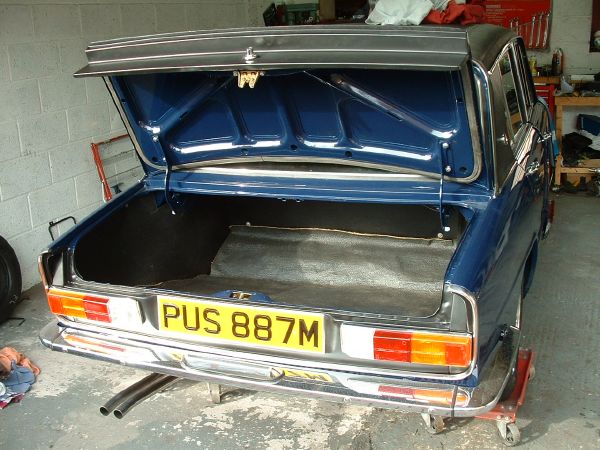

Is it that a new seal is making the boot a tight fit and you can't compress the lid enough without it bouncing back ?
If it is , i had a similar issue with my Chevy. In the end i carefully pushed it hard until it clicked shut and then left it for about a week. When i opened it the next time and then closed it, it was much easier and each time i left it, it got easier again.
Just make sure you don't push so hard as to bend the panel or damage that nice shiny paint.

Re: boot lid rubber: We took the rubber back off & compared it to another I have. The rubber we just removed is quite solid compared to the other one, so we put the other one on and now the boot lid closes.

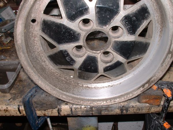

After purchasing a new drill yesterday I finished polishing the 3 remaining wheels (not just the rims
) this afternoon...
Just started, using 180 grit...

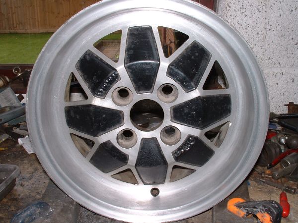

...stage one finished with 180 grit...

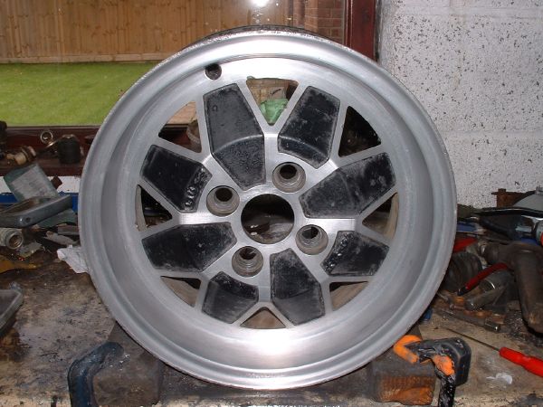

...stage two finished with 1000 grit...

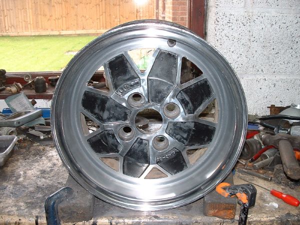

...stage three polished...

Re: Project PUS (Sapphire Sprint)
Don't want to do my compos do you?
They look great, surprised you get such a good shine after going straight to polish from 1000 grit.

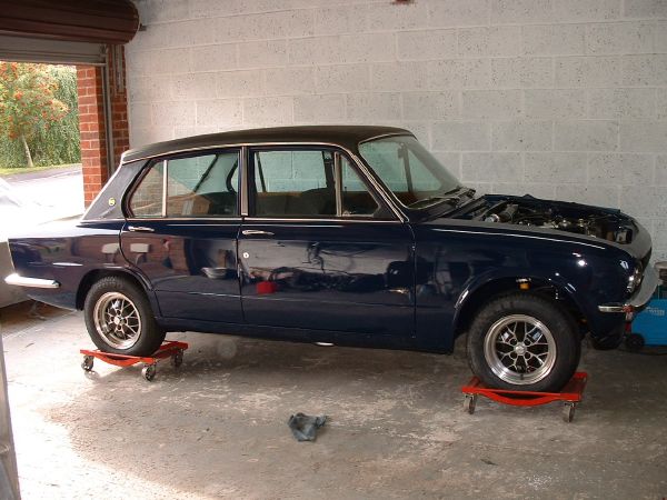

After a hard days graft at Castle Combe yesterday I decided I would have a relaxing day in the garage today.
We managed to bleed the brakes at last. We fitted the polished alloys shod with new Pirelli P3000 tyres. Mary fitted up the rest of the boot trim. We then fitted the spoiler, windscreen wipers & washer jets and refitted the rad again (taking a break to watch the GP of course).
So apart from putting some oil in the diff. and tightening the front suspension bolts once I've run it in & out of the garage a couple of times, that's about it until it comes back from the sprayers again. Better fit the bonnet as well.
