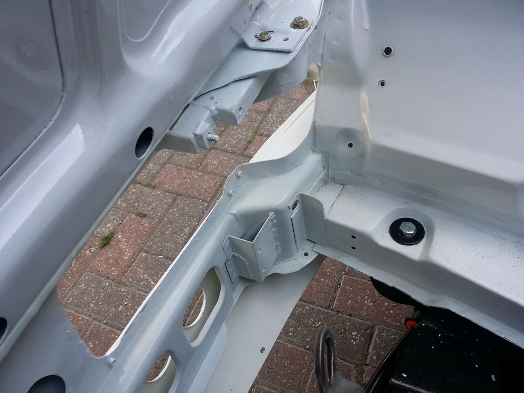

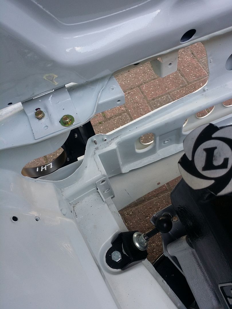

I'll post some pics tomorrow of the welded on mtg brkts and LHS cut out to get it to fit....
- lazeruspete
- Posts: 822
Re: How bad is my Sprint?
i have used a Fiesta rad in mine.
sadly it seems i dont have any detail pictures of the brackets
. but i do remember it fitting well inbetween the cheeks in the front panel.
Pete

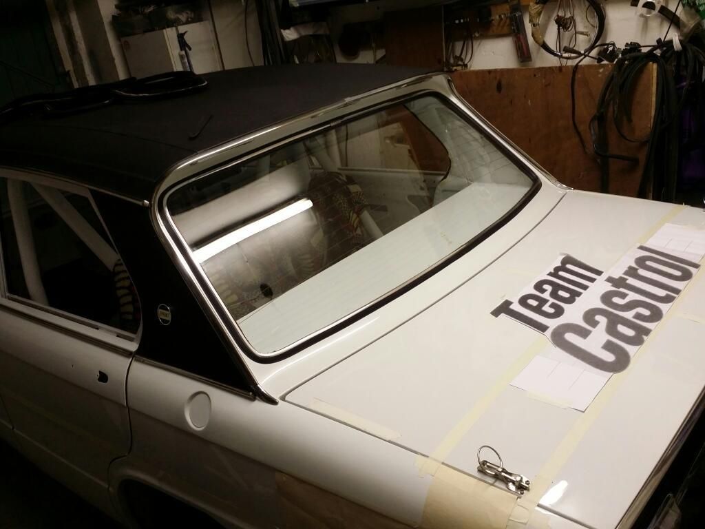

Fitted the rear screen at the weekend with a the screen rubber from Rimmer's and the screen trim from Witor's.
Don't think the fit is quite as good as original and it's a bit puckered in places on the inside.....I followed what it said in the repair manual and fitted the weather strip wit the screen in situ and it was a pig! Even carefully hitting it with a rubber hammer won't get it to sit all the way in but as I have no point of reference, I don't know whether or not that's as good as it will get!
Think it looks cool though!
Got Super Al coming round next week to plumb all the brake lines in, inside the car and the sign writer the following week to paint it up ready for Blakemere......
