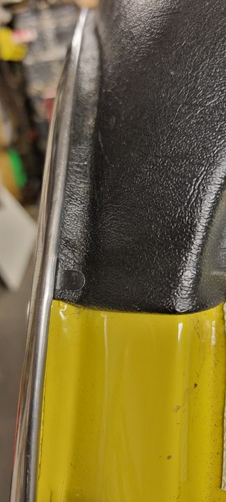

Alun very kindly sorted me out with a Sprint gutter trim, went straight on, very easy.
Had some NOS clips that fit to the a post:

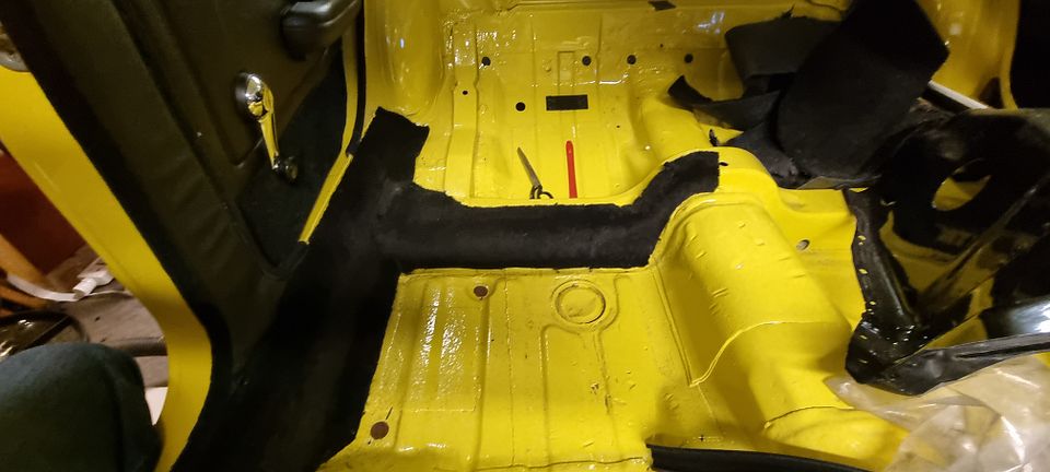

Made some sill carpets went in OK, nearside still to do.
