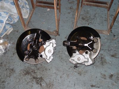

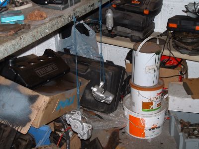

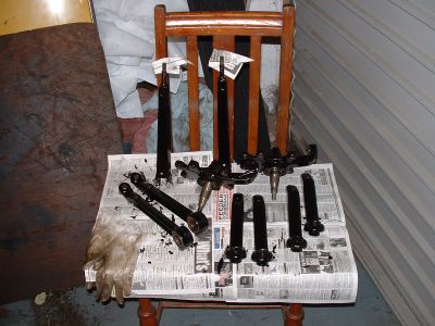

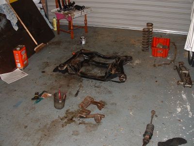

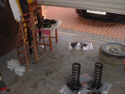

So far I've removed the sub frame & stripped all the suspension parts from it. I cleaned all the parts whilst Mary painted them. Then I stripped the brake calipers, fitted new seals & painted them. Mary stripped the door cappings.

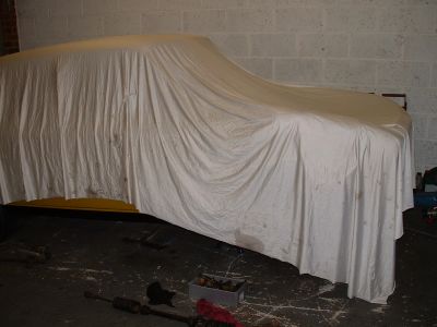

More pics of it at home please!!
Need to see it "as it is now"

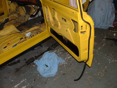

I'll take some more pics tomorrow Alan. We have done a fair bit today. Mary was struggling with the new door rubbers, anyone have an easy way to fit them.
- Posts: 8529
Re: Project BFR (1973 Mimosa Sprint)
Still struggling with the new door rubbers.

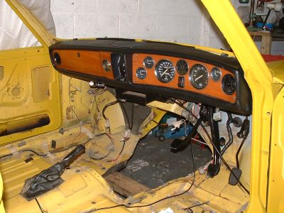

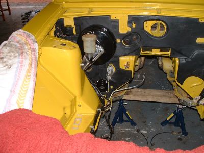

Servo, brake M/C, clutch M/C, steering grommet plate, wiring loom & fusebox fitted.
Heater matrix, wiper motor & mechanism, dashboard & pedals fitted.
More bits sprayed black.

Door rubbers: use the sharp end of one half a wooden clothes peg

Alun, We tried the clothes peg ploy today but went back to using the screwdriver & baby oil.

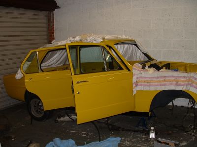

Done lots of bits & pieces today and a bit of searching for the odd part.
Rebuilt the hubs & calipers.
Fitted up the driver's door & just started on the rear one.
