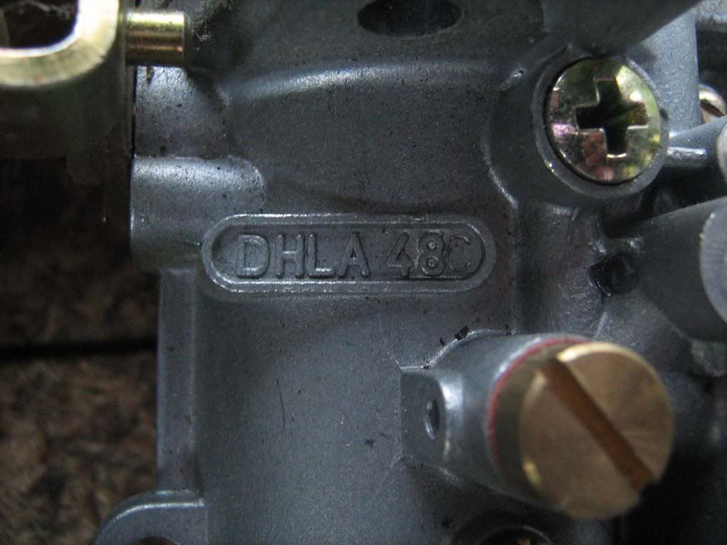

Dellorto 48s

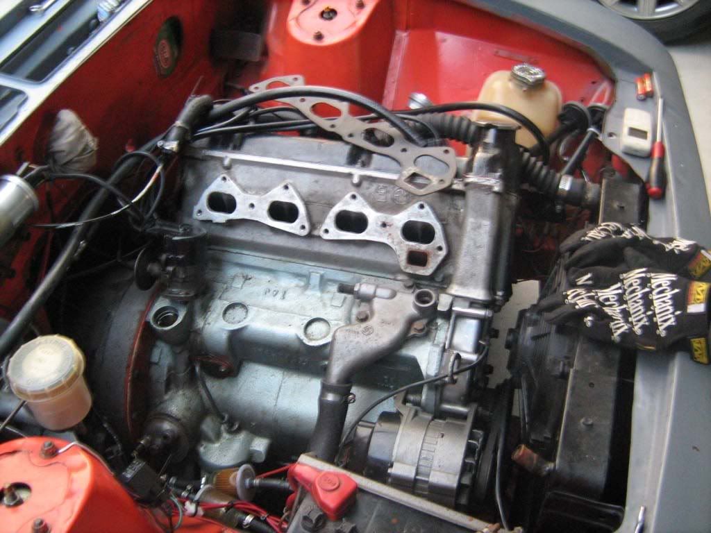

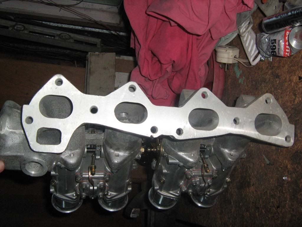

Alrighty the change is under way.
Tonight i drained the cars water
Got a new Thermostat
Took the Throttle cable off
Took the chock cable off
Removed the heater hoses
Removed the SU carbs
Pulled the waterpump cover off
Tried to get the waterpump out, got it to pop half way up but i could not get it right out of the hole.
Mocked up the manifold and carbs to make sure everything will clear and is in the right place.
The bypass tube,manifold,pumpcover look very close together.
Hopefully got a mate who is going to help me make a cable mount for the throttle.
Pictures tomorrow
Cheers Stew

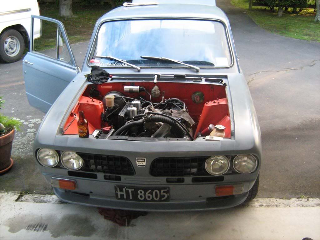

love the bottle of DB (?) on the car :D

straylight wrote:love the bottle of DB (?) on the car :D
Its a Tui
http://tui.co.nz/index.asp

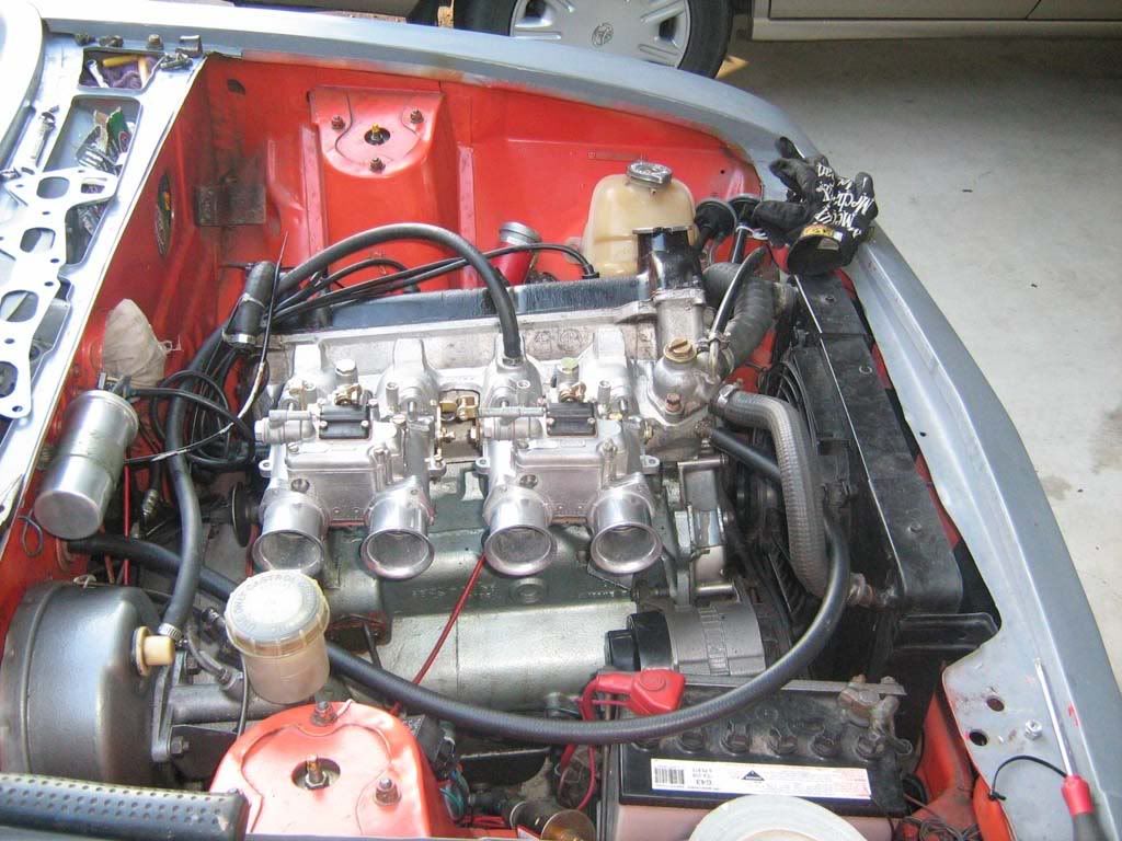

Got the pump out.
The tool i made worked awesome.
Two slides of the hammer and out she popd

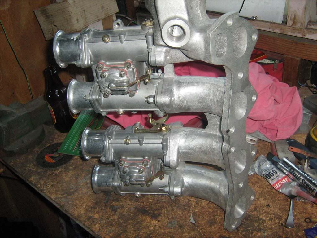

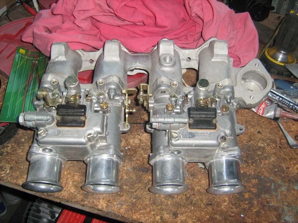

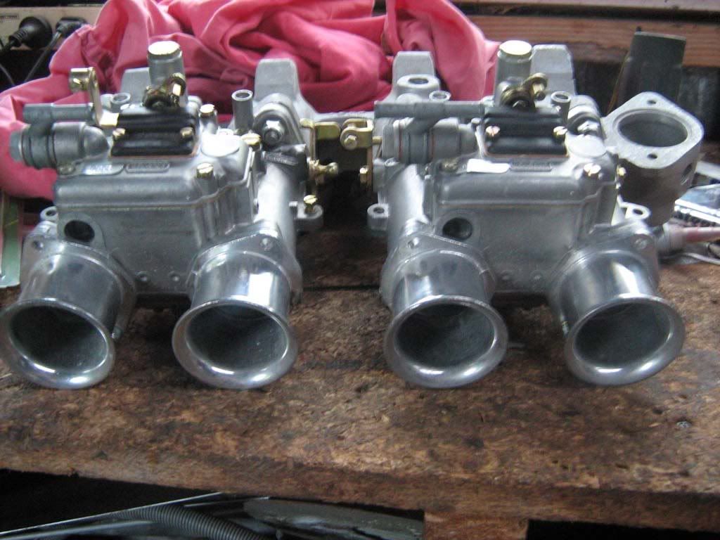

Mocked up the manifold and carbs again, sorted out one hole to mount the manifold needs to be ground out more. And also how heavy they are lol.
We (2eyes) and i are looking at using a linkage from the Standard setup off another manifold we have.
Should be pretty straight forward, bend up a bracket to mount the linkage on, and use a adjustable link to go between it and the carbs.
Also figured out how im going to do the heater hoses and mount the fuel pump.
Will hopefully get the linkages all sorted out tomorrow and Saturday, get the new waterpump in the block etc etc
Happy Times

Re: Newguys Sprint Conversion
#237 Post by Jon Tilson »

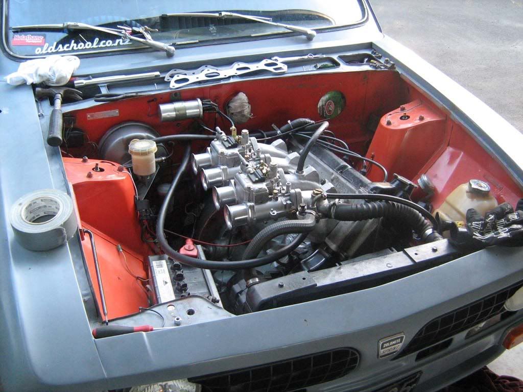

is it just the photo or is it stiing a bit low at the front?
You need a good match on the ports into the head....
I'd fit the bypass hose last vi the themostat as this can interfere with the alignment ever so slightly...

Jon Tilson wrote:is it just the photo or is it stiing a bit low at the front?
Yea she is pretty low all around, how i like it.
Done a ok match up job, better than the original Su match up.
There is no coiling equipment fitted as yet, just put the new WP in tonight.

No I meant the inlet manifold....seems to be sloping downwards and is lower at the front...
newguy
#240 Post by newguy »
Sorry Jon
That photo from the side makes it look so, i will check it out tomorrow.
I hope it is not the case.
Thanks for bringing this to my attention
