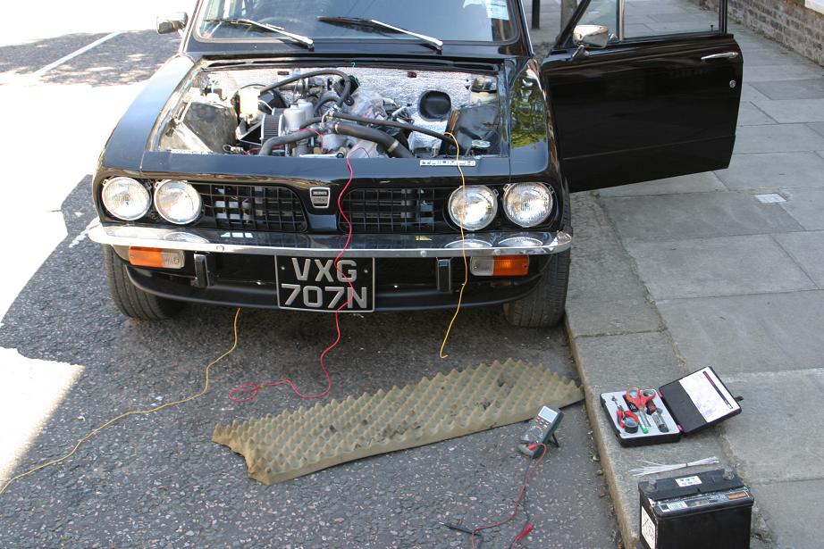

Got some of this stuff for under the rear seats...

Also fitted an alarm...

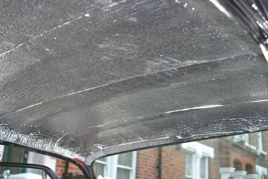

Had some issues making/getting a headlining so i thought i'd use some of the heat reflective insulation stuff left over from the engine bay. I high temp glued it all and used it as a shaper & underlay for the interior vinyl. Best i could do with the money i haven't got.lol

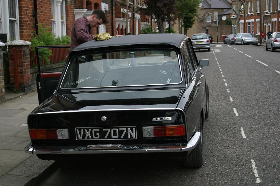

The finishing trimming of the vinyl roof, I've never done one before so it was pretty cool to do, just some advice though don't try to do it when its windy.:x . I was going to do it with the original stitching bits at each side but i didn't trust myself with sewing that long, but i like the look of it without anyway..
I also made/sewed a new gearstick gaitor , also overlapped & stitched the bottoms of the vinyl outside quarters as i've not wanted to get the chrome strip at the bottom of the windows..
