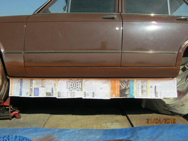

paint paint n paint...near the end of dong the sill,painting and touching in now

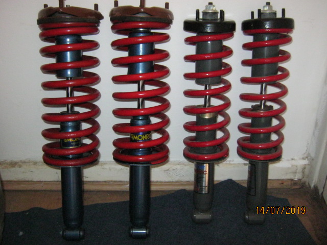

waiting to go on. monroe radialmatic fronts with -1" springs and monroe gas-matics rears with -1" springs,was set to fit this afternoon but then a discovery pulled up with no brakes,so suspension swap was put on hold,but fingers crossed this week sometime...thanks to sam for the front springs and thanks to madmart(i think it was you) for the rear springs
yorkshire_spam
Posts: 990
#247 Post by yorkshire_spam »
Springs and shocks looking good!

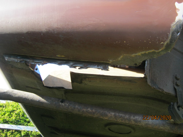

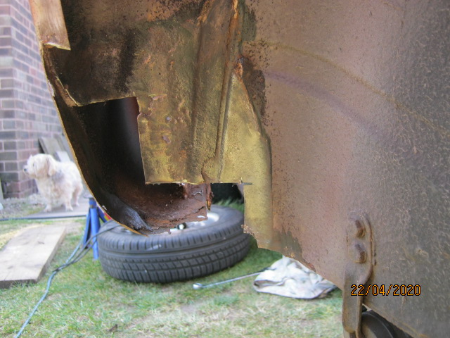

bit more to be done...rear drivers side boot area and rear lower arch
may need bit of donor material....can anyone help? lower arch rear
oily66
Posts: 314
Location: West Yorks
#255 Post by oily66 »
Club does a repair panel for the boot floor edge.
