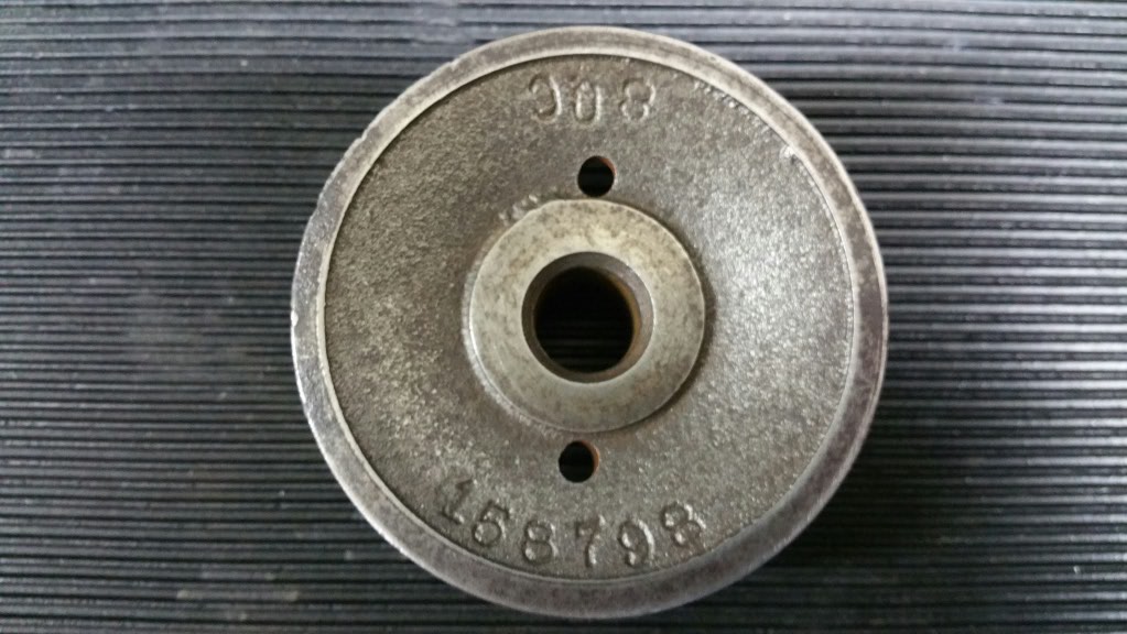

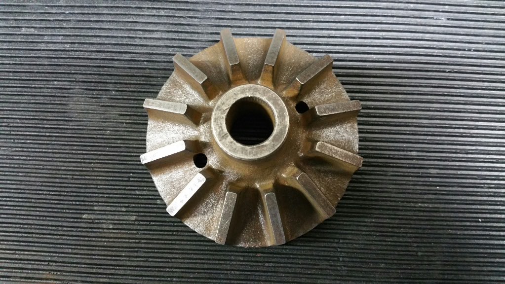

Thanks to Steve (Carledo) I had a replacement for my worn out impeller, and couldn't resist giving it a clean,

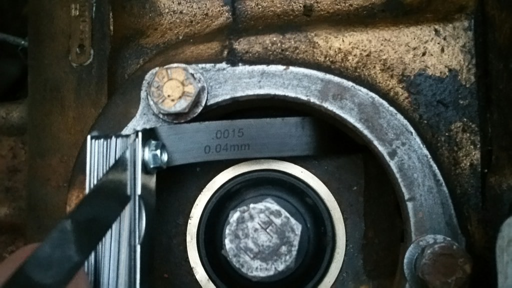

Anyways, back to this morning, with trembling hands I checked to gap from the brass cage to block all round, and couldn't insert the feeler gague anywhere, so happy with that.

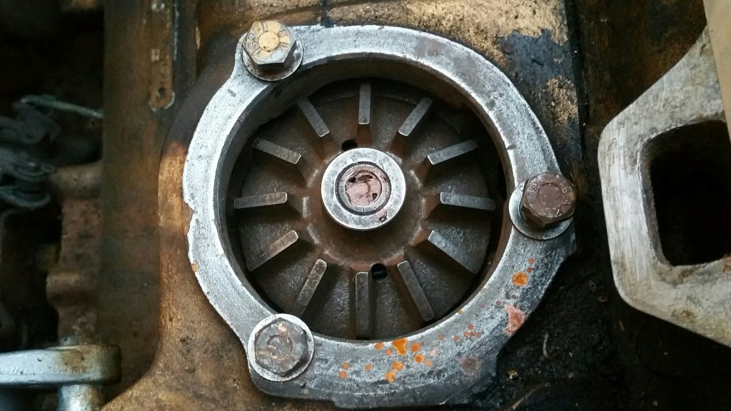

Then put the impeller in, pushed nearly all in by hand, as the car was freezing and the impeller had been indoors.
Was going to put the nut on and tighten down, the decided on wood and a hammer to softly tap down to shaft level.
2015-11-22 07.56.31.jpg (117.01 KiB) Viewed 833 times
Then put some copper grease into the shaft threads and tighten the bolt down. The impeller is firm, no play other than a few mm from the shaft.

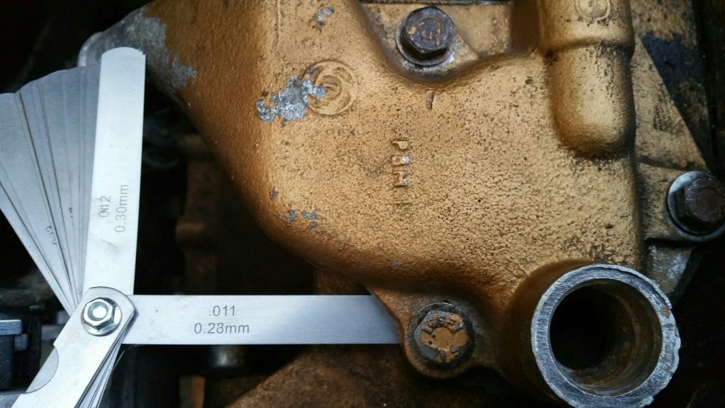

Finally, put the cover on and finger tightened the bolts, max feeler gague to go in was,
2015-11-22 08.20.36.jpg (131.59 KiB) Viewed 833 times
I put a smear of copperease on the top of the pump gradually increasing, till it hit the cover, looks like 2mm clearance?
I got four gaskets with my kit, the thinner ones are less than the gague, one is the same and the thickest (most likely) is the next one.

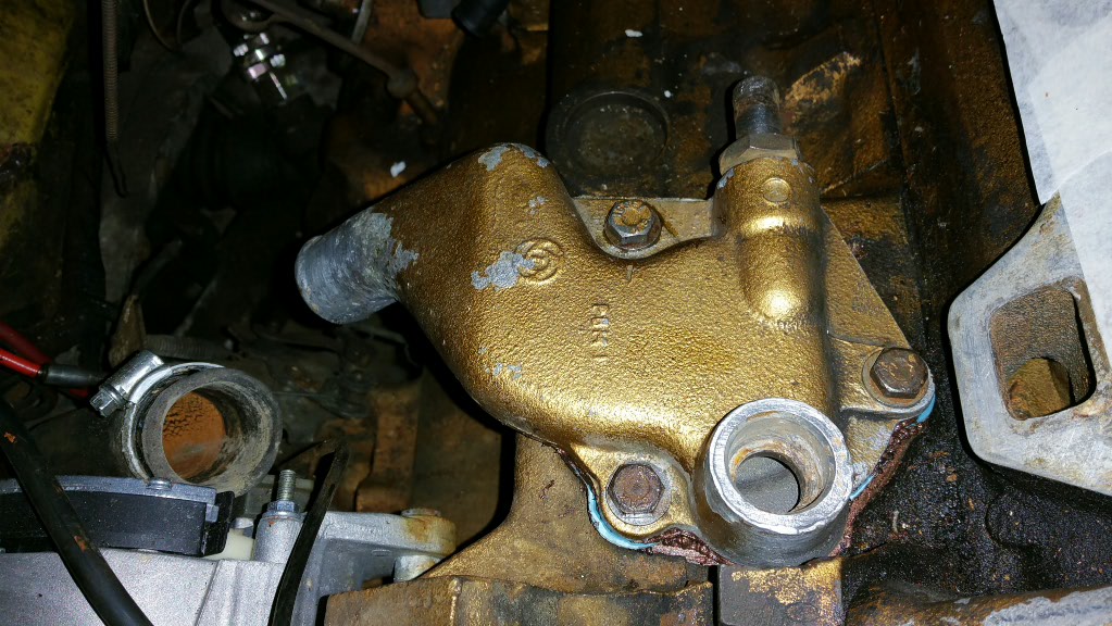

Put the pump cover on, smeared some copper grease sat the gasket in place and finger tightened all three bolts, then one by one brought them up to 10 lbs on the torque gague, followed by 20lbs gradually increasing each.
2015-11-22 16.52.04.jpg (175.21 KiB) Viewed 799 times
I'm confident there shouldbe no leaks, only find out at the end.
#246 Post by Jon Tilson »
NOOOOOO!!!!! what did my wiki page say about using impact to force the impellor down?
I seriously hope the graphite ring has not cracked on you I really do.....They really are very brittle - like a pencil lead!
The whole point of my wiki post was to use the bolt to pull the impellor down on the shaft after the pump was located in the block.
Other than that more nice pics and the underside of the impellor did look pretty smooth.
For peace of mind I would take the impellor off again myself and be sure the graphite seal is good or you could find yourself with a sump
full of mayonaise. Ive been there which is why I wrote the article....
Sorry to seem negative. I'd hate this to go wrong after such a long saga...
Mahesh
Posts: 1293
#247 Post by Mahesh »
Thanks Jon,
I'll double check in the morning, it'll only take a minute or so to take the cover and impeller off to have a look.
Should be fine, very light taps through soft wood, but better to be on the safe side, especially as it's all still open.

Mahesh
Posts: 1293
#253 Post by Mahesh »

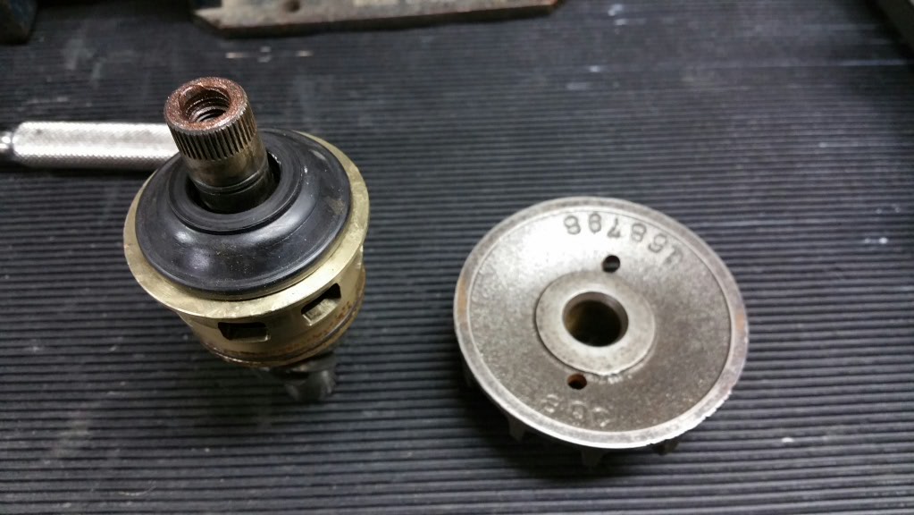

Got the packaging strap ready, opened the three cover bolts, cover came off smooth as silk.
Put the packaging strap under the impeller, twisted and same for the other side.
As I undone the impeller nut, the whole assembly complete with brass cage came out, what a touch, priceless.
2015-11-23 07.51.03.jpg (129.84 KiB) Viewed 737 times
Took the assembly indoors, gripped the flat of the shaft at the bottom in a vice, and undone the top nut, (clockwise) and left in about a third.
Suspended impeller over vice and rubber mallet ed the loose nut (gently) till the impeller was free.
Graphite seal is intact :D
2015-11-23 07.51.21.jpg (96.64 KiB) Viewed 737 times
Inserted assy back into the car minus the seal and impeller, softly tapped the brass cage back, Checked cage to sump with feeler gague,
inserted graphite seal, pushed on impeller, and tightened down top nut and washer.
Cover torque tightened, all done.
#254 Post by Jon Tilson »
Result....
Peace of mind and no new bits needed.
How many gaskets did you need? I think the last few I've done have been one thick and one medium. Clearance is
important because if there isnt enough, you load the jackshaft skew gear and it wears pretty quickly. In the worst
case I had we had to replace the jackshaft and pump, which wasnt cheap.
So like you say...fat smear of copaslip atop bolt, gaskets in - nip up, remove cover and make sure no copaslip on
cover boss. You can also do something similar with a bit of bluetack or "plastigauge" if you can find any, but that's
a bit overkill....
Good work...
20% bluecol solution and some de-scaled water (tightwad tip: I used freezer defrost melted ice last time! but the local work air con unit or a dehumidifier does the job or you can buy de-ionised water if you are flush) and you will be away....
