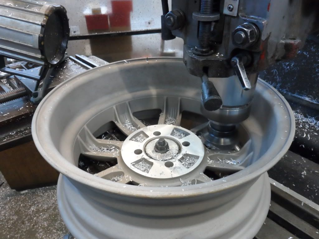

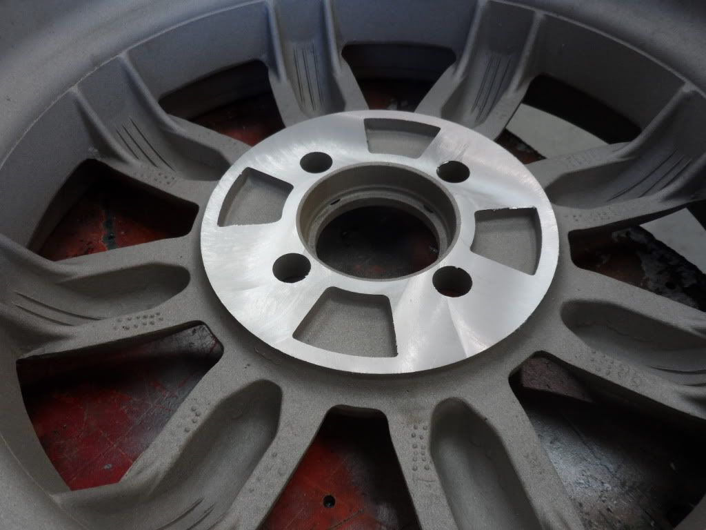

A mate machined 3mm off the inside of the rear wheels today, this should give clearance on the rear wheel arches. :D

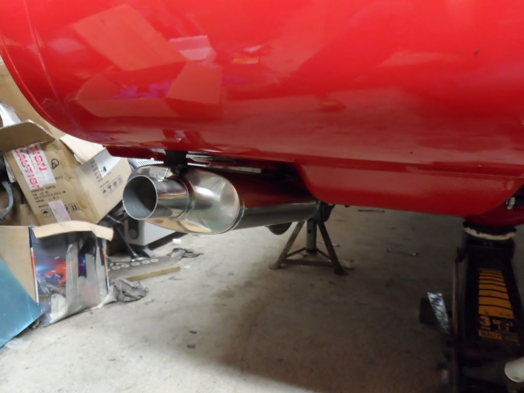

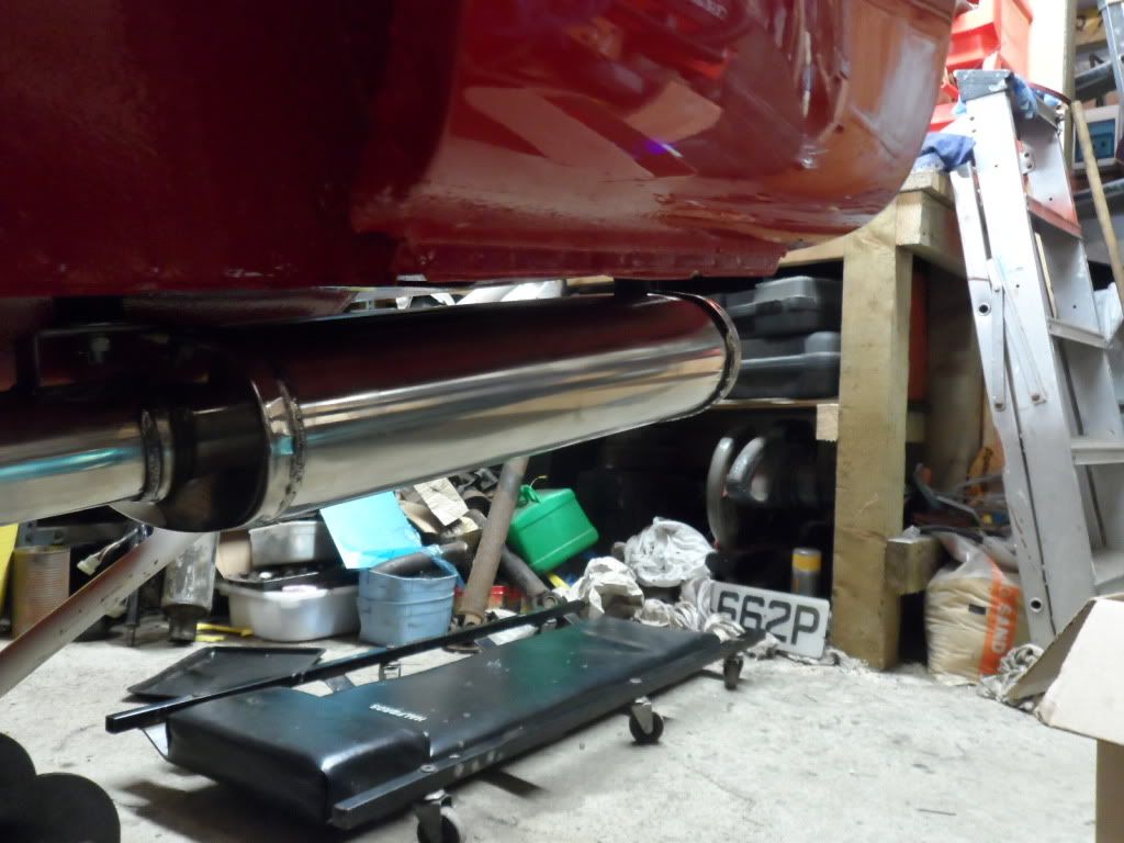

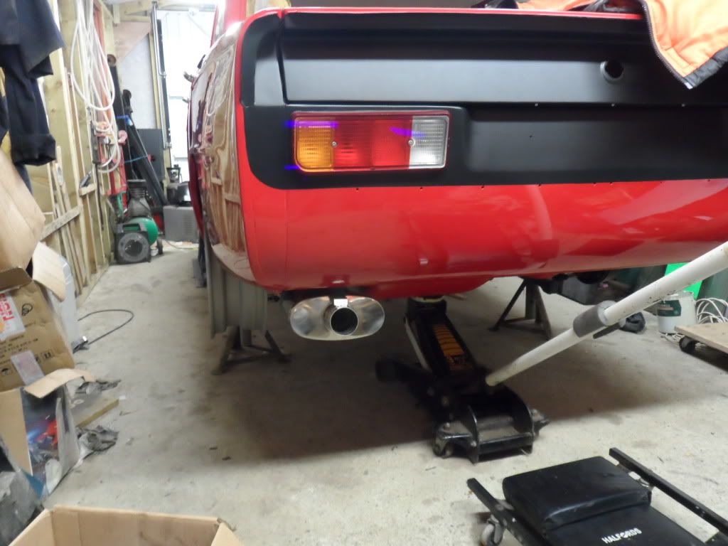

Spent all afternoon trying to get the exhaust on, decided against a side exit so went with the Rimmers system which came with the car, it is a bit rusty so I may replace it at a later date, when I have more funds.
Had to fit any alternative back box as the original had rusted through, got this off ebay, welded the brackets on, first bit of stainless steel mig I have done, went alright. Just need a finisher for the tail pipe.

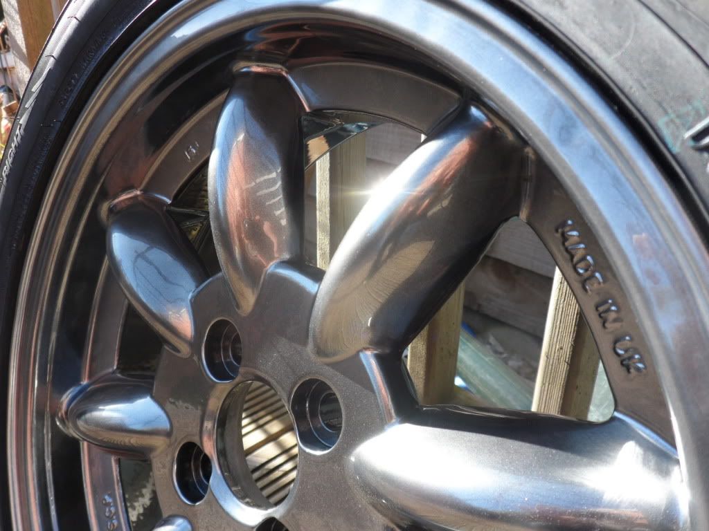

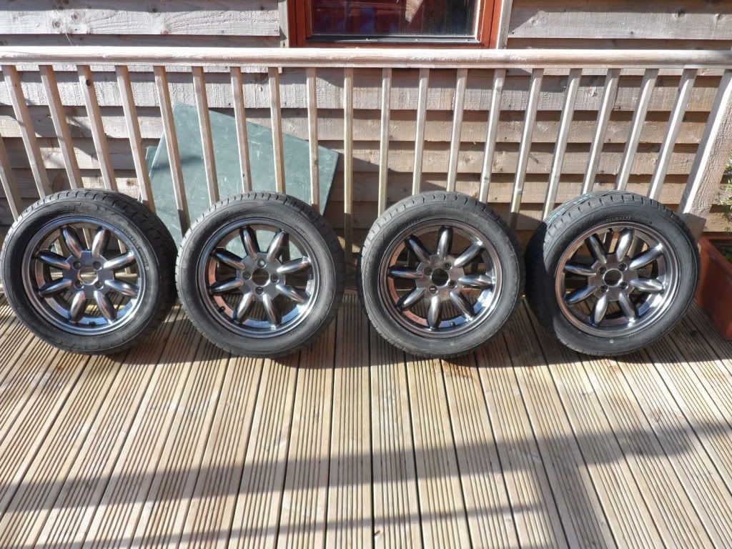

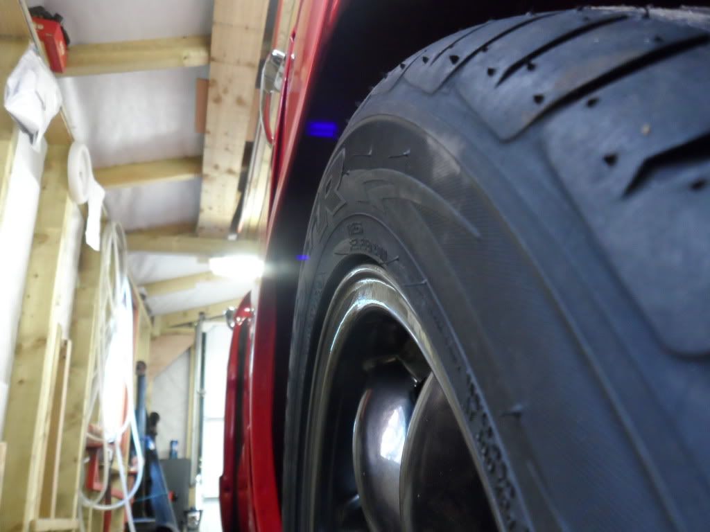

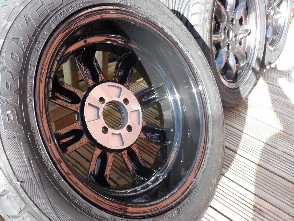

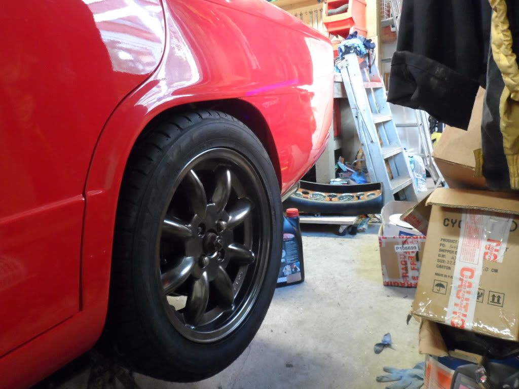

Just got the wheels back from the powder coaters, black chrome, bit bling!
Just clear the rear arches
Went with Toyo Proxes 185/55/15
Re: MSO 662P
#262 Post by Jon Tilson »
Be sure the nuts dont ground out on the thread ends now you have machined the wheels a bit...
Look great though....different.

#263 Post by Tony Burd »
Will double check, cheers Jon

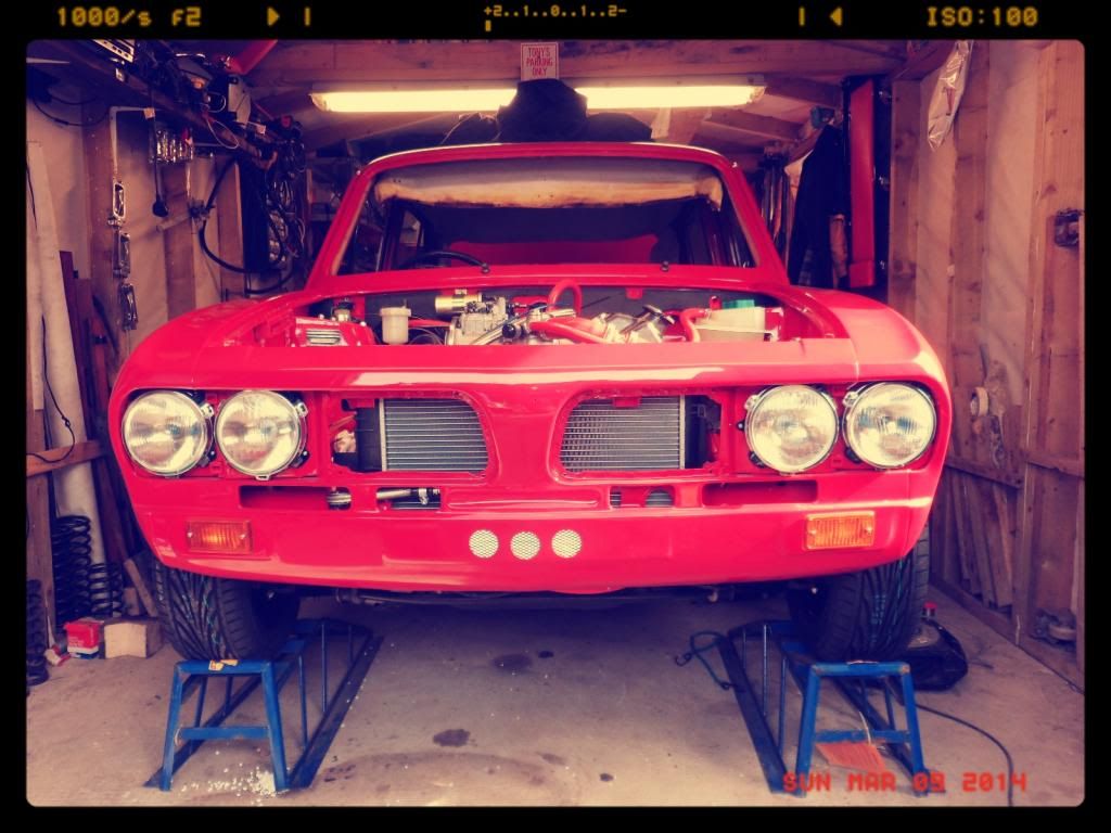

Getting there.......................

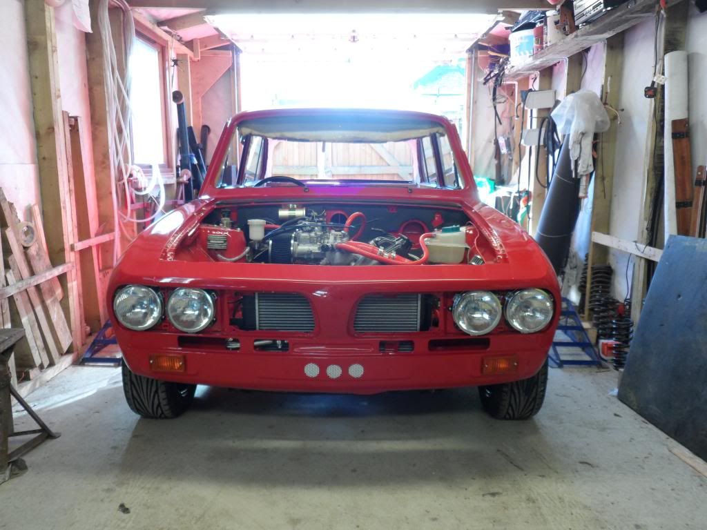

Got the car on it's wheels today & I am please with how it sits, bit too much camber on the front but I can sort that out.
Got a new inlet gasket & refitted the bypass tube with new o rings, filled up with coolant & success, no leaks!

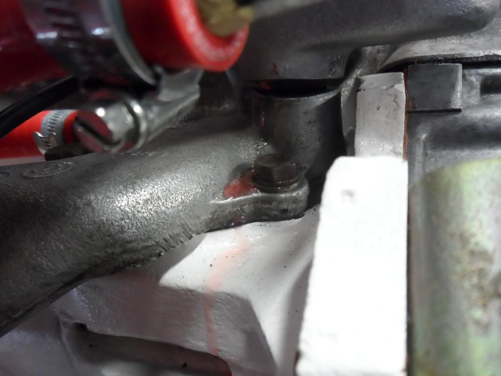

Then I noticed this:-
That bloody bypass tube has started leaking, what a PITA, I think I need some slightly thicker O rings as it is not as tighter fit in the manifold as it is in the water pump cover, does such a thing exist, anyone know a source?
This is really putting me back, I wanted the car ready for Easter Monday, not sure I can make that now.
When I renewed my water pump last year I purchase a OEM link tube from Geoff @ Wins and mine too started to leak - I then purchased after market link tube from Robsports - these are the same a RB are selling and no further problems. I will post a picture of th OEM link tube when I'm back from Norway on Wednesday afternoon. I think the seals on the top and bottom of the link tube aren't thick enough where with the after market one they are proper "O" rings.

Cheers Paul, but the one I have fitted is a Robsport tube. It is not a very tight fit in the manifold, so I think I need thicker o rings, or I might get a new tube machined up with the manifold end slightly larger so it is more of an interference fit in the manifold.

Don't worry too much about the bypass hose, have seen this before on one that was put my way with the same issue, turned out to be crap quailty O rings.
Getting it machined up would be a good/ better option as you know exactly what the tolerances will be. You've done so much else to it, so why not.
Run standard coolant once its sorted and your certain that its cured, then chuck in that expensive stuff!!

The o rings on their own don't provide a great seal. I've used either blue hylomar in the past of instant gasket. Basically fit o rings, smear in sealant, insert tube and allow to cure before filling the system. When I used o rings on their own it seemed a bit marginal.
