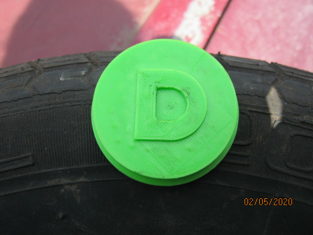

#259 Post by tamtrucks »

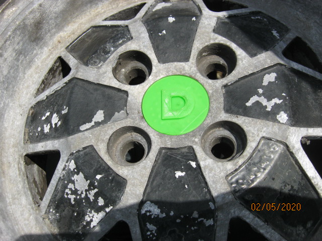

going have to re-make this centre cap as the hub nut cover sticks out 2mm past the wheel rim,,,so may have a dome finish without lettering...watch this space! i did like the flush fit but...it **** happens

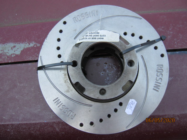

#260 Post by tamtrucks »
new brake disc`s for brown dolly,,got these from fittapart

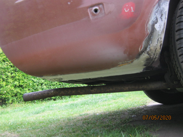

couple of weld up jobs,,front passengers corner and rear driver arch at the rear part,,still have to start and finish the lip of the arch

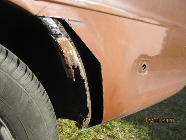

#262 Post by tamtrucks »

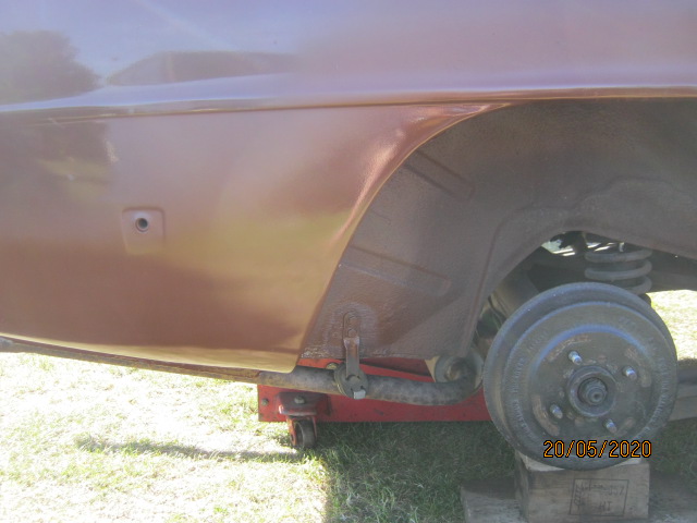

front ready for light and grill,,bumper later on....passenger rear arch had paint bubbles then this...more rust to cut our and make new section to go in...more fun :lol:

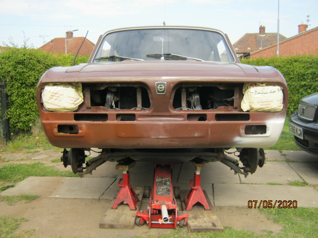

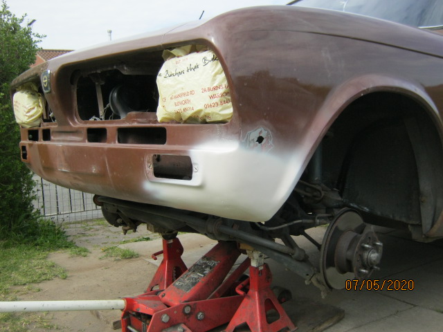

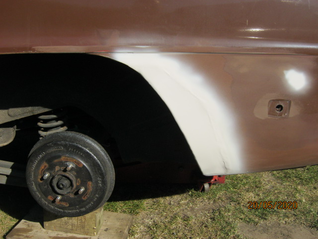

#263 Post by tamtrucks »
front now done and splitter back on
rear passengers side arch all welded in and ready for bit of filler and paint
drivers side looks smarter then before...still 40 shades of brown :lol:

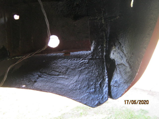

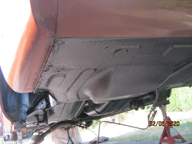

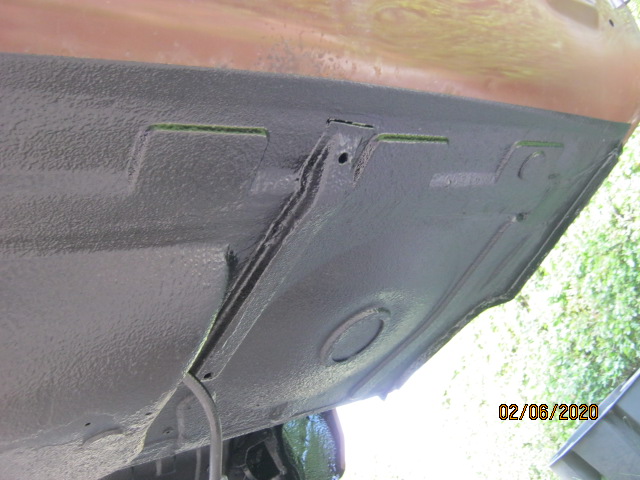

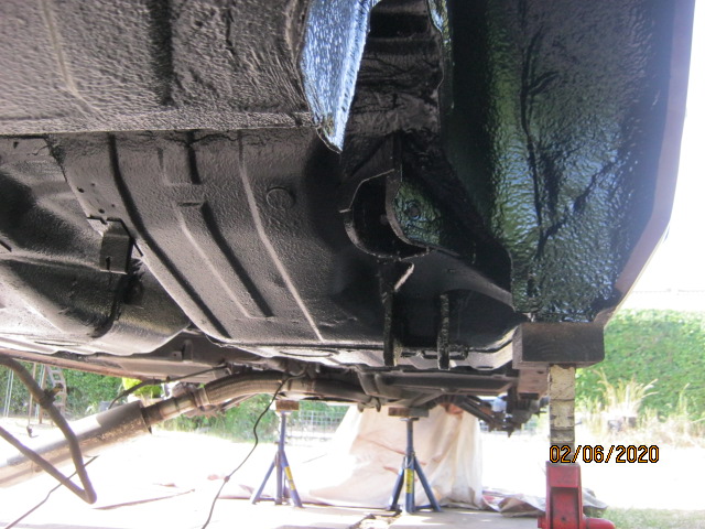

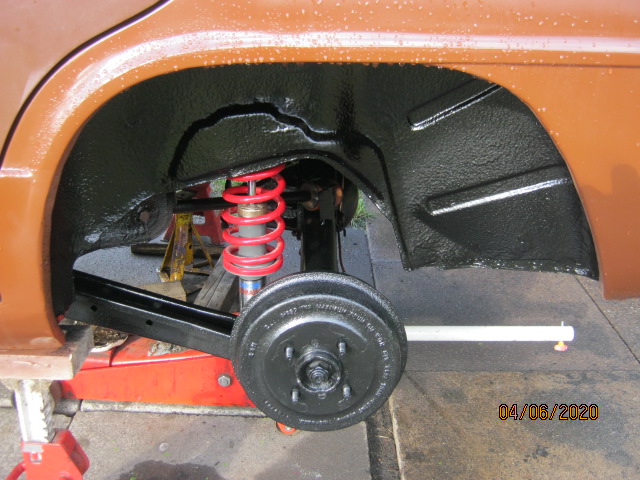

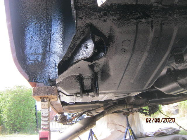

complete rear axle off and paint gloss black,also pianted is upper and lower arms after bushes masked off,prop off and cleaned ready for painting,handbrake cables removed,rear shocks off ready for the lower`d ones to go on..just under body to sort out before dinitrol
tamtrucks
Posts: 765
Location: NORTH NOTTS
#266 Post by tamtrucks »
dinitrol`d

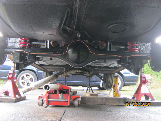

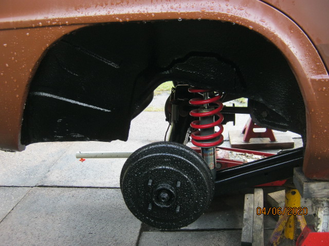

#268 Post by tamtrucks »
today i managed to get the axle back on in between the showers,new monroe gas-matics shocks and springs,new brake pipe still need finishing...just handbrake cables,prop and anti roll bar to fit and its ready for loading and torque`ing up bolts....still thinking of side exhaust :twisted: but fit it on the drivers side to be safe regarding the petrol feed pipe

#269 Post by tamtrucks »
all done,back on its wheels,feel nice to drive more responsive

#270 Post by new to this »
tamtrucks wrote: Sat May 02, 2020 4:43 pm going have to re-make this centre cap as the hub nut cover sticks out 2mm past the wheel rim,,,so may have a dome finish without lettering...watch this space! i did like the flush fit but...it **** happens
Hi i had the same trouble with the wheel centre cap , i had a collar machined on the front out side edge so the cap comes through the wheel a bit more and a collar machine on the back to clear the axle nut
