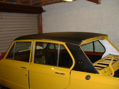

The vinyl roof was sitting on my desk when I got to work this morning. :D Opened it up tonight and it looks the dogs danglies. Seams in exactly the right place. :thumbsup: I'll probably leave it 'til Saturday before fitting it & I'll take pics as we go.

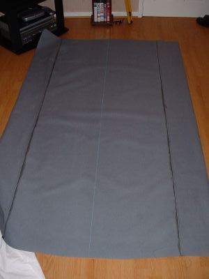

I made a start on the vinyl roof tonight...I put the centre line on the back of the material. I didn't need to go all the way from end to end, but I did. :D
Also bought some Evostick spray contact adhesive.
Edit: Thinking about it, I need the centre line all the way down so that I know where to spray the adhesive for the initial fitting.

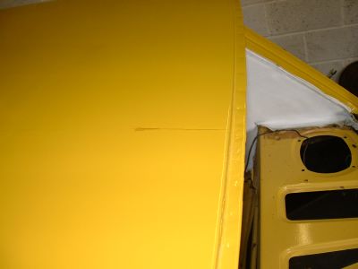

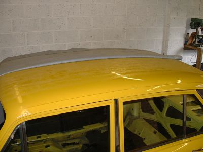

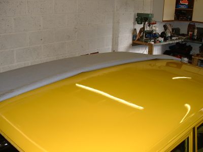

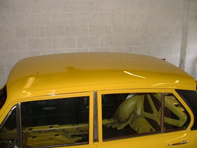

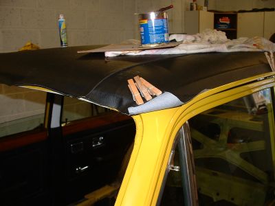

Today Mary & I fitted the vinyl roof...
I marked centre lines on the Sprint's roof.
Image Image

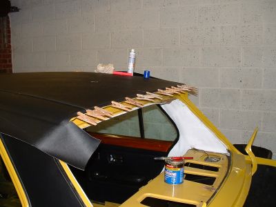

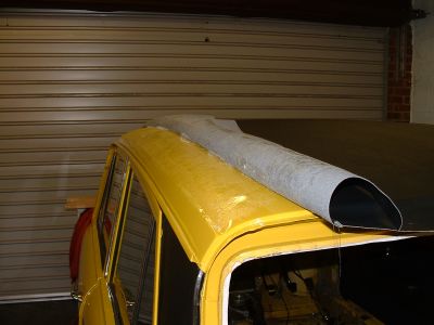

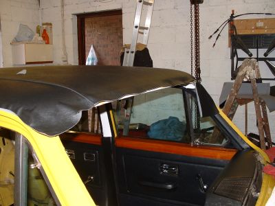

...then we layed the vinyl to one side of the roof & sprayed the adhesive down the centre of the roof & vinyl (approx. 3-4 inches wide). We then had to get one of us on either end of the vinyl and line up the centre lines of the roof & vinyl, front and back. This was probably the hardest bit of all & where a third person would definitely have come in handy. In the end though it went quite well...

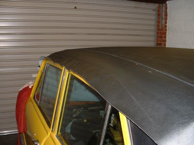

...then I sprayed the roof & vinyl as far as the seams and, working from the centre out towrds the corners, smoothed the vinyl on to the roof. We did the same for the other side...
Image Image

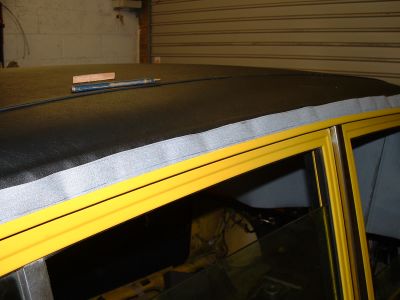

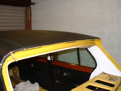

...next we glued up to the roof swage line on either side...
Image Image

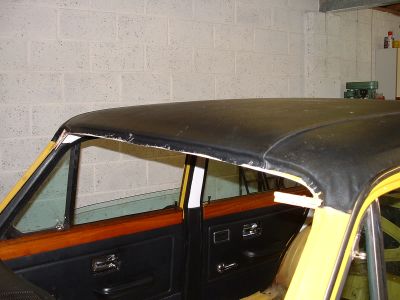

...once that had had time to dry for 20 mins. or so we pushed the vinyl into the gutter (dry at this point) so we could mark the vinyl for trimming...
Image Image

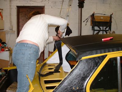

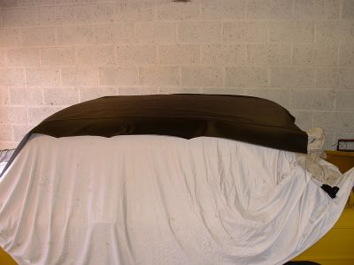

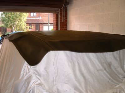

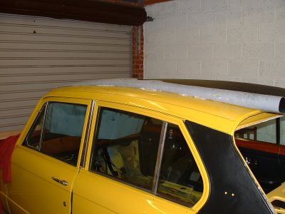

...then we turned our attention to the front & rear. Clothes pegs came in handy...
Image Image
...just turned 2-3 mm. under for the bit at the top of the 'A' post...

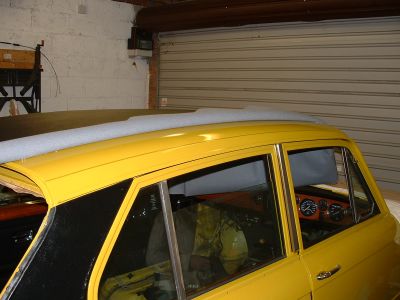

There are a few air bubbles so I'm hoping that by the morning they will have gone. [-o<
Many thanks again to Mary for helping me with the fitting. It took us most of the day but we both think it went really well & looks great. Neither of us has done this before so next time???? may be a bit quicker...
Image Image
...JOB DONE. :D
