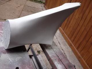

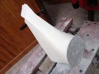

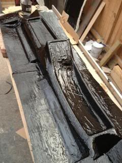

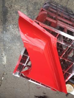

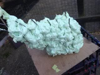

Finnnnnaly got around to doing the dash board mold

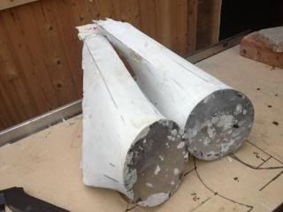

Also started the rear radiator air inlets
I welded a cage up in the shape im after then filled it with expanding foam
I then cut them back to get around the shape i wanted then a skim of filler
OOOH joy lots of sanding req :?

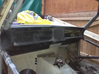

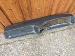

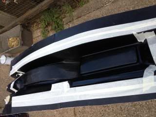

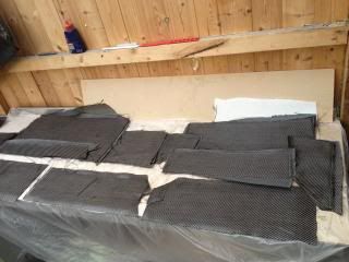

Done a bit more on the dashboard mold
Got it ready to make the part in cf
Quite a few bits of carbon going into this 34 in total
Hopefully will be able to make it tommorow,,,

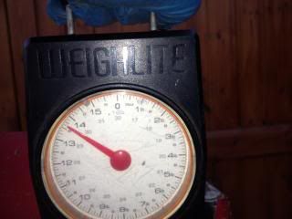

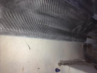

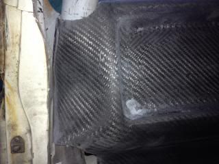

Carbon dash nearly done
got to do a bit of fettling but all seems good
Quite a weight difference
5 and a half bags of suger less to cart around :D
And a good fit around the rollcage door bars and cross bar
Now onto the centre consol from the dash to the gbox tunnel

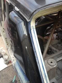

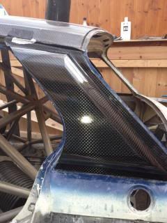

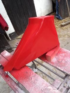

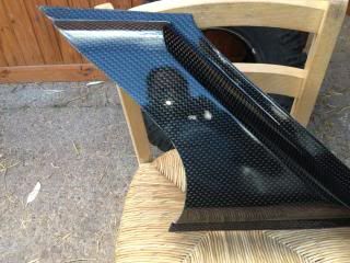

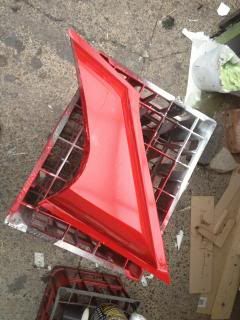

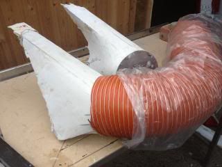

Have done a little more on one side of the rear inlet rad vents
Nearly ready for molding just a bit of polishing

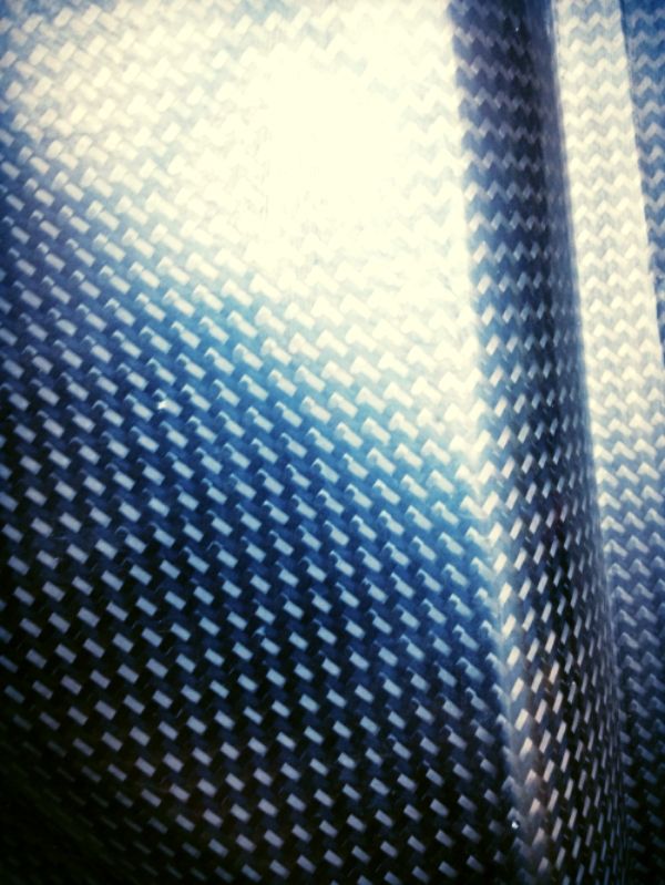

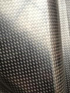

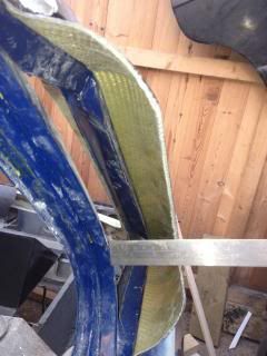

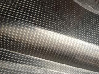

Been toying with some new kevlar .carbon mix cloth
The difference with this is the kevlar is black,
And very strong.
I like the look may do a roof in this

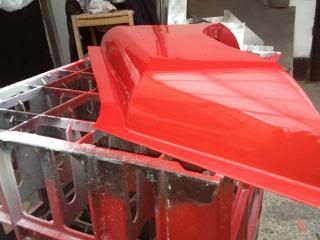

I have just pulled one of the rear vents out of the mold and i think
it will look good just laquerd,
