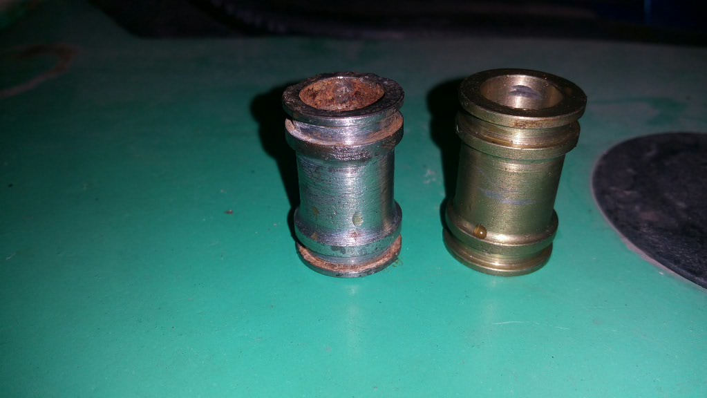

Removed all the inlet manifold bolts, and I found there is sufficient gap to remove the connector.
Cleaned up the old one to go back in, but the new looks identical in size,
2015-11-27 20.00.22.jpg (67.51 KiB) Viewed 1067 times
So the new one goes back, especially as it is not the culprit,
2015-11-27 20.00.50.jpg (60.56 KiB) Viewed 1067 times
Put back in place, feels better this time, but as I was putting the manifold bolts back, a tiny drizzle turned into a downpour.
All stop till the morning.

O ring quality is an issue.
Even stuff from plumbing shops these days is not as it was....
Try again with vaseline or red stuff and you can't say too many times how important the quality of surfaces is in water pump cover and manifold.
1200 wet and dry is your friend again...

Hi Mahesh, There is an alternative part to the UKC2538 + the 2x TRS1114 O-rings, which in my opinion is a better engineered solution. Try and get a 156875 as fitted to early 1850 / Sprints . I see Mick Dolphin has one listed at about £4.
The 156875 is a one piece rubber part with the O-rings and the tube moulded in one. So it doesn't rely on after market supply or rubber rings.
As Jonners says, the areas where these parts sit needs to be very clean and in addition I always use a smear of Blue Hylomar on each end to help it slide in and seal properly.
Good luck you are nearly there.
