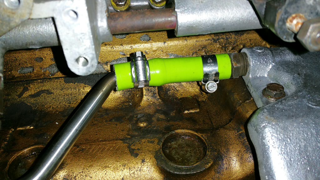

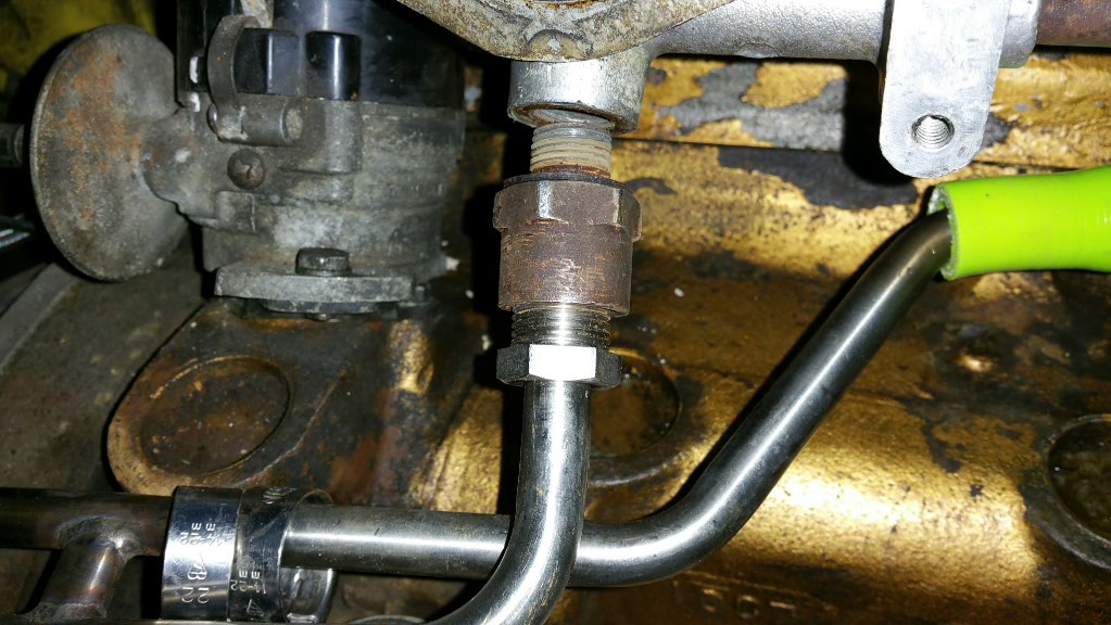

2015-12-04 22.08.09.jpg (43.3 KiB) Viewed 1133 times
Fitted to the H pipe like a glove now.
2015-12-04 22.08.35.jpg (130.68 KiB) Viewed 1133 times
Also pleased with the longer return pipe.
2015-12-04 22.08.53.jpg (193.79 KiB) Viewed 1133 times
Refit of carbs, linkage, fuel, choke and ancillaries, time to refill coolant.
All done and test time,
2015-12-04 22.09.12.jpg (173.73 KiB) Viewed 1133 times
All seems well, but hard to see in the evening, few minutes on choke and then topped up coolant and the replaced expansion tank cap.
Let the engine run for 15 mins, seems leak free, hot and cold at the heater, however the temp gague stays at 1/4.
In the morning I will bolt up the bonnet, pack the tools up, and take for a spin.
