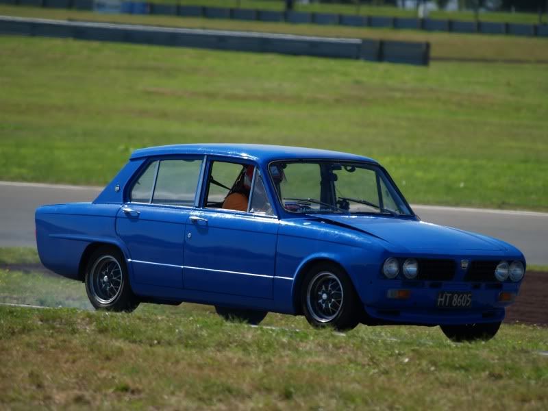

I so hope trumphy makes it to track day has a good day and gets home ok. Seems to be letting oil out ofthe front where the head,block and timing chain cover meet. And then getting round to the zaust where it drips and burns, I hope this does not cause a fire, back seats etc are out

Ahhh well Shes not to well,
Half way there i had lost oil her oil then after filling her back up she had big blow by and way pushing white smoke out the breather and oil.
Got to the track, was holding its temperature well and still revved OK, i think i may have done another piston or something.
Had two excellent thrashes around the track, car handles great though the back needs to be lowered and stiffened up more.
Then on my third outing i lost a bit of power, i had a massive short from the overdrive, then going into the pits it blew the dip stick out and oil all over the engine bay and onto my electrical fire.
So back in the pits i got the fire out, my mate cut the loom out and we wired the fuel and coil direct and drove home with no lights.
Same ok power, a cloud of smoke but it made the 2 1/2 hour journey.
Time for a professional rebuild, my dizzy is the problem i feel. Pretty sure i melted a piston or rings on the way there.
Will test the compression before taking the head off tonight.
So look out i could be after some new pistons again.

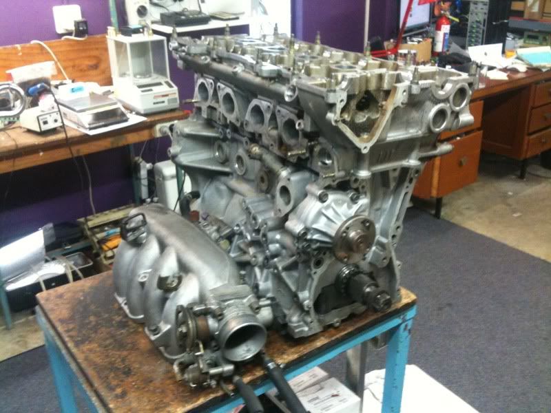

Nissan Going in triumph, Ohhh Yeah
