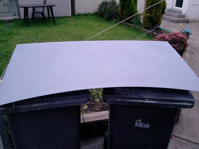

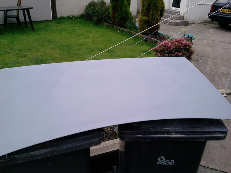

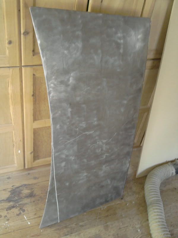

Right then. Its been far too long and now its time for an update.

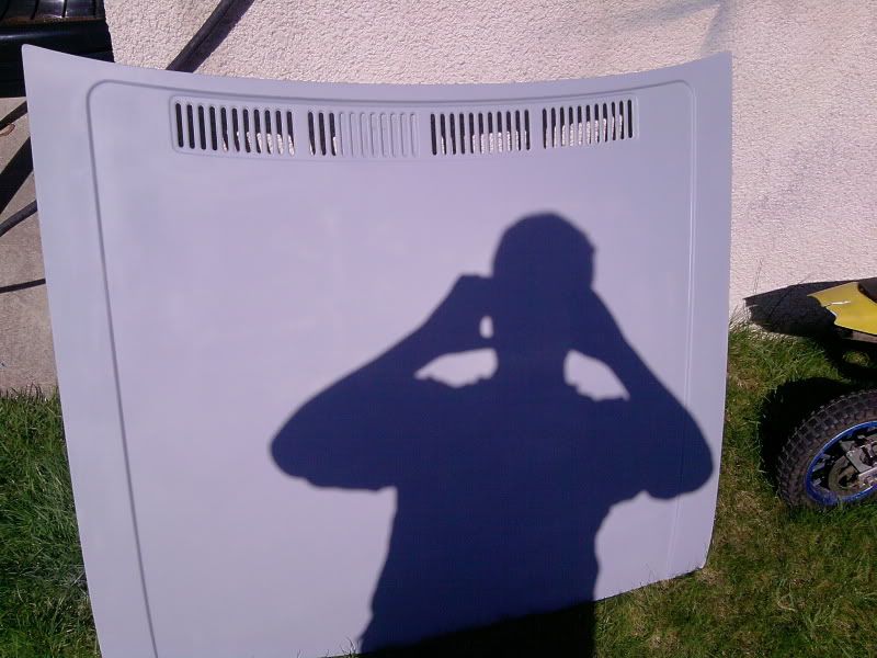

My bonnet is done and prepped ready for painting. This needed very little in the way of work. just the vent panel was rusty.
So thats that one down and ready for painting.

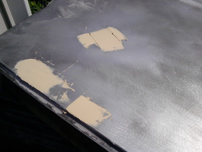

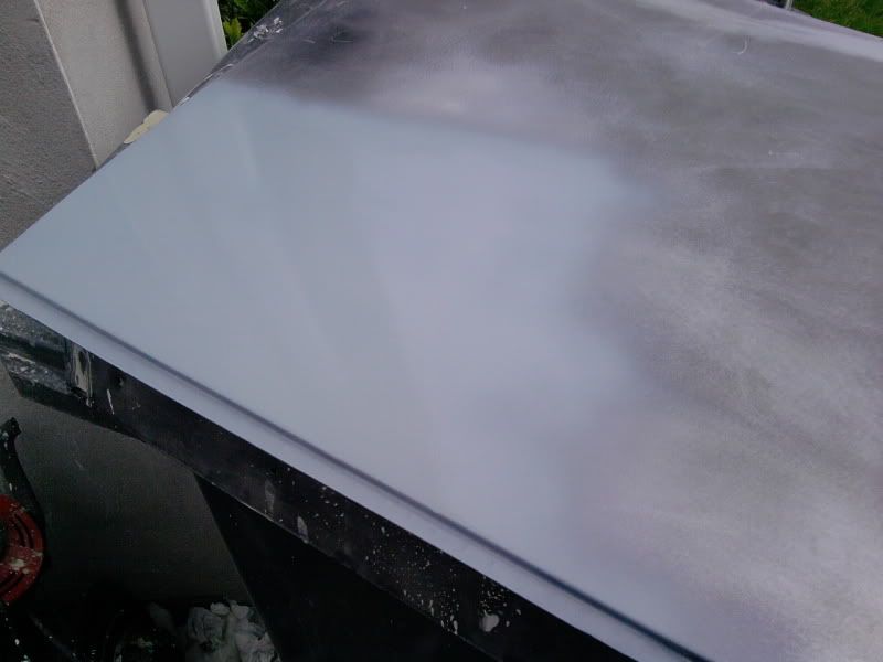

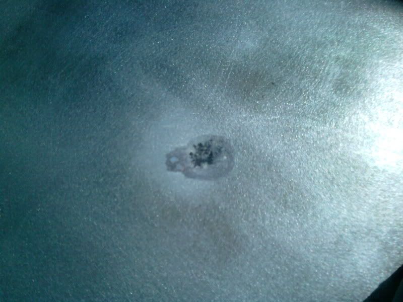

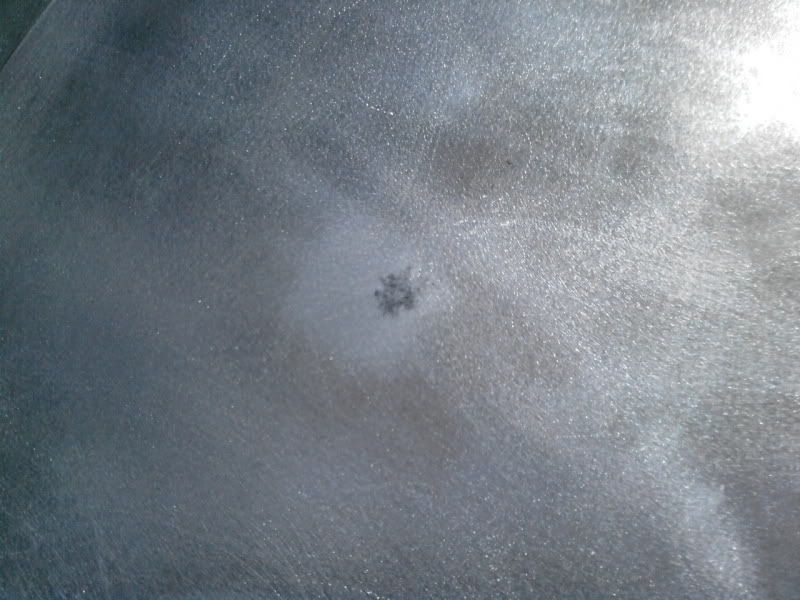

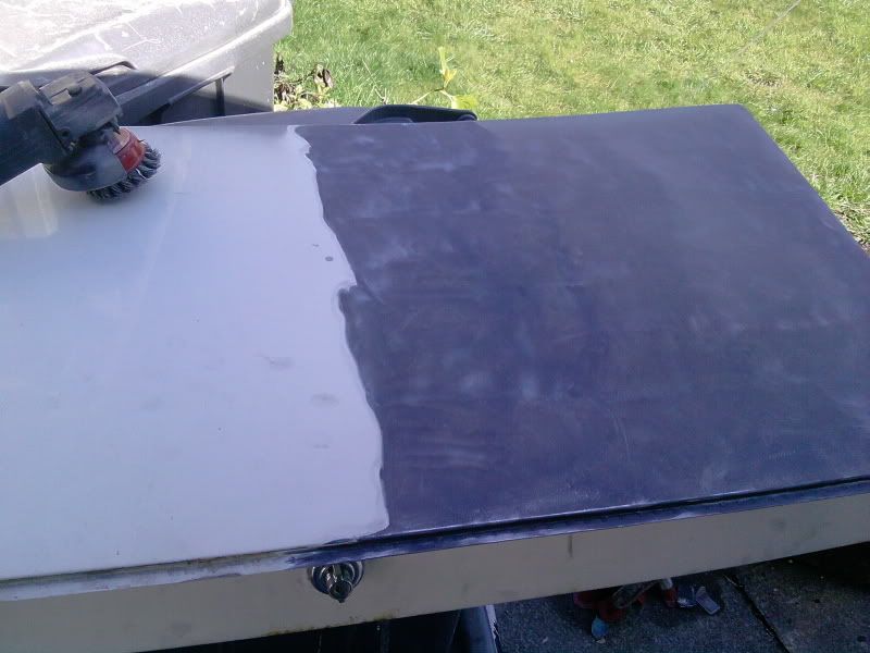

Then I thought Id have a go at my bootlid. Now I have done a bit of grinding and such around th eback so there was sparks taht had landed all over my boo tlid and then rusted. Balls. So I decided to strip all of the paint off just to make sure I got it all.

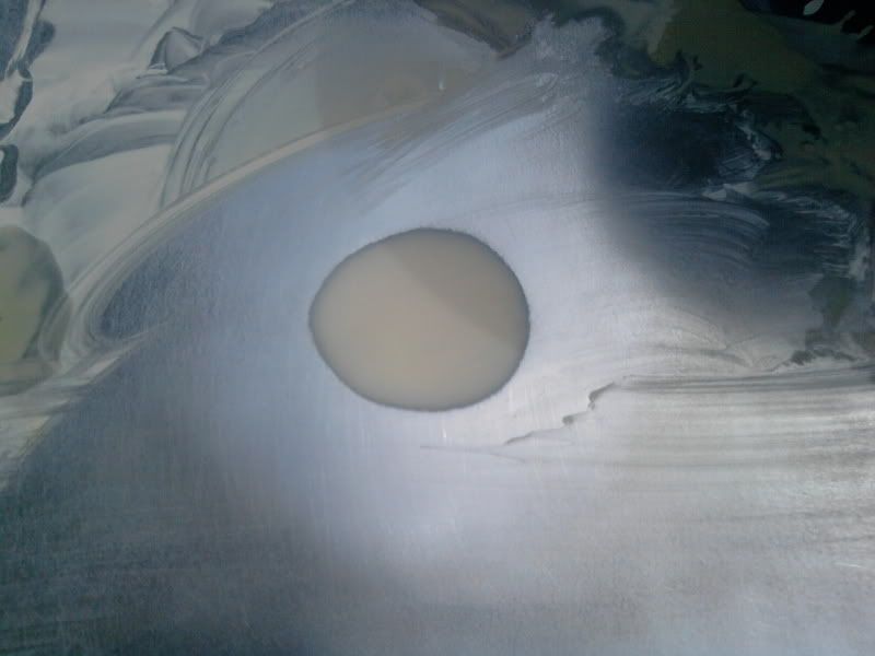

Now there were 3 bits of rust on the main surface of teh boot so I sanded them back as best i could then rust treated them. Then I used a ball pein hammer to dent the boot slightly and gave them all a skim of filler.
Then I put a coat of primer on it just to keep it protected a bit :D
And thats it for now.

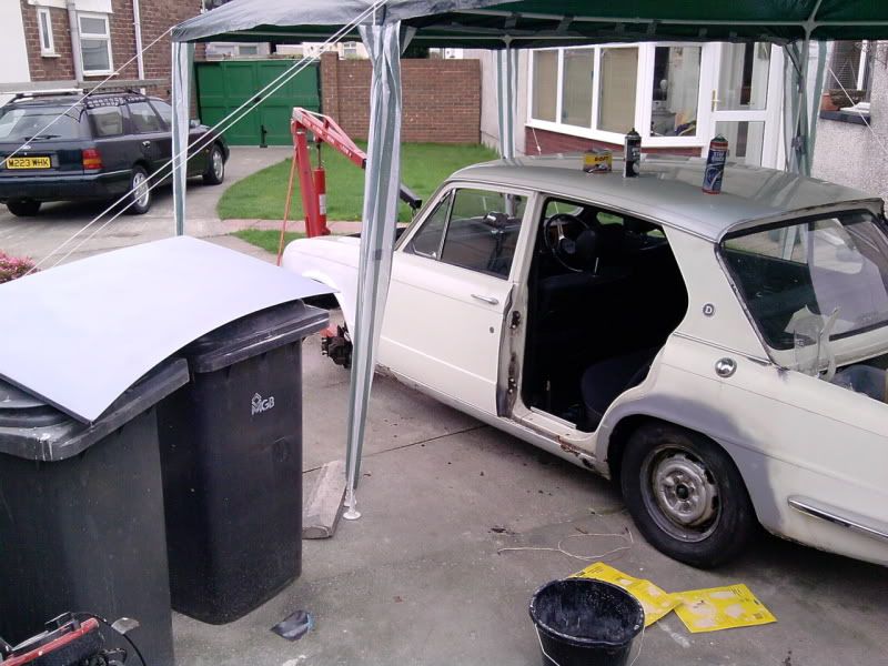

Oh and I got the back pasenger door off
Hopefully will update a bit more often again now :D

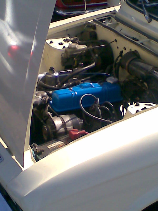

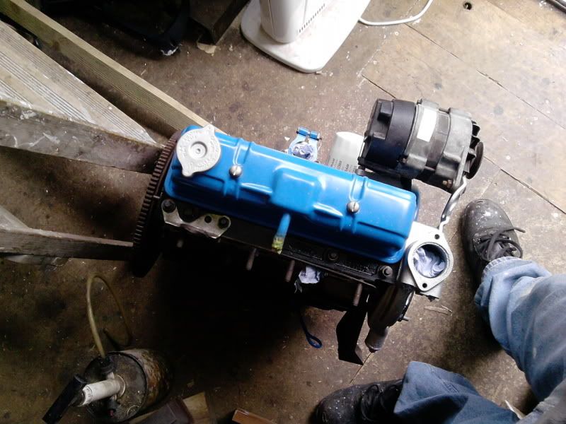

Oh and I nearly forgot to give you all a little teaser!!!
All nice and cosy waiting patiently to be fitted! 8)

Loving that engine, Rich.
Seeing that picture of your car sans rear door, reminded me of an SD1 that Jeremy clarkson once had :lol:

Looks ike you are doing a grand job there Richard. Might be nice if you invested in a Frosts lead loading kit for about £30 instead of using filler. Much longer lasting and tons of fun. Suprisingly easy to use tbh, just be careful if using power tools to sand it down.

whats that then ken? is it just meltd lead? id quite llike to try that!

Yes, basically that is what it is. Also known as body solder. Used for many years until the body filler goo turned up. You will need a powerful hot air gun or a butane gas type flame gun and a wad of old denim to wipe away the heated solder. Plumbers lead is what is used now. Easy and quite cheap. The kit is good value IMHO.
Go for it.

mmmm alloy pump body - nice! Have you got the full Canleys lightening walletectomy? F & R plates, alternator bracket, dissy pedestal? Colour me green if so. Shame the alloy pumps & bellhousing are such a heart attack.
Jod Clark
Posts: 2567
Location: Birmingham
Re: my little project
#44 Post by Jod Clark »
Tin, they're just the regular cast iron items, shotblasted and painted. Look a treat though don't they :)
