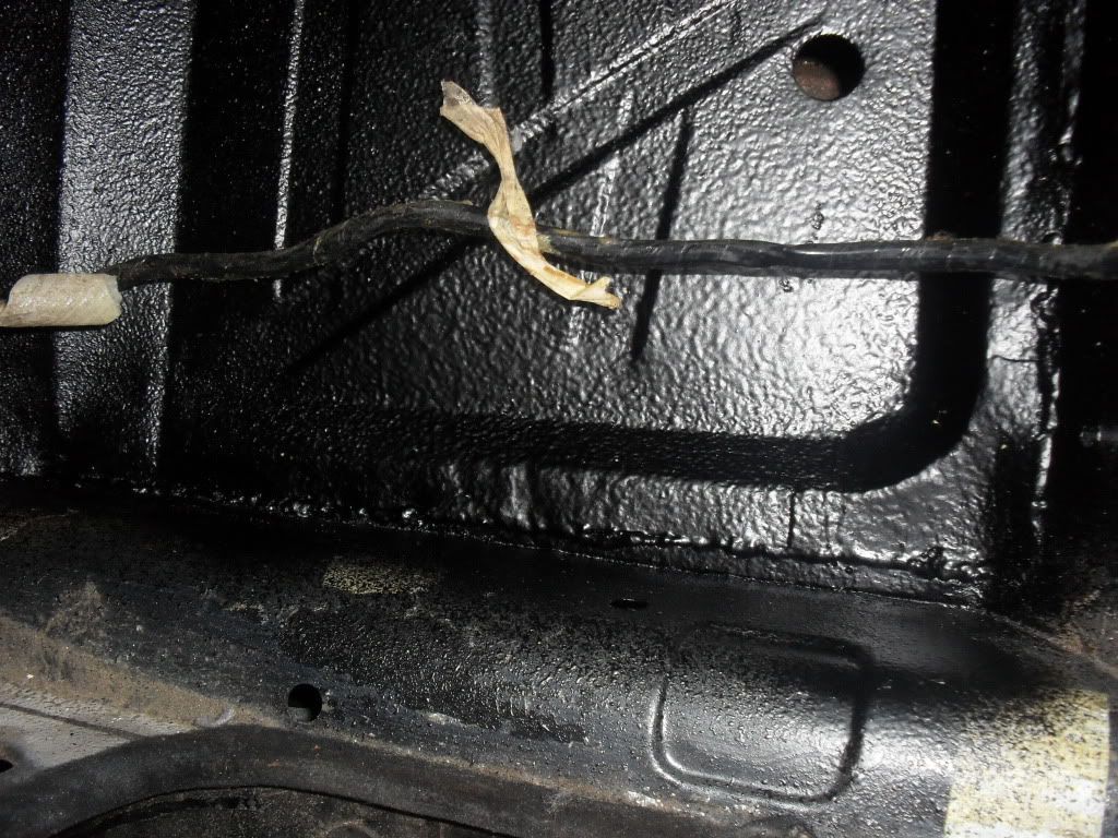

Got the car back home today after I'd been away working for a few days.

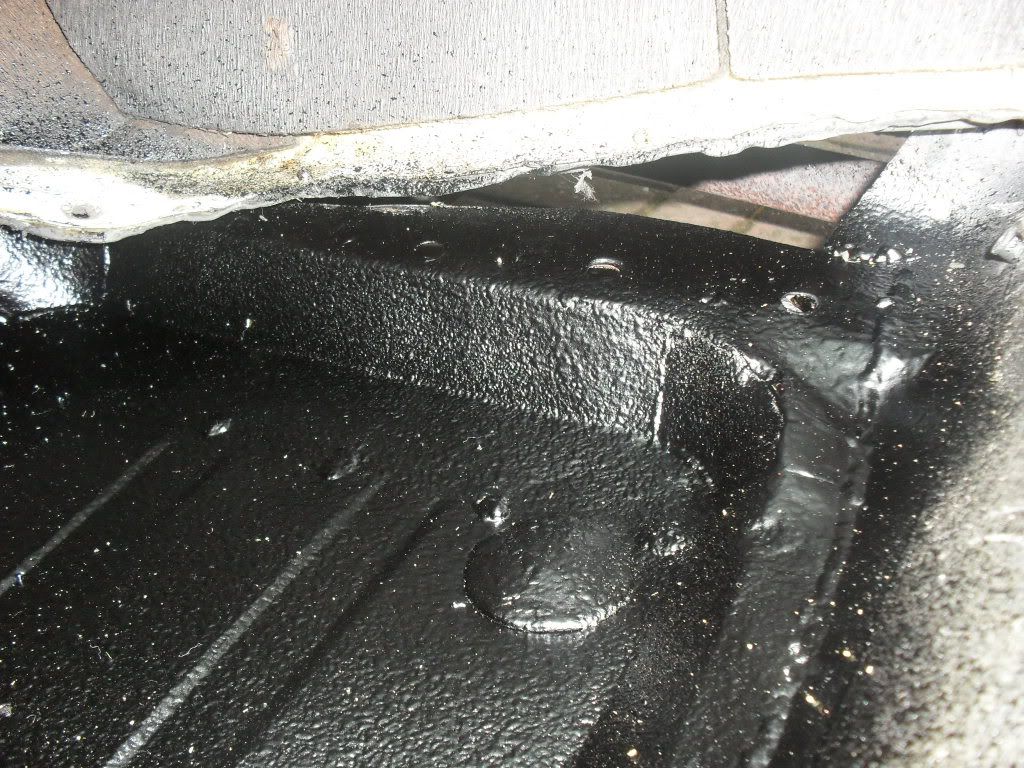

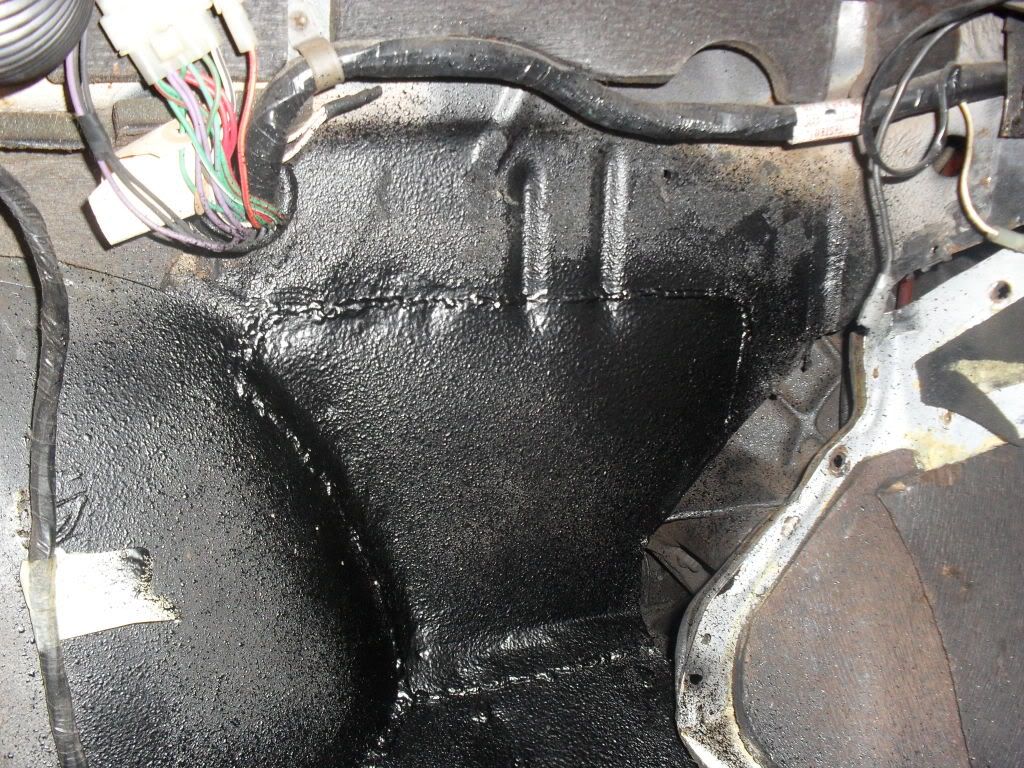

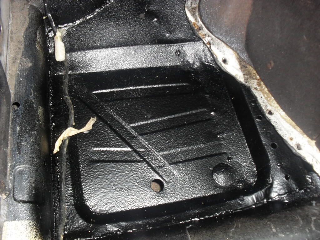

While I was away, the car had been to my friends to have the new footwell put in. As the car was on the ramp, the underside of the car was rustproofed again and the new centre exhaust section was fitted, leaving me to just find and fit a new rear section.
It is now up on axle stands so that we can now get on with removing and inspecting the ball joint and changing the front subframe rear bushes.
I think that the ball joints are ok but the rubbers have split. We will also change the brake pipes, as although they all appear to be fine, we have the new pipes and tools to do new ones.
I will have the old tyres removed from the rims on Monday so that I can repaint them before having the new tyres fitted. Would anyone recommend fitting wider tyres (175/70-13) instead of the standard 155-13.
The service items were changed today and the car ran really smoothly until it got warm, when it began to misfire on number 1. There is a very healthy spark at the plug so we will investigate this more soon. I haven't tried starting it again since it has cooled down. Will do again tomorrow.
If the head has to come off, then I will get the unleaded conversion done at the same time so it isn't really a major problem.

New nearside footwell in place
Bulkhead repair
Back home now..
And into the garage for the next round....
Bulkhead repair

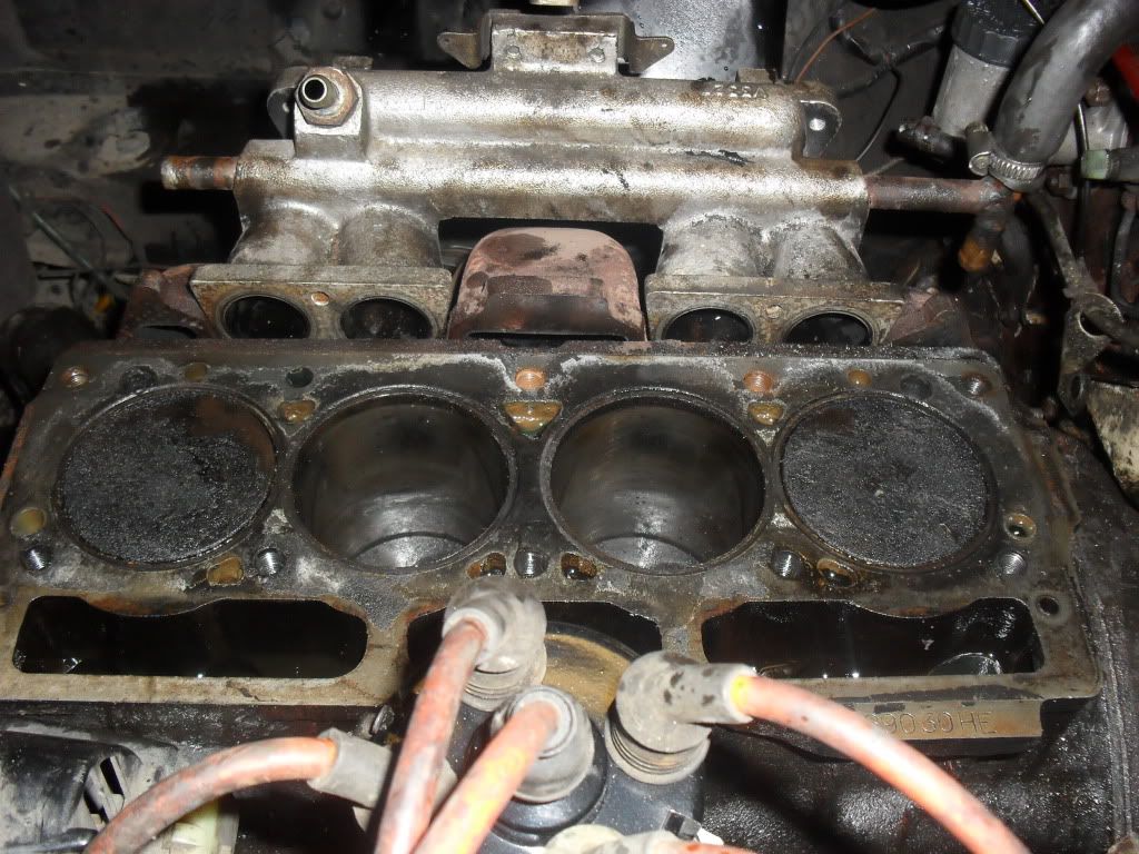

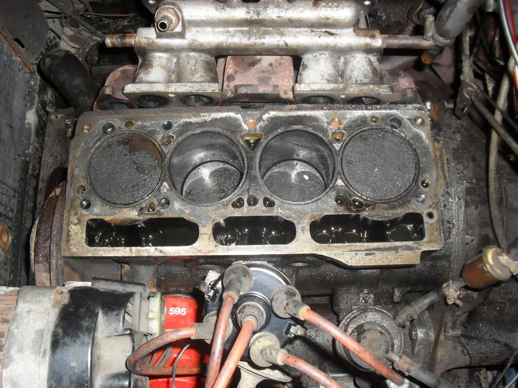

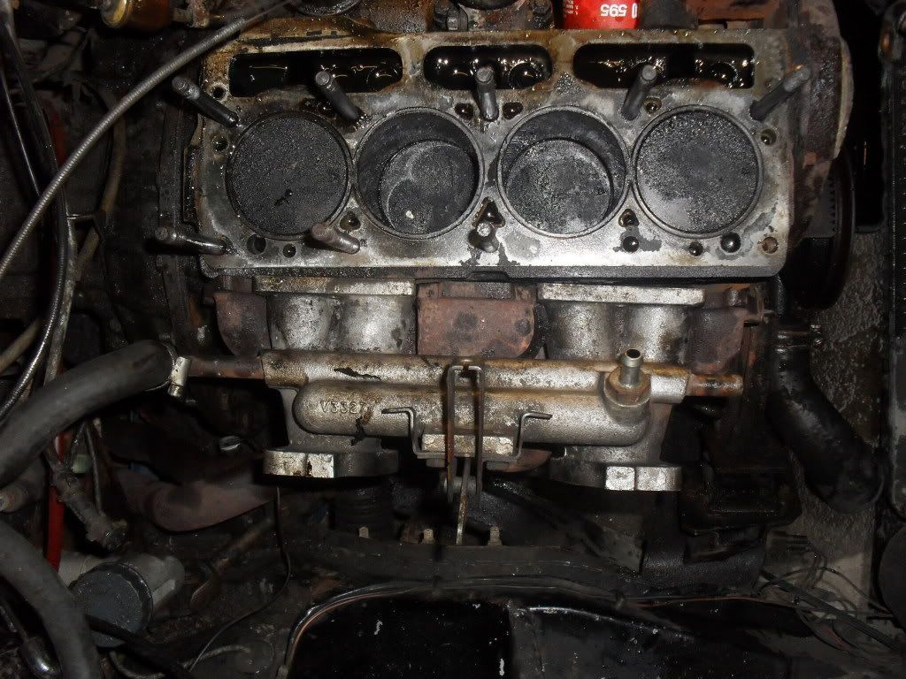

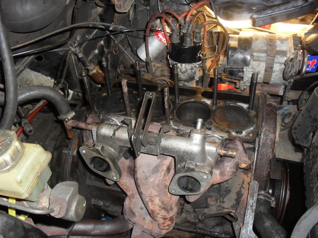

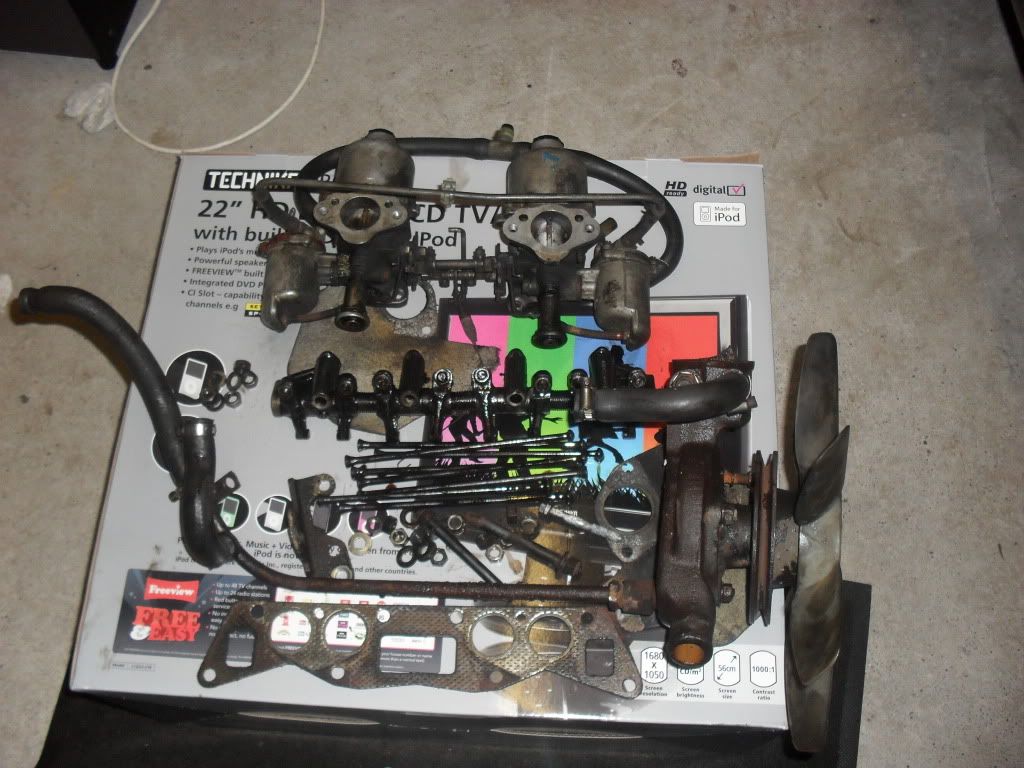

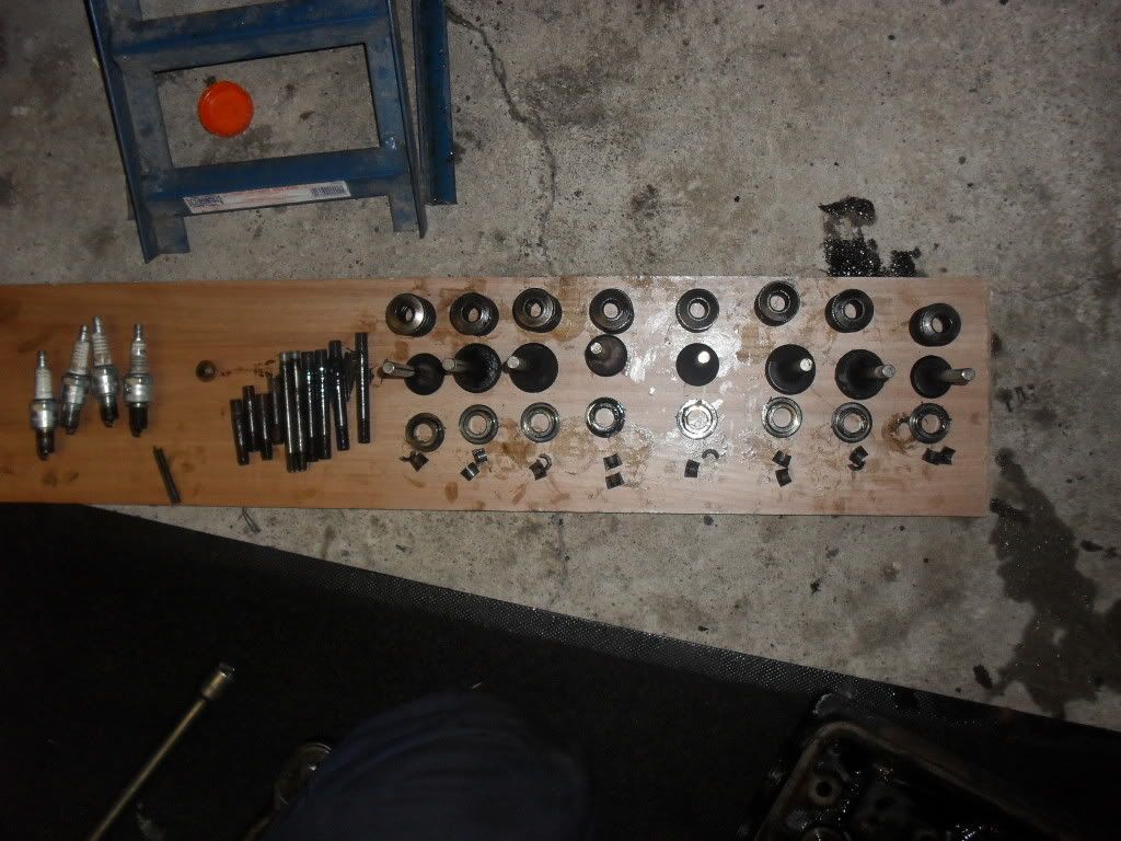

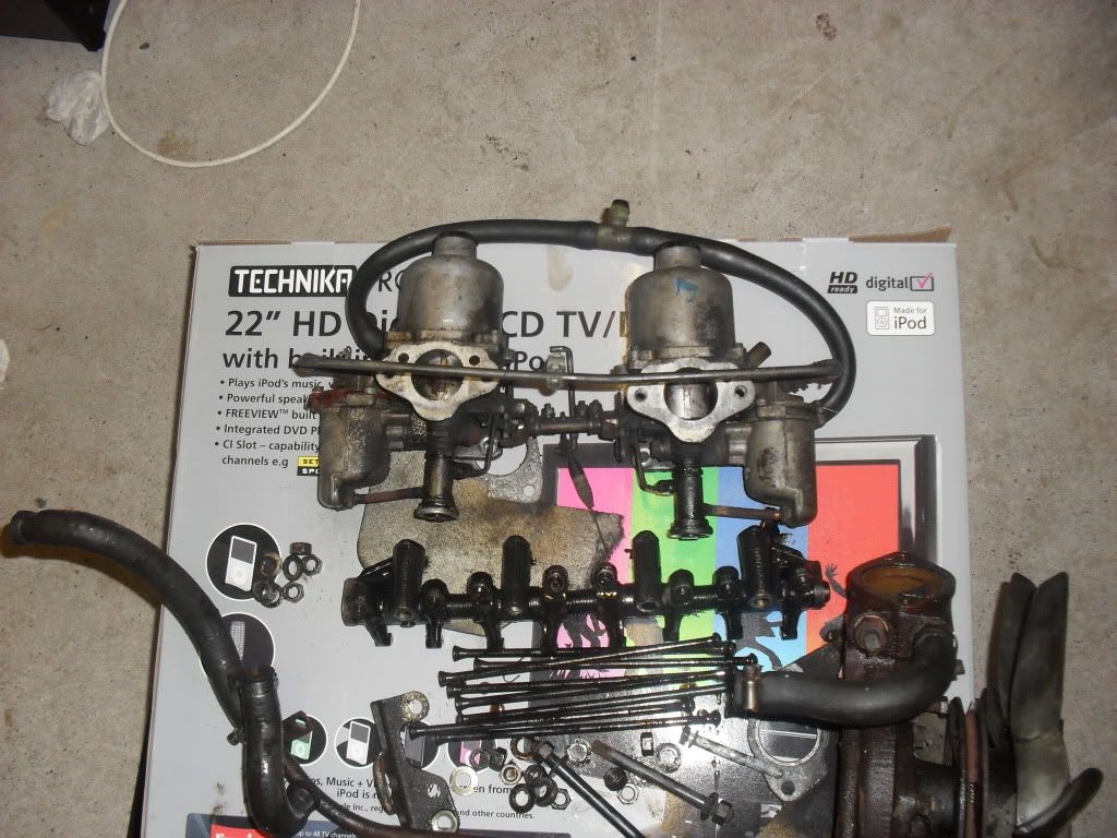

As per other thread on Dolomite related chat, we have had a problem with the recon head.
One of the pushrods keeps popping out. Have checked rocker gear, which is all ok so head has had to be removed again and returned to the builder for him to have a look at it. Most likely cause will be a sticking valve.
