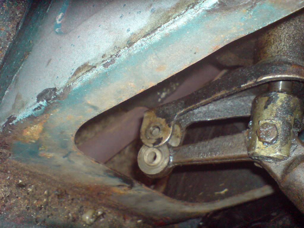

Anyhoo, I got a lump of this stuff and pushed it in to the hole at the end of the gearlever, whilst still hot i forced the bolt through the middle and waited a minute or two for it to harden. I wound the bolt out and trimmed the excess off with a craft knife. I now have a perfect moulded bush!
I'm using a steel washer to take up the slight side to movement of the gear lever - the picture shows the bush slightly proud of the hole just to show it.
