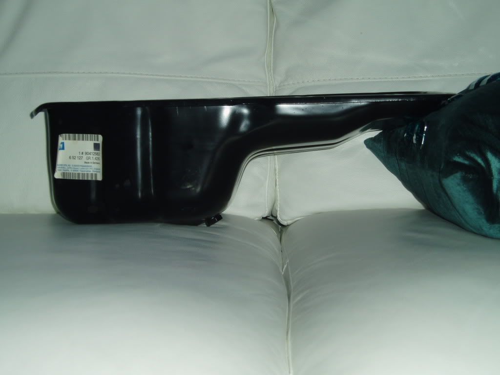

Anyway I think I may have solved the sump issue as you can see below. It's a real oddball sump for an 1800 omega sold in germany only. It's got the magic front bowl and the rear depth looks ok at 40mm one side extending to 55mm at the other. It seems to be for a 7 degree application perhaps.
It should clear the steering rack so i'll give it a go.
Seems a very rare part though. NLA from vauxhall and I got lucky on some carconexions website that supplied the part from a UK dealer at a reduced price!!!!!

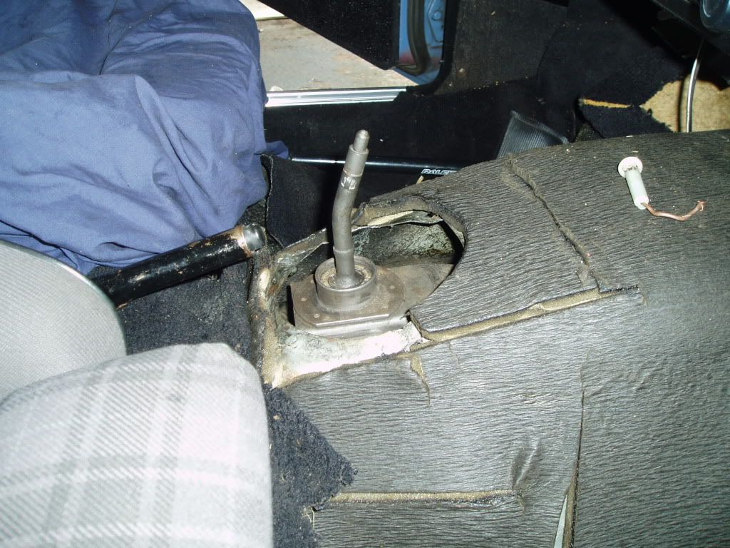

Now trial fitted the gearbox tunnel. Seems a snug fit. May take a little off the gear stick mount but happy with the location. I am having a bracket made up at work to connect the manta gearbox to the original sprint gearbox mount, it will also be adjustable to give some lateral and vertical adjustment so I can fit it exactly where it needs to sit.

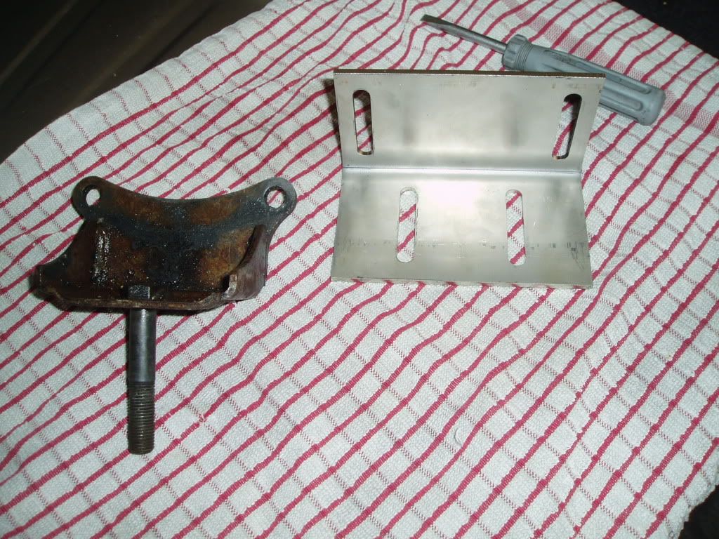

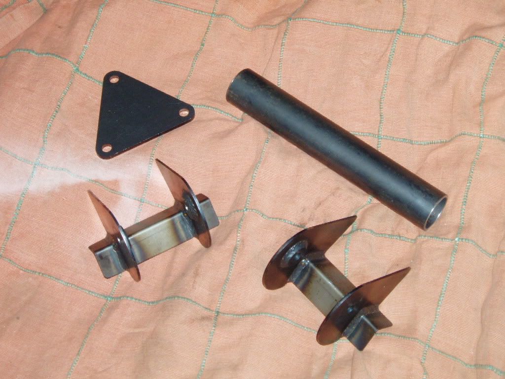

Gearbox mount adaptor plate now manufactured. This will allow the old sprint mount to fix to the getrag box.
I had it made in stainless 3mm plate with adjustment slots for height and fore and aft.
Sprint gearbox cross memberwill have to fitted back to front but this will just need the mounts slots in the body elongated to make fit.
Next job will be the engine mounts. I am going to chassis mount the engine with a universal mounting kit from SBDevelopments

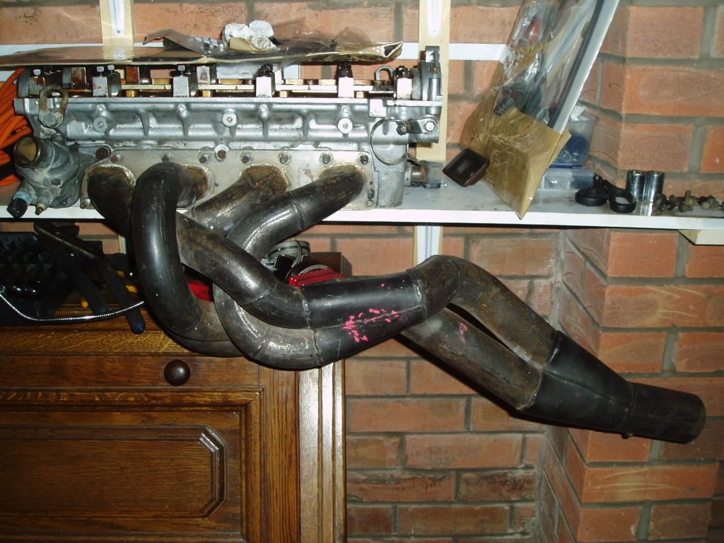

Yes I expect to have fun and games with the exhaust.
Plan is to fit the manifold as best I can and then make up a spool piece to join the 2.25 inch manifold to the existing 2 inch sprint sports exhaust system. I might even use a flexible piece to get it going

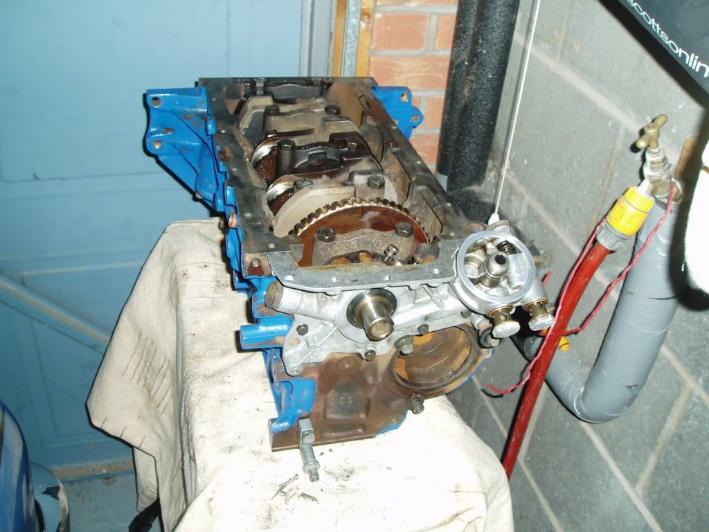

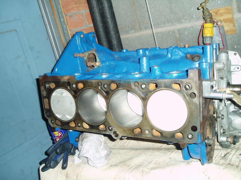

Pistons fitted - nice! Had to chamfer and deburr the conrod caps to accept the ARP bolts. Apparently this mod alone will allow the engine to safetly rev to 7750. Shocking.

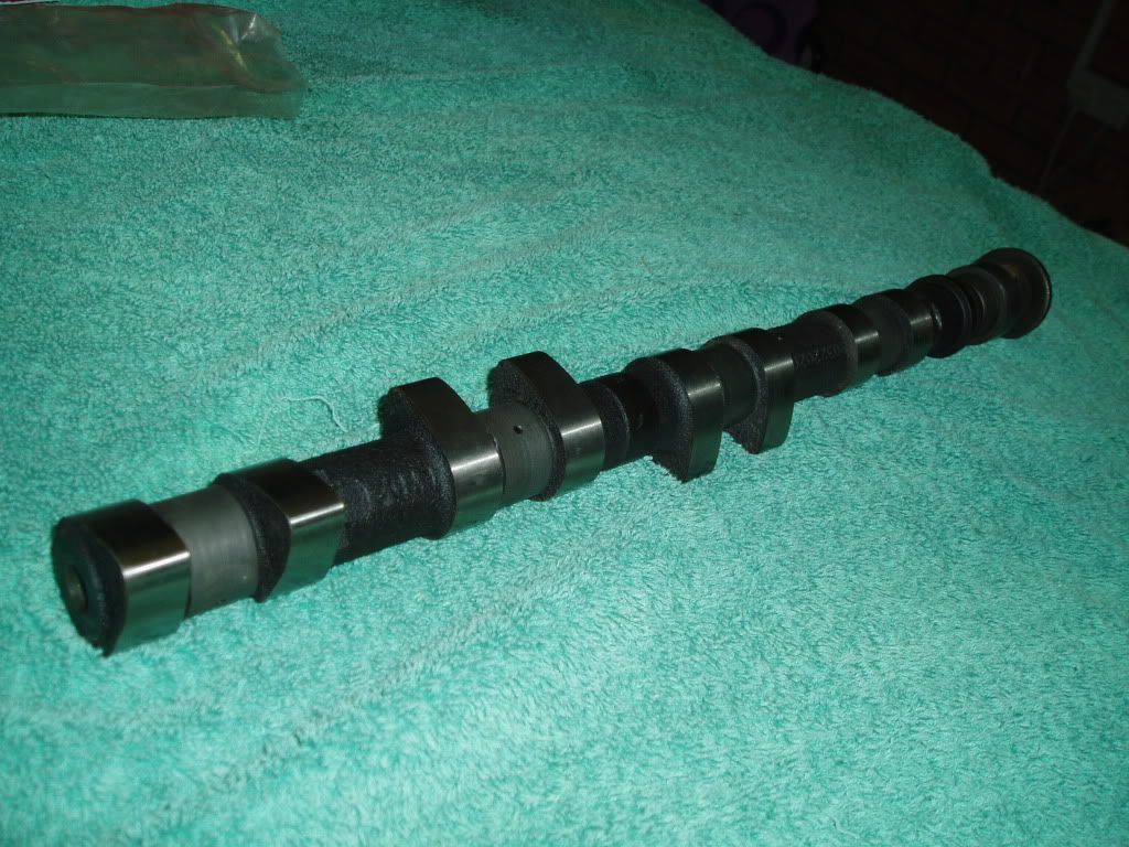

Sports camshaft 276 degree
Exhaust manifold trial fitted - needs work! It points into th ebulkhead at present.

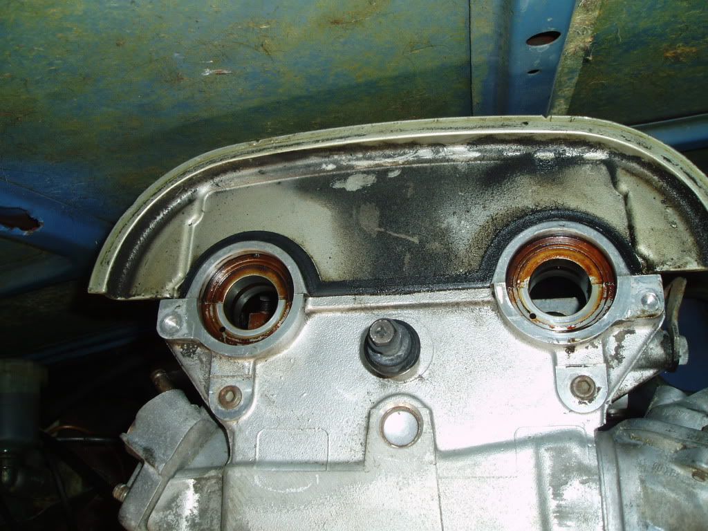

Moving onto the head now. Been reading up on a mod to cure the porous/cracked head problem on these. Seems a simple mod where you tap in a length of 8mm tube into the effected oilway. Valves just need lapping in so hopefully in a couple of weeks the engin will be more or less complete.
