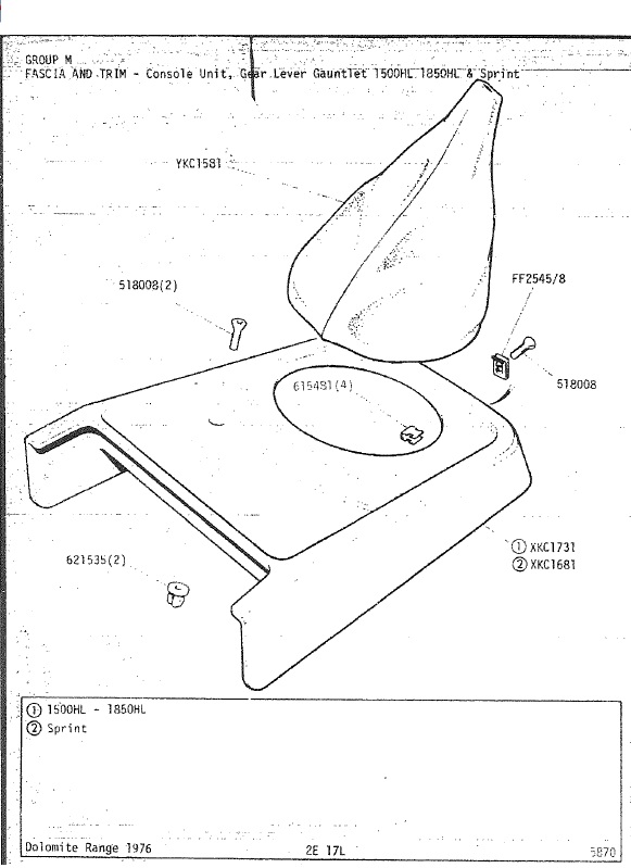

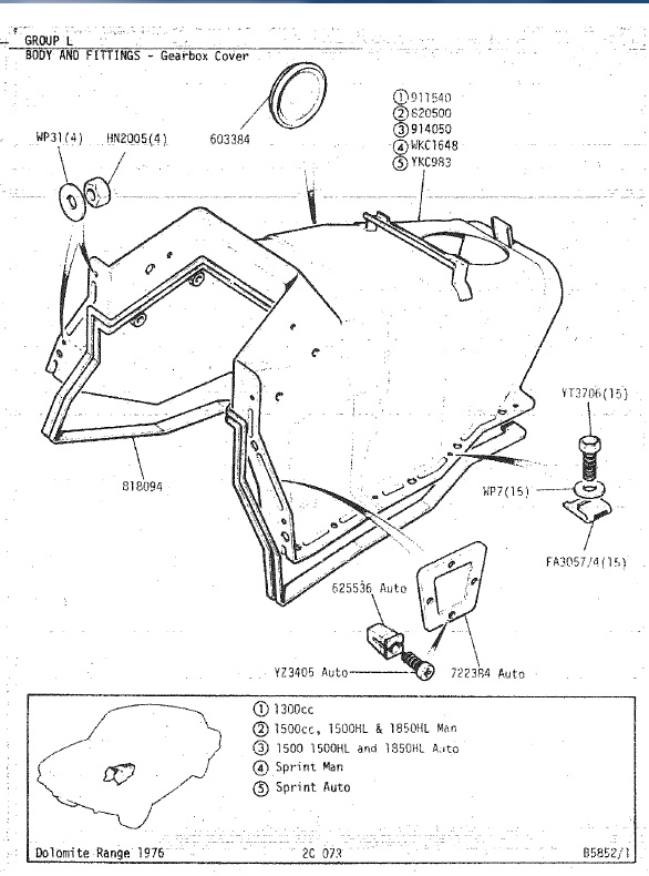

Hi ,
i met some of your members last week at stoneleigh and registered the TDC
i swapped my auto gearbox this winter ( noise in the torque converter ), for a 1850 OD one
i already have a good OD gearbox checked , but still need all the parts set to cover the gearbox
-cover 820500
-console unit XKC 1731
-vynile "gauntlet" on the lever
if anybody can sale these specific parts (sprint parts doesn't fit for 1850 gearbox) to france , please PM

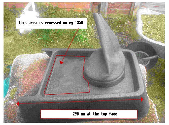

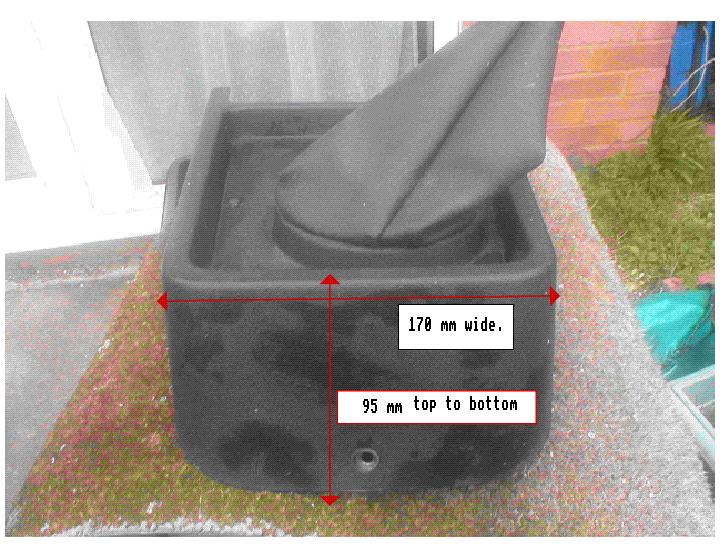

I found this in my box of bits from years ago. I've measured it up and annotated some dimensions. I have also compared it with the one fixed in SWK which now has a single rail 1850 gearbox, but originally had that funny experimental CVT transmission installed. Something I realised was that the one installed slopes down at an angle of 30 degrees because the rear face is much shorter top to bottom. If this one in the photo was fitted the coin tray part would be close to horizontal.
So is this an 1850 single rail part ? If so and if Jonners can't find one it would be spare.

Re: Froggy Dolly
Hello
here are samples of the part list
it doesn't make difference between "early or late 1850" in 1976
was single rail gearbox already in production this year ?

Re: Froggy Dolly
Tony has posted a lovely picture of an early 3 rail tray....
The single rail is much shallower at the back edge....
This I think is how it works....you can use a single rail tunnel on a 3 raiil car but a 3 rail tunnel will probably foul the gearchange remote.
So you need a single rail tunnel to cover all the bases...
Mine (spare) is a 3 rail sadly....

Re: Froggy Dolly
Thanks for that Jon ! Your knowledge is encyclopedic. So for what Laurent wants could he carefully cut this down to be the shorter single rail coin-tray if we supplied dimensions ? Or is it not that simple ? This one came from MPD my very early Stromberg powered 1850 from 1973 I remember now.
