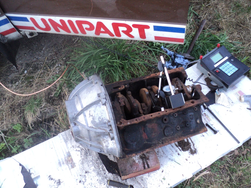

Hans, the next thing:
Tonight i was driving home and had a think about it. I can dig up in Oom Wims garden an engineblock with a cranck in it. I know there are a few hiding in the grass somewhere.
When i fit a flywheel and clutch to it, an 1850 bellhouse with clutch hydrolics and a magnetic stand and micro dail gauge, i can do some measurements.
When i take out the axial bearings and fit one loose between the cranck and the middle mainbearingcap i could measure if the cap is moving when declutch. At my work we have a portable pressure device to measure the pedal force as for the MOT you have to push the brake pedal at 700n to see if there are any leaks in a brake system. I can measure what the max pedal pressure is when the clutch diafragma spring is flipping over and see if the cap moves. If it doesn't move, i can take out the clutch and flywheel and fit a longer release bearing sleeve of a sprint, extra lenght because of the sprint's engine/gearbox adapter.
Then i can push directly on the cranckshaft and see when the cap starts moving and see how much pedal force it is. If it's close to a cluch cover spring force or way more. If it's way more when the cap starts moving, there's no need to worry i think. If the cap doesn't move at all it's even possible to do a test with the cap torqued down at half torque and see what happens. It is feasable to have a setup fixed and use my dolomite as test car, only have to fit a new pipe from the clutch master to outside the car to the setup. This test should be a representation of a real situation and the results should be usefull in the futere i think. Or is this setup showing nothing????

Tonight made a set up. Found a rusty old engine with cranck in the garden with my metal detector. Fitted a backplate and isolated a bellhousing from a gearbox with working :shock: clutch slave cylinder. When i have time and the wish tomorrow i will have a testrun and add some pictures this week and publice the results.
Hope you all can sleep tonight.
Re: Start of new project.
#41 Post by soe8m »

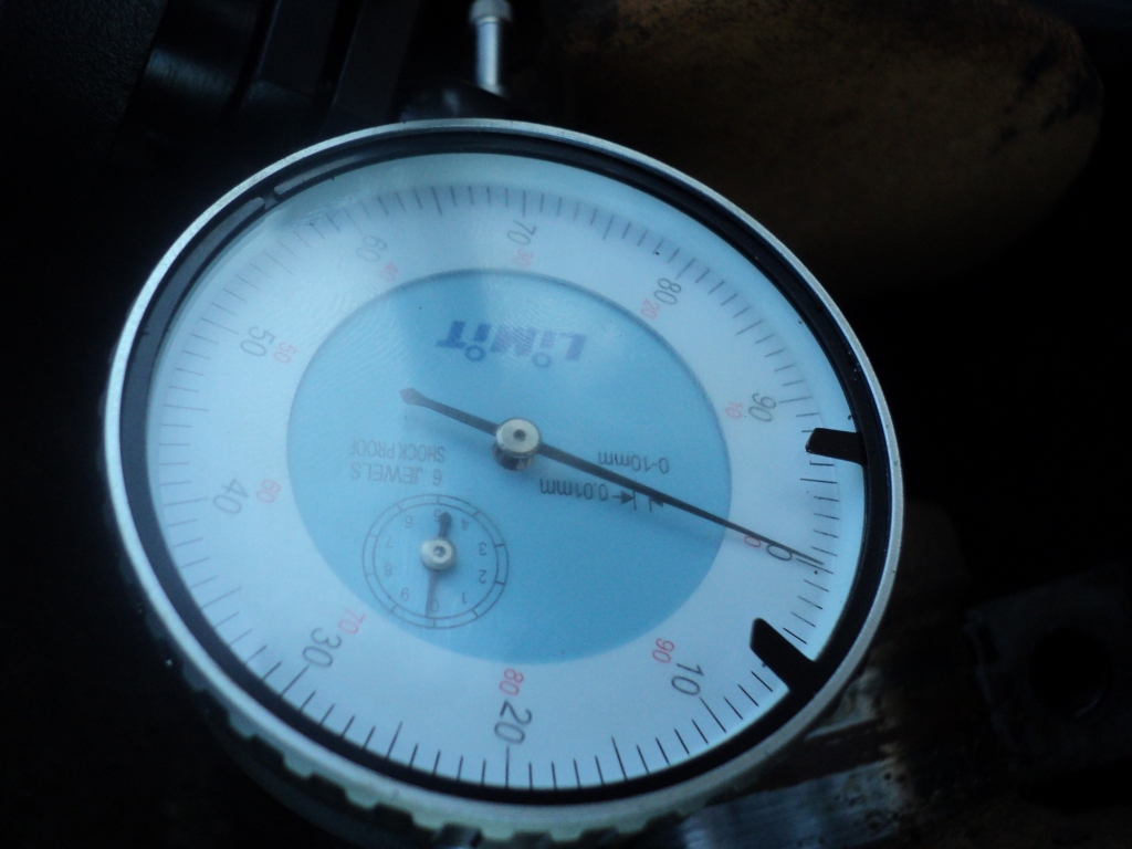

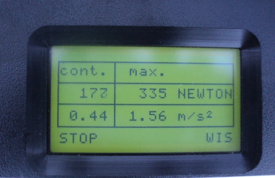

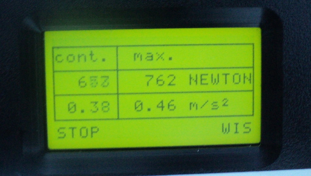

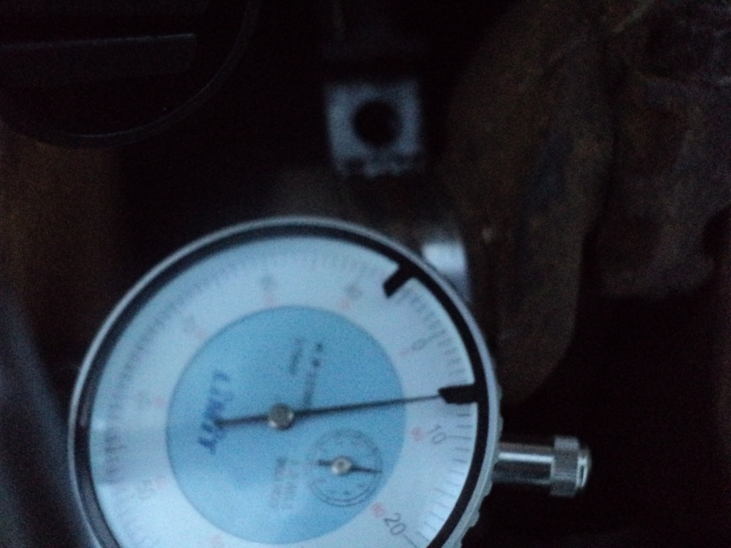

Ok tested and all fine. Main bearing cap does not move when declutch.
Made the setup and the cranckshaft was moving freely. I took out the axial bearings and had a feelergauge between the cranckshaft and main bearing cap. This to have all the pressure at the top of the bearing cap. In real situ the force is going to be equally devided on the total cap area but i thought to test on the most weak spot and to have the most momentum as possible to have a max extreme test effect. When declutch the max pedal force is about 300N average at different tests and to hold the clutch a force of 180N is needed. Hurray for the diafragma clutch.
There was zero movement of the cap.
When taking off the clutch/flywheel and replaced the releasebearing by a sprint one i could have the force directly at the cranckshaft. At 200N pedalforce the gauge began to move. At about 700N there was a movement of the cap of 0,06mm. The max movement to achieve was 0,10mm.
There wasn't time enough to measure the real forces on the cranckshaft because it was getting dark.
I'm going to proceed the mod because the cap will never move when the total axial force is at the original bearing and the new upper one. As the bearing cap isn't pushed away the bearing is going to work as an actual extra axial bearing.
#42 Post by soe8m »
zero movement.JPG (384.08 KiB) Viewed 5358 times
cranck direct.JPG (218.52 KiB) Viewed 5358 times
0.06 movement.JPG (395.96 KiB) Viewed 5357 times

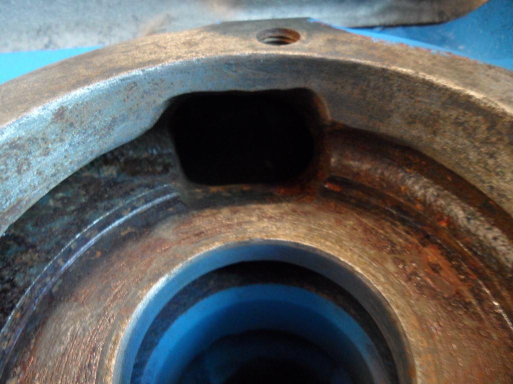

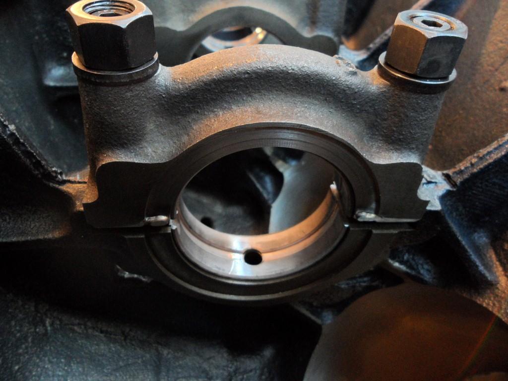

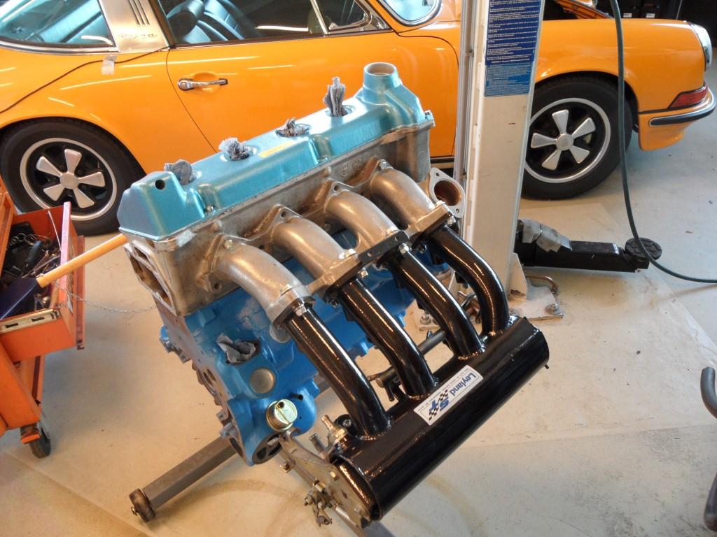

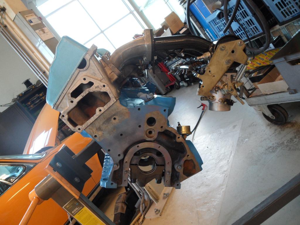

Here a pic of the middle main cap. It's machined exactly so the same size bearings can be used as upper and lower. The slots are not very high tech. My machine shop adviced to have locating pins in it but i do not like drilling in the cap near the mounting holes or have some loose pins in the bearingcap. So a low temp weld was the solution. No distortion or weakening but very functional but it looks a bit flintstones.
The other pictures are from try fitting. I have to make some brackets to hav it pasivated with some more stuff. Waterhole pic is for Zombeh.
