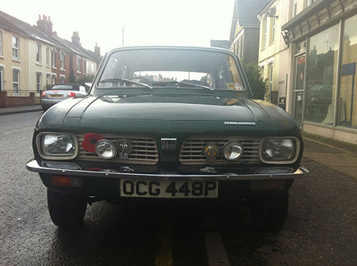

Just given Maggie an oil change, a new oil filter, replacement radiator hoses (thanks DazasDolly for the bottom one and the heater hose - also replaced). Filled to the brim with new coolant, air filter cleaned, and then wash 'n' waxed at the local Tesco.
Seems like as good a time as any to post some pics of her.

She's actually in Racing Green - the pics weren't taken in the best light conditions :D
