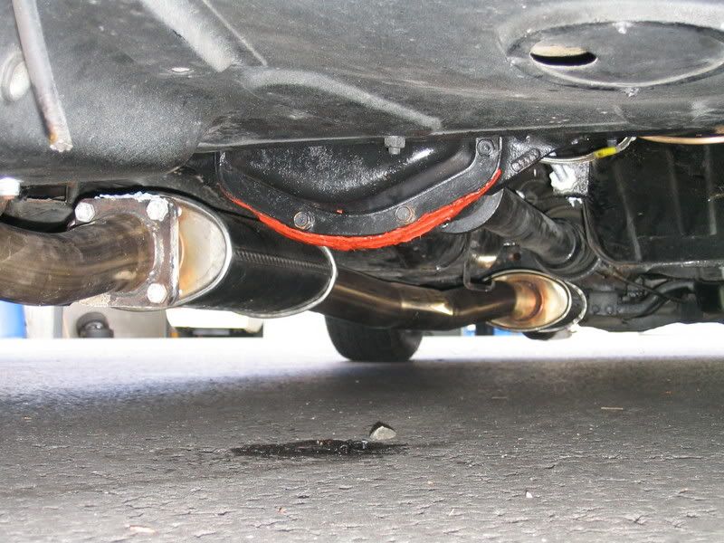

Bob Kett's race Sprint has 2 exhaust boxes under the car. Front one in approx normal position. Rear one forward of axle. Then a pipe under the axle and exiting under the boot. It looks much better than the back box under the boot.
That's quite similar to mine, except I have a pipe over the axle - partly due to the terrain around where I live :lol:
Did have to buy an appropriate mount to support the cross-axle pipe though, to stop it bouncing and overloading the mount in front of the axle. I have just a single large diameter silencer in the middle of the system.
Works quite well but I still wonder about exhaust gases coming into the cabin when stationary..........

Pictures taken at Top Hat meeting Donington 2006. Bob Kett's car.

#34 Post by Lewis »
That's a real neat install, like it a lot. >Saves photos for reference< 8)
Mine is different then, mine ends just behind the rear wheel :lol:

#35 Post by Mad Mart »
Hmmmmm! no rear ARB!!!!!!

#36 Post by MarkVeryard »
Huh? :? So what happens when you go over a jump or jack the car up?

#37 Post by DavePoth »
Jack it up at the axle, and don't drive over bumps, I reckon. Not exactly practical for road use though.

#38 Post by Lewis »
I'm guessing there's enough clearance to permit the axle to drop, or if not, because it's racing it's not required - as they're on smoother surfaces.
Jacking, well, I don't know about the others but I alway use the diff as the jacking point....you're pushing the axle into the car so again I suspect it's a non-problem, or again, if they do jack it on a side there is enough clearance to let the axle move about or drop.

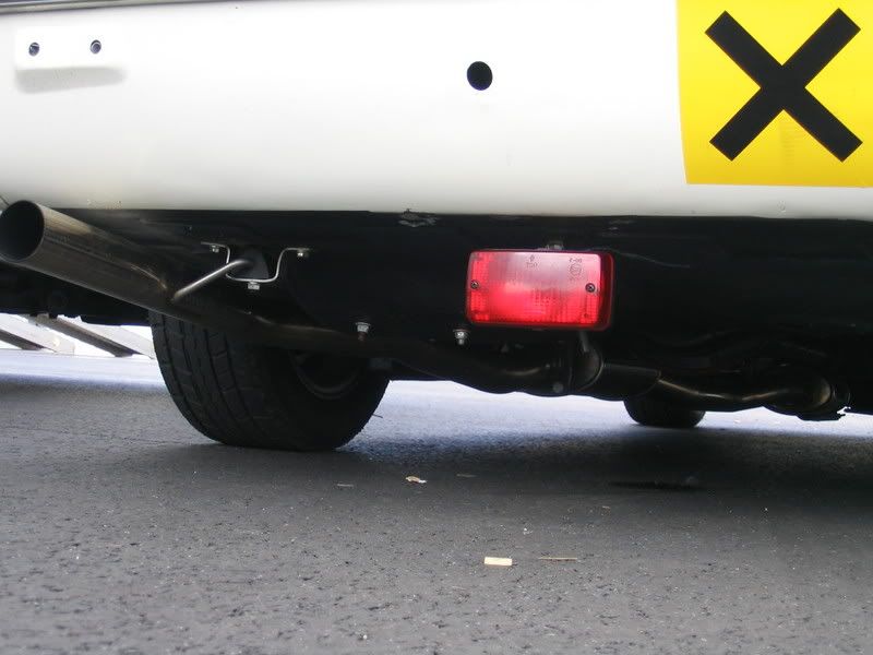

#39 Post by Karlos »
2F45T4U, what happens to that side exit exhaust when you drive up a kerb of more than 4" in height?
Does it have a hinge in it :lol: ?

#40 Post by 2F45T4U »
That side exit is history :)
Have a rear exit which goes under the back axle now. Works well :D

#41 Post by george »
mk11 jags used to go under the axle so long as theres enough clearance you should have no issues

#42 Post by 2F45T4U »
There is no issues :D
Going to sort out the tail piece soon :D
