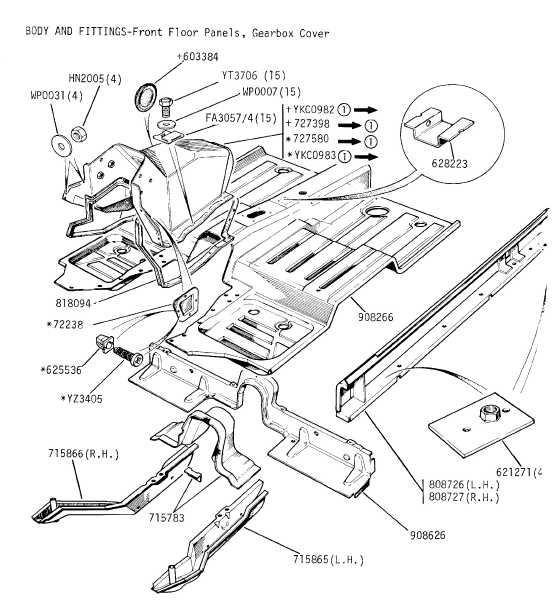

See this post for the captive nuts:-
viewtopic.php?f=4&t=28579
621271 - plate reinforcement floor
