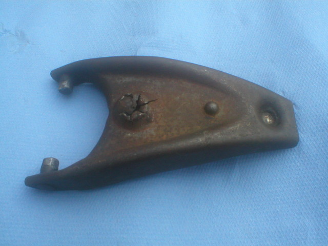

A common problem on the 1850 is the failure of the clutch fork pivot point . But yes, check the hydraulics first. Its cheaper and easier. Just to give an idea, my 1850 has 7/8 in of movement at the slave cylinder push rod. If that measures O.K. on yours it is probably the clutch fork. I think the part is compatible with the Vitesse.Karlos wrote:I
Now for the other problems, the clutch pedal is doing nothing for about 60% of its travel. Gears are crunching all the time so it seems like the slave cylinder is past it.
How is the starter problem ?
- 1850 broke clutch fork.JPG (67.88 KiB) Viewed 4225 times

Really interesting that ^ wasn't previously aware, good to bear in mind

Hi Tony, thanks for the heads-up on the weak spot of the clutch fork pivot point. I'll check again on how far the push rod extends when the pedal is pressed. Not had much chance with the starter problems as I haven't driven anywhere other than up and down the road twice.
