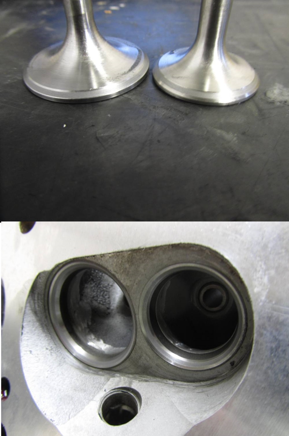

Finished the head tonight. Made some dowels on the inlet side and m10 helicoils on the outlet side. I'm using m10 studs with copper locknuts on the manifold. This way you can tighten and retighten the manifold easy without the threads damaged in the alu head.
Valves do not need to be lapped when they are new or machined and put in new or machined seats. But you can lap them to check the contact area of the valve. For LPG i use a slightly bigger area because of the better valve cooling. LPG burns hotter and this way the valve can dispense the heat more.

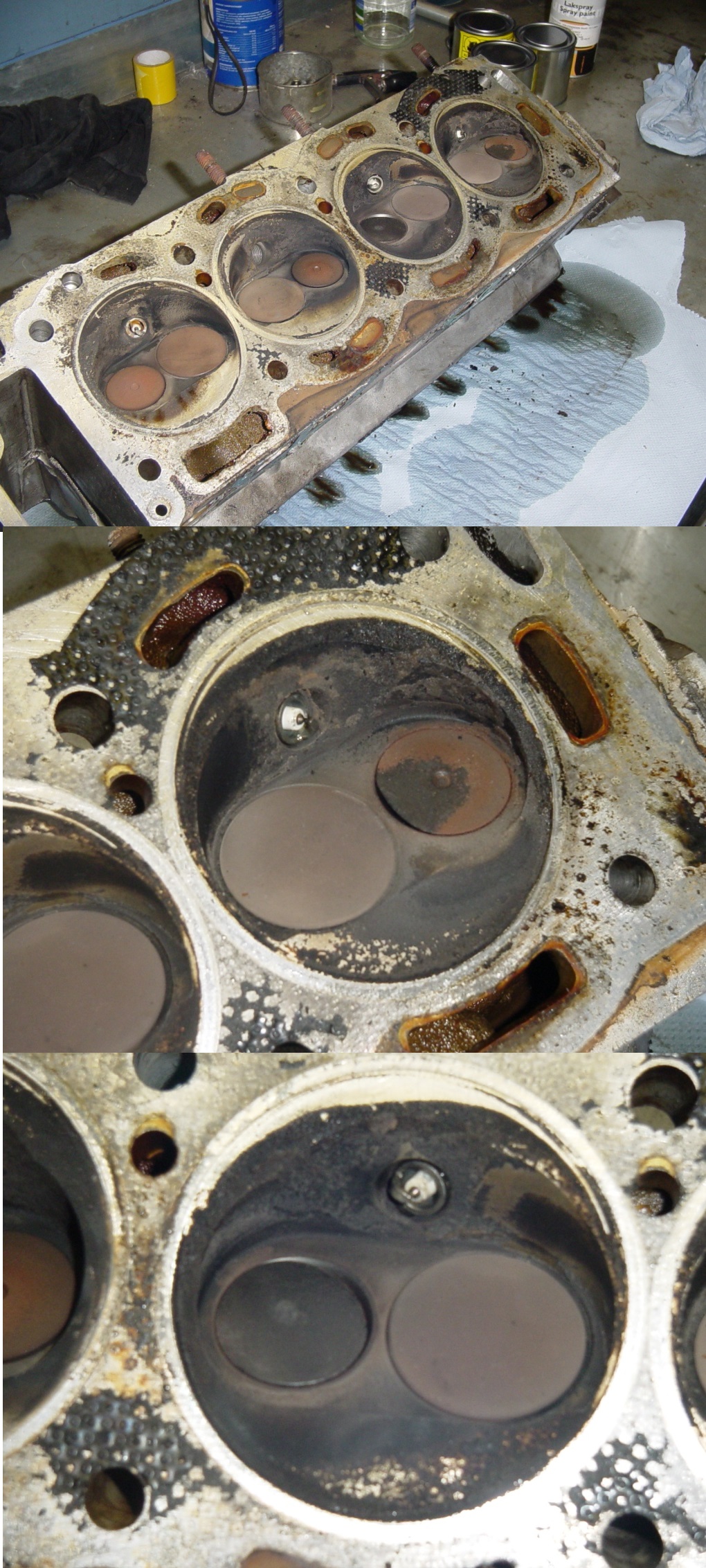

These pics are of the original head of this engine. This was the LPG injected head after about 300.000km. I did run it for a while on 3 cilinders but at once it was within 20km 2, 1, none.

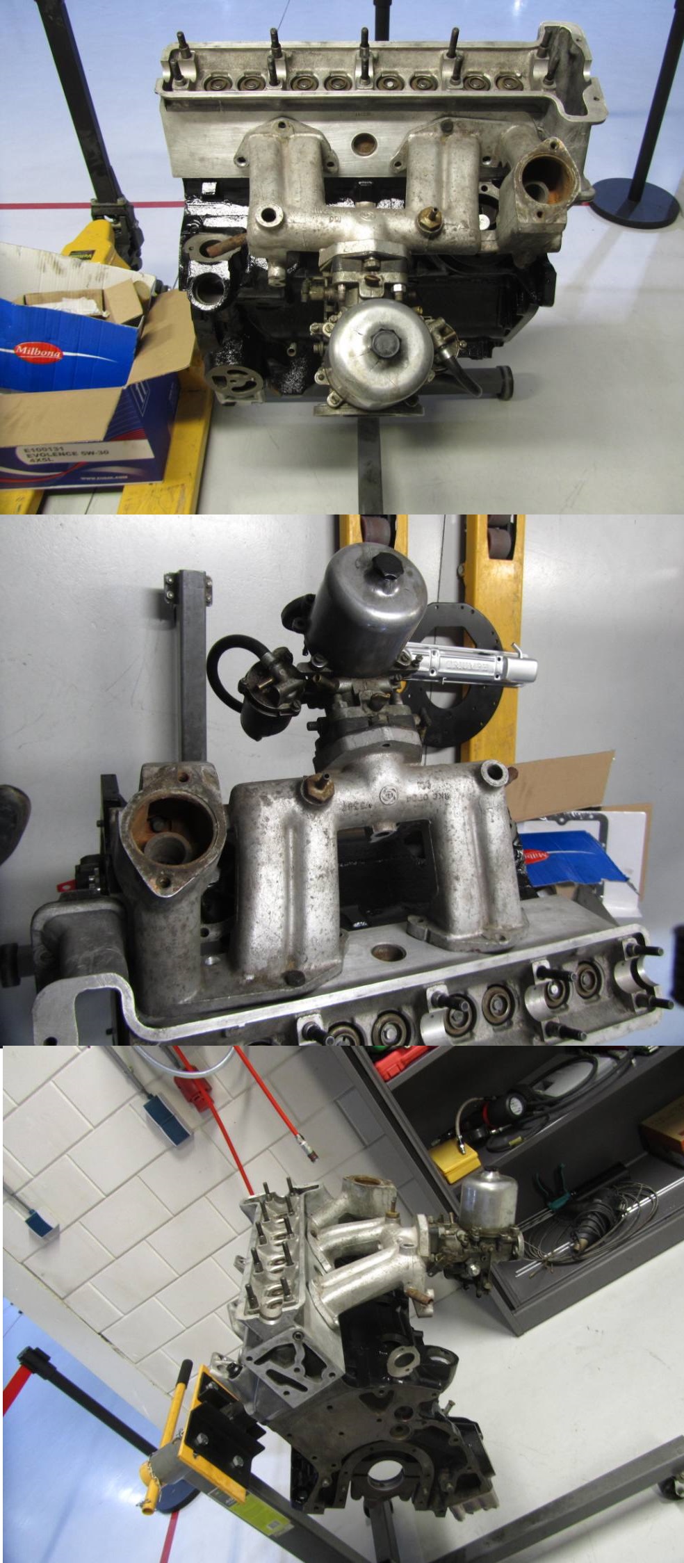

I de-tr7nized the manifold because i do not have egr.
I have to get used by the sight of one carb on a slant. This is a HS8 carb. The tr7 had originally a stromberg fitted.

Jeroen, is that rubber between the carb and the manifold?
Re: Start of another new project
#39 Post by soe8m »
It is tryfitting. There are no pistons in the engine yet. I did order a club alloy one. This is the std rubber one for the hs6 type.

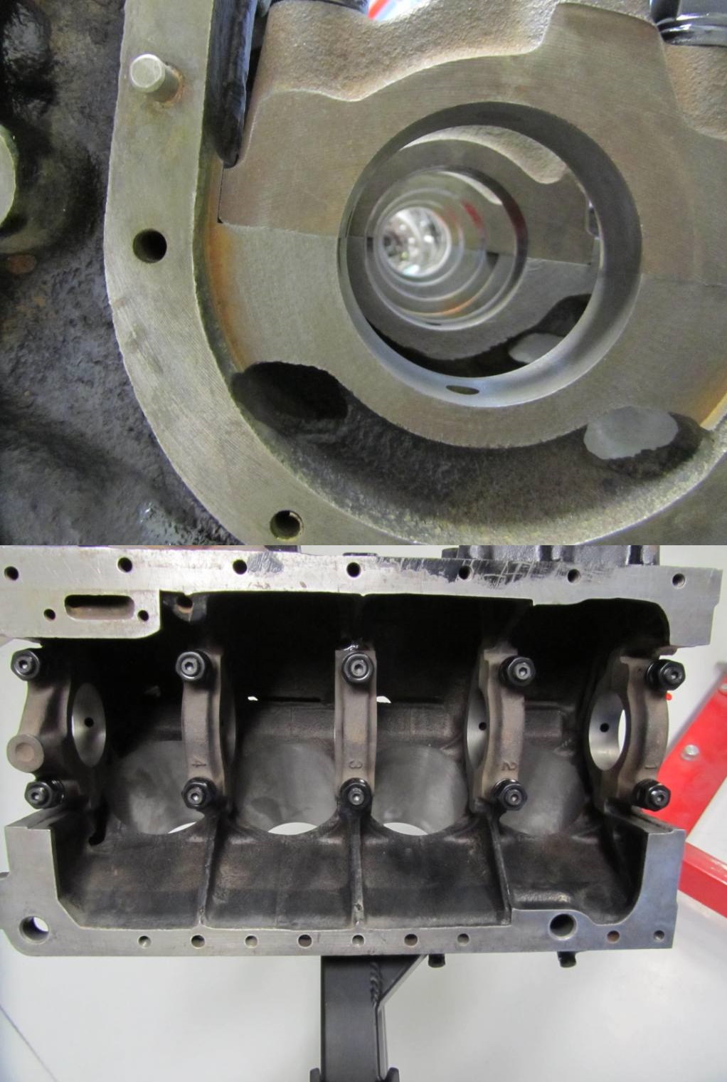

#43 Post by soe8m »
Fitting the ARP main bearing studs. Not all engines but a few have the bearingcap bolt bores not inline with the threaded hole in the engineblock. Using original bolts which are a bit thinner and have still a threaded in the lower area of the cap all is well but the ARP studs are slightly thicker and have a non threaded part in the lower area of the bearingcap is does matter.
Cap number 4 and 5 you had to tap with a plastic hammer to fit, the rest did just slide over. In the picture you can see that the bore on one side is not inline and that there is a marginal gap between the side of the cap and the engineblock. The cap is on one side pushed to the inside. If the cranckshaft was fitted in this engine it would not have turned by hand. The same happenend at the other (blue) sprint engine of the "new project". From then by every engine i do drill the holes of all the caps 0,5mm bigger and the problem is solved. All the caps because the ones who feel ok you cannot check if the stud is free in the hole or is slightly toughing the edge.
When fitting the studs permanently i do loctite them. There's no need but i have a better feeling glueing them. I use studs because the holes where the caps are bolted in are a weak point of a slant four so studs are much better and less stress when tightening the caps. But filling the threads with locktite also can't harm. When installing the studs with loctite you have to fit the cap and tighten it direcly. You want to have the thread coils toughing and the loctite filling up the non toughing gaps. Otherwise it can happen when tightening there's loctite between the stresses thread coils of the stud and engineblock and that is not a good fit.
